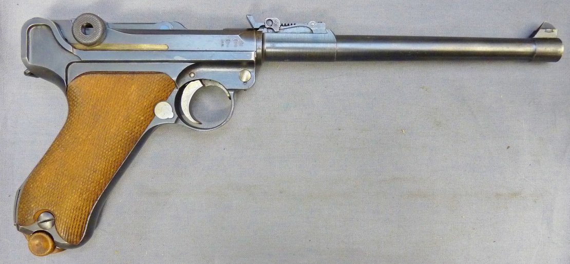

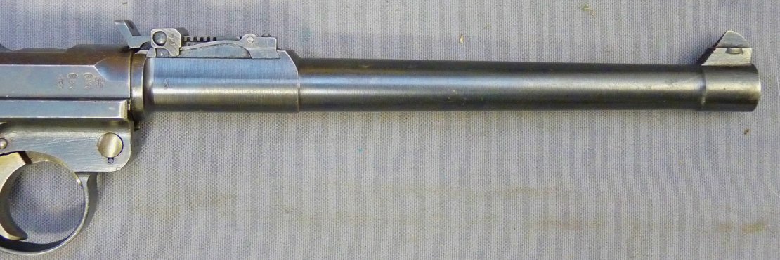

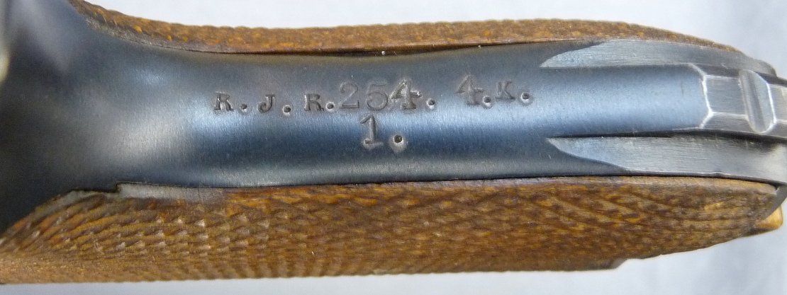

New to me is this non-fine tune sight variety of the L P08, also with markings to the 254th Reserve Infantry Regiment.
There are four combinations of sight configuration found in the Artillery lugers, all four can be found in/on 1917 dated pistols.
Of the 1917 Artillery Lugers reported in Still's Central Powers Pistols,
the sight combinations are lettered for identity and % of each is shown:
A-Both fine tune: 46%
B-Fine tune rear, fixed front: 38%
C-Neither fine tune: 10%
D-Non fine tune rear, fine tune front: 6%
In 1918, most pistols are found with both non fine tune sights-C type, with some 17% reported with fine tune rear and fixed front sight B type.
I would like to find a 1917 in configuration D and a 1918 in B!
If you have or spot one please let me know.

This pistol is marked to the 4th company and is weapon #1.

This pistol is in fine condition, matching except replacement beech grips and mis-matched beech base magazine.

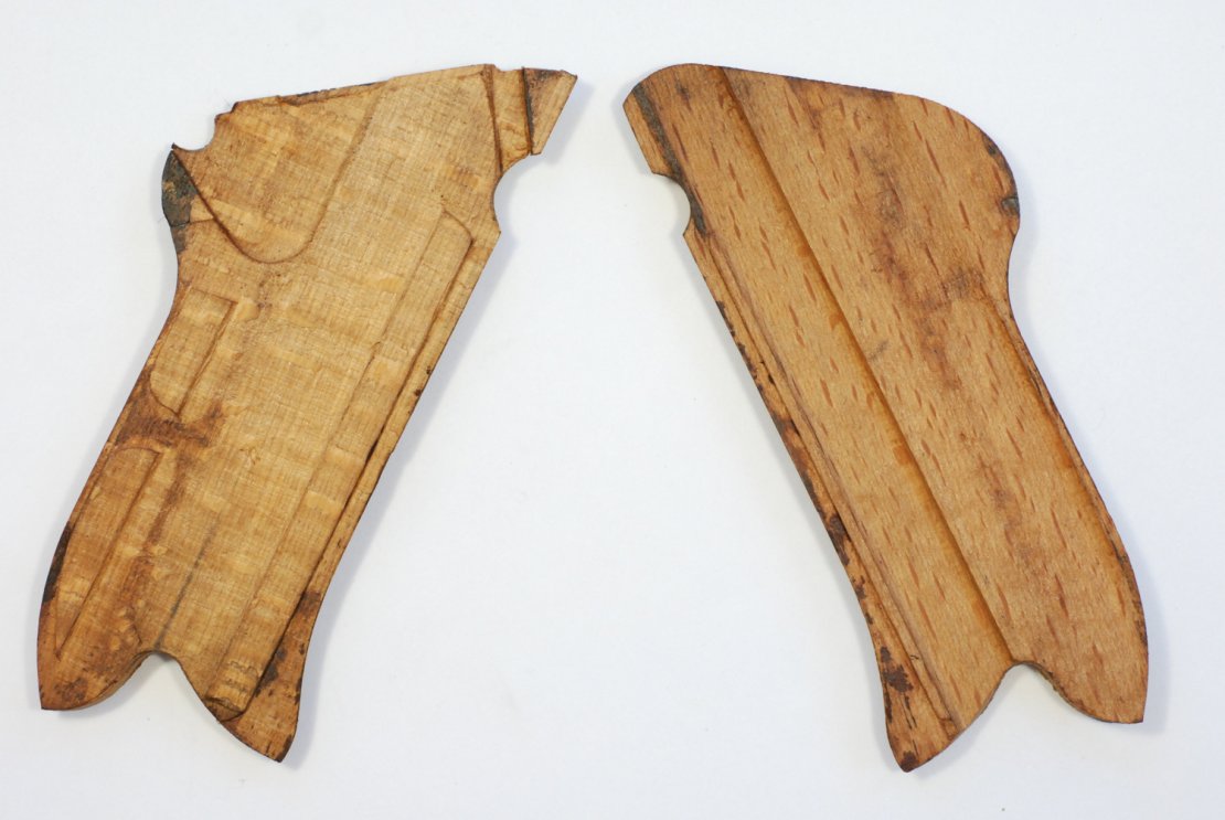

Good looking gun and that unit mark is a nice bonus. What makes you think the grips are replacements?
Best regards, Norm
Unread 06-03-2016, 12:13 AM   #3

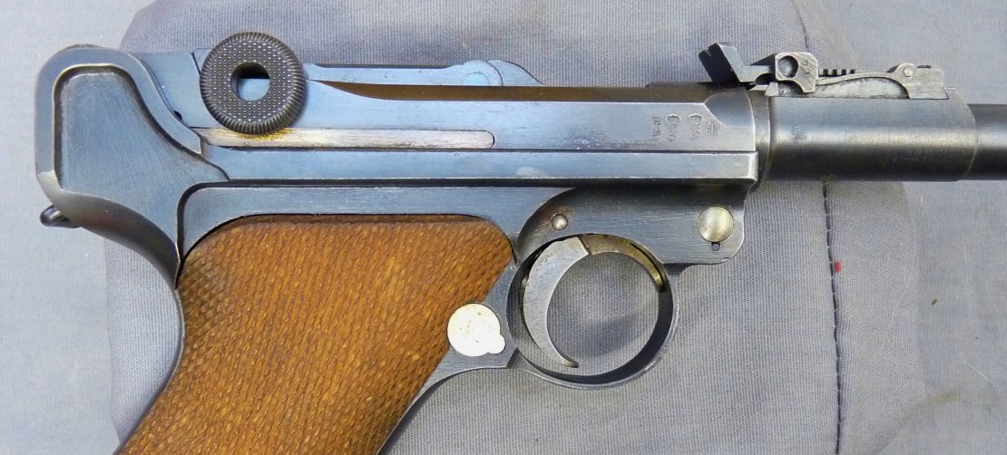

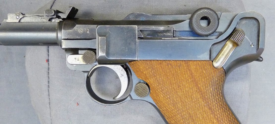

Thanks Norm.
The grips are not numbered with the last two digits of the serial number; the left has a "1" and the right a "3".
They could be original, but I called them replacements since they are not matching.
Unread 06-03-2016, 08:35 AM   #4
Hi Don,
Those grips look original to me. DWM was much less anal than Erfurt about grip numbering and late war grips were usually unnumbered, besides which their condition looks consistent with the rest of the gun. You have to ask yourself, why would a high condition gun need to have it's gips replaced?
Best regards, Norm

Norm,
you are corrrect, and I hope/think/wish them to be "original"; your observations are spot on and I thank you for them.
However if I were buying and I was/did- I considered them to be mis-matched at least, replacements maybe; and negotiated a better price on that basis.
All my other 1917 Artilleries and my 1918 have 2 digit (numbered to the pistol grips).
If I were selling this one, I could not in good conscience call them original- only that the "could be".
But you can be sure I'll print out your post and evaluation and put it in the file for this pistol!

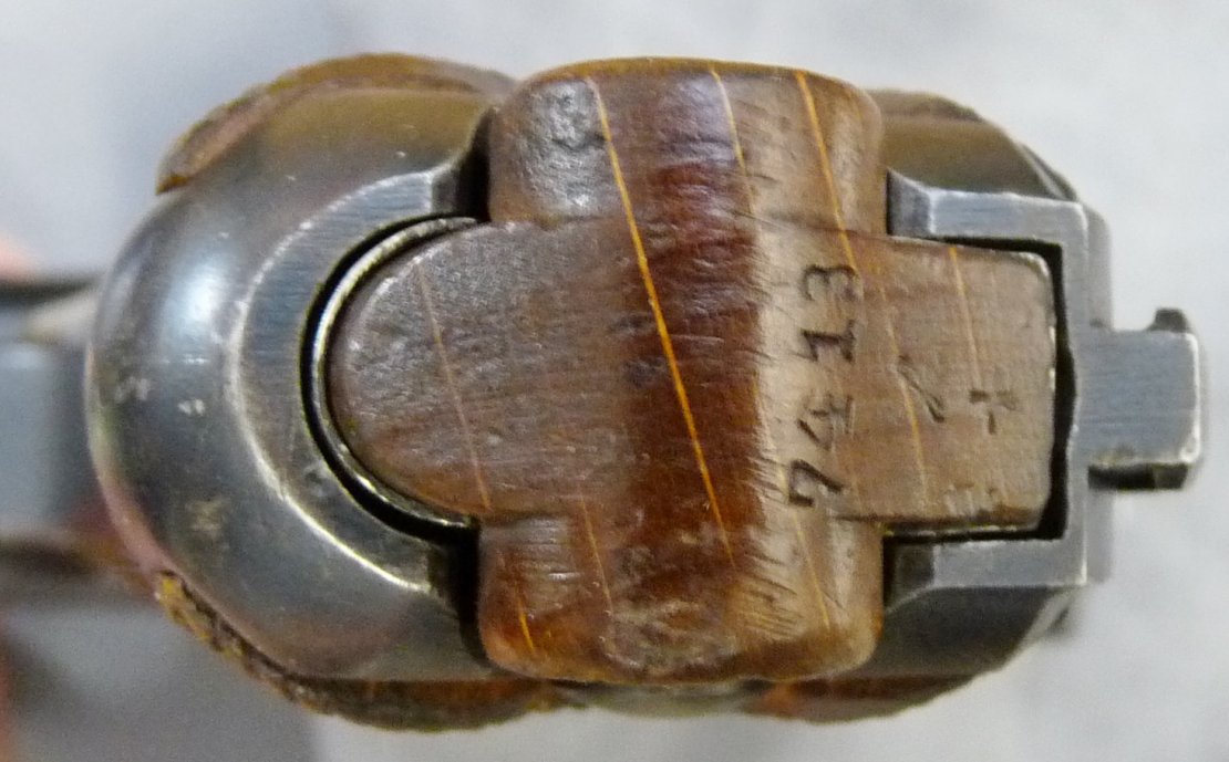

I've read here that some original artillery Lugers can be found with mismatched rear sights. (Numbers that don't match). Can you add anything to this? Do all your rear sight numbers match the serial last-two?
Unread 06-03-2016, 02:19 PM   #10
Rear sights have a couple assembly numbers and pistol numbers(last 2 digits) in at least 3 places.
IIRC, the ones you can see must/should match the pistol serial to be matching.
Of course sight parts are pretty fragile, I expect many were lost or replaced along the way, so yes there are lugers with mismatched rear sights. But they didn't start out that way at DWM.
