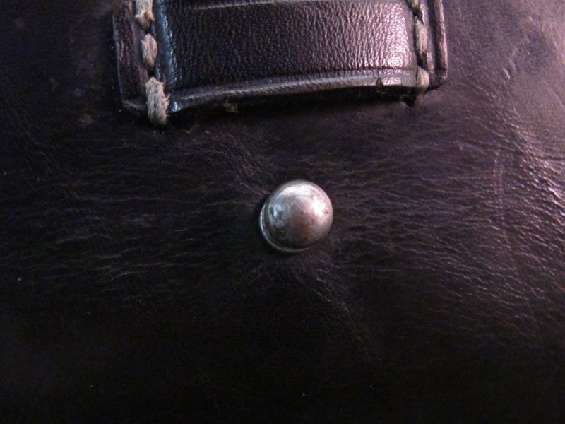

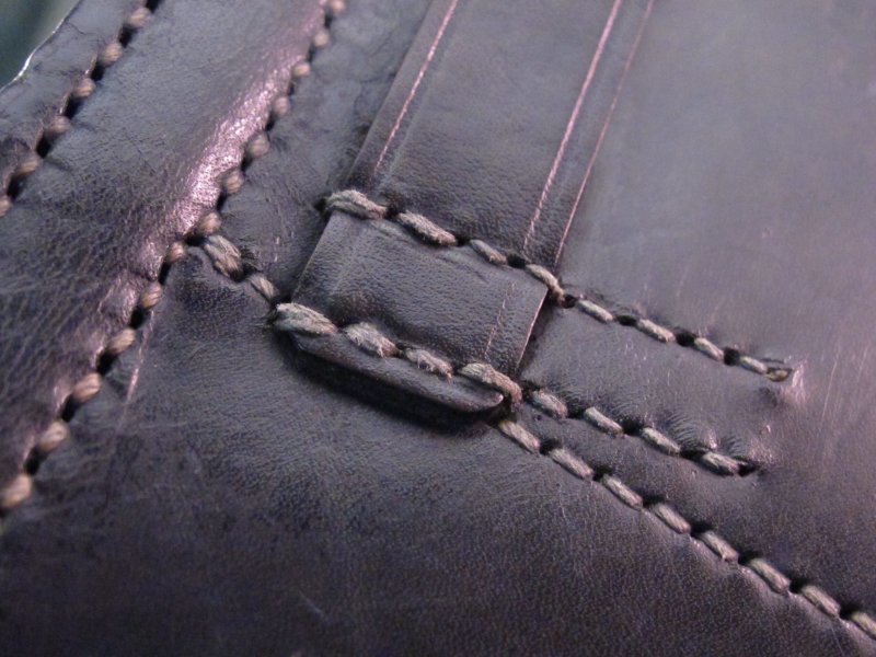

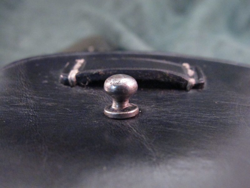

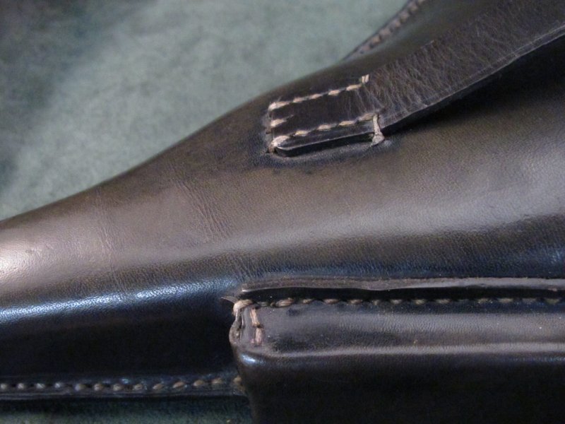

Olle, Yes thank you. I would love to closely inspect the front closure stud. Top, side, in profile.
What concerns me a great deal is the stitching abnormalities I see. Let's take one area that bothers me. The two stitching lines to the bottom right of the left belt loop. These two lines are what hold in the pull-up strap. I would expect to see VERY robust doubled up thread here. I don't see it. I see a single stitch. I cannot tell you how many of these stitching lines I have removed over the years to take out broken lifting straps but, it has been many hundreds. I have NEVER seen one like I see here. It's just not how these were stitched on genuine German period holsters. So it's a handful of these abnormalities that concern me. It is a detail that would be easily overlooked by someone.

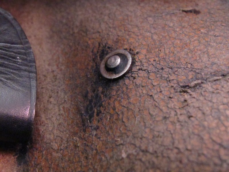

The outside does have age to it, it just doesn't have much wear. The black has faded in some places (I tried to capture this in one of the pictures), and really, the inside aging is not much more than some fine dry cracking and some marks from a pistol. It doesn't look artificially aged, just... well, "old", like it was put away 60 years ago. It smells like "old holster" as well, not that new leather smell you would expect from a reproduction.
Anyway, here are some more pictures for further study:

Unread 12-04-2015, 08:47 PM   #15

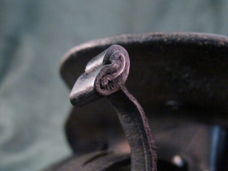

Olle, Thank you! Excellent photo's! I appreciate it. This is getting to be a real head scratcher!
The closure stud looks excellent. Lathe turned. Just as one would expect on an original. The thread is still disconcerting. It looks very much like cotton and not linen. The sections I would expect to see double stitches have not improved..where the pull-up strap is sewn. I am torn. There are several other areas of concern but I am beating you up for no good reason because I just can't nail it down. It has some very good reasons why it is and some very good reasons why it isn't.

Unread 12-04-2015, 09:58 PM   #18
No disrespect, but I think one of the reasons you suspect a fake is the condition. Olle..Let me assure you, you could not be more wrong in thinking this. I have seen and handled MANY mint condition original holsters and owned many more. My thoughts on this one are purely technical and practical. I am not at all awed by it's condition.
On the other hand you are also correct. I suspect ANY holster in this condition simply for the reason that in 1941 the Germans not only made holsters but used them, NEEDED them. While it is possible to survive in this condition..it is rare enough to be suspicious on the face of it.
My analysis and the opinion of others that I respect point to something wrong. This holster is NOT all it should be. Of that I am certain.
Ed, No..cotton is a natural material and will not glow like synthetics do. The thread on Olle's holster is hairy where it shouldn't be. Ends sticking out here and there. Either it's cotton or it's linen but linen only gets this way after being very wet. This holster shows no evidence of having been wet..Dry linen just doesn't do this.
Just let me know if you need more pictures. Olle, yes! Can you get a closeup of the inside back panel where the stitching for the belt loops are? This is another area that will tell me more..
Thanks..I appreciate it!

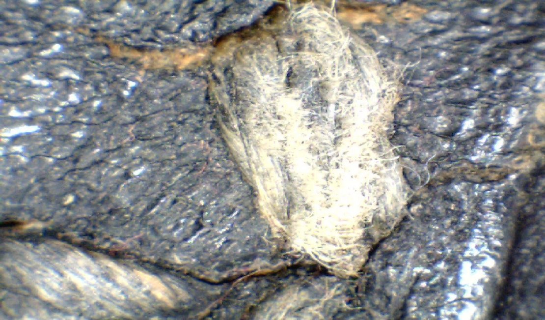

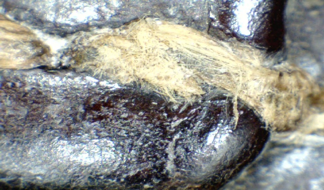

Would cotton thread glow under a ultraviolet light?
Not sure if it would and I don't have a UV light handy, but I took a few pics with my digital microscope (get you one of these guys, you'll love it: http://www.amazon.com/Carson-Zorb-Di.../dp/B002PCOM46) to see if I could spot any differences in the fibers.
The pictures were taken in places where the stitches were a bit frayed so you can see the separate fibers, and pic 1 is "the suspect", pic 2 is a cey 41 which is no doubt original. Color and appearance seem to be very similar, so can you guys see anything out of the ordinary here?

Unread 12-04-2015, 10:16 PM   #20
Olle..Amazing! Yes..it appears to be linen.
