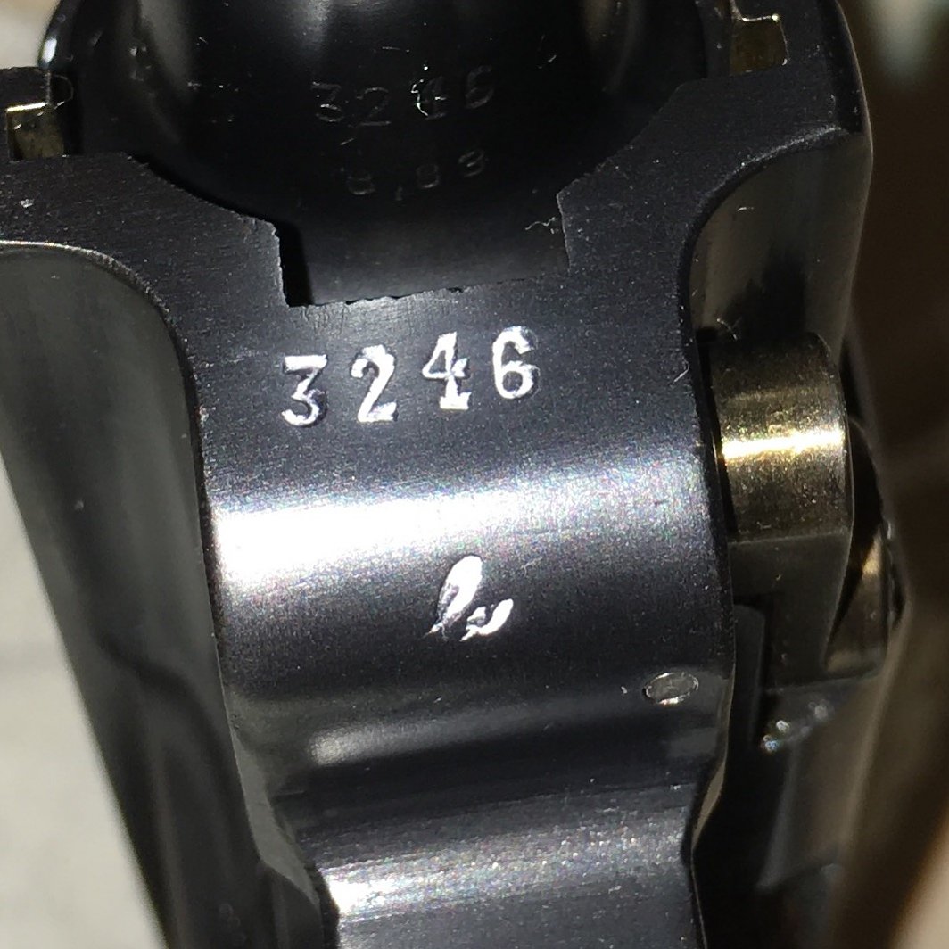

I need help IDing the letter in this serial number. Thanks much! Matt

Location: West Coast, USA
Posts: 544
Looks like a "b".
Tom
Unread 04-09-2016, 09:11 AM   #3
looks like a 'b' to me

Thanks for the info.
Yeah, I've been lurking for a long while and finally got my first Luger today. I feel like I am worthy to post now. LOL

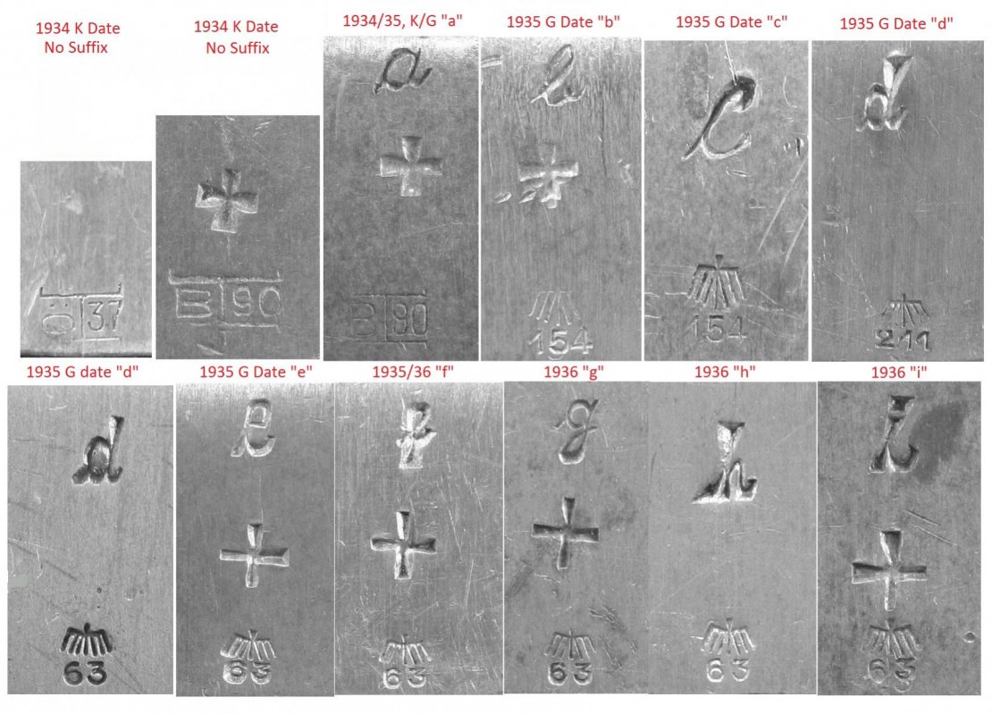

Mateo5594,
I just joined this Luger Forum today, although I've been a member over on Jan Still's Luger forum for years. Just to confirm what others have said, I'm posting a photo reference for a G-date 'b' for you.
Gary
