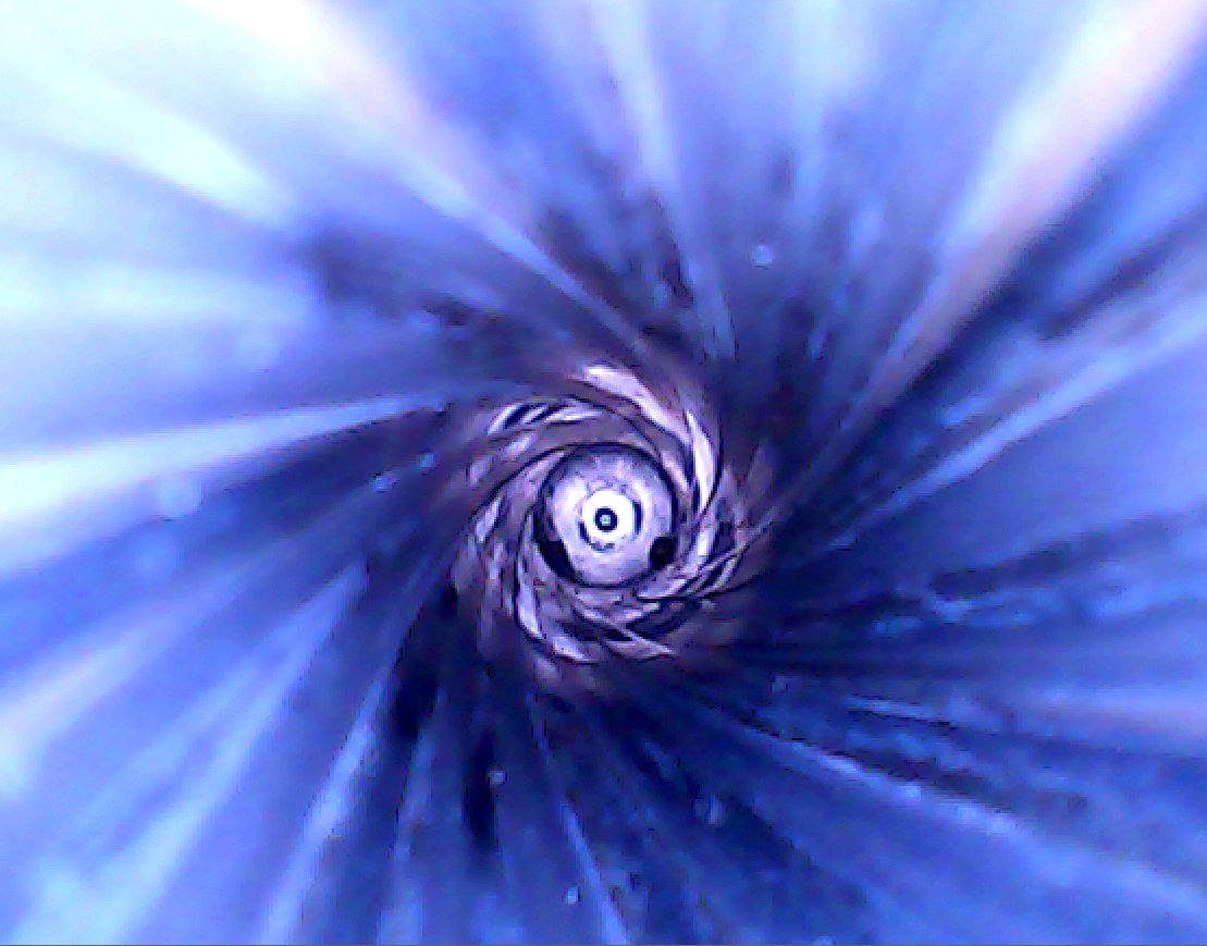

I just bought a $9 USB endoscope on eBay (http://www.ebay.com/itm/361479708489...%3AMEBIDX%3AIT), and was ready to throw it away after finding that the software was in Chinese only. The seller couldn't really communicate well in English, and was no help at all. I was ready to throw it away but thought I'd try it with some software I already had, and I found that it's actually a pretty capable device.
I got the best result by using the software for my digital microscope (MM480 on this page: http://www.carson.com/customer-support/software), for some reason this gave me much better resolution than Microsoft Movie Maker and VLC Media Player. This software will capture videos, but I had to use screen shots to capture still images. The endoscope works like a generic USB camera (like webcams) so I'm sure there's plenty of software out there.
The pictures below show the inside of my SIG P226, so it seems like endoscopes are not only for examining us who have reached 50.

I'll probably look around for software that's better suited for this, but there's really nothing to it. You just fire it up and poke around with it. One guy said that you can get a better view in a barrel bore if you use one of the included wire hooks to push a white cleaning patch in front of the camera, and you will also have to play a bit with the light (there is an adjustment wheel on the cable). Also, there's no focus adjustment, and it seems to focus about 1" - 1 1/2" in front of the camera.
It actually came with two different hooks, one is just a wire hook and the other one has a small magnet. The instructions were a bit sketchy, but I would think you can use these if you drop something in a hard-to-reach spot. The attachment (a small plastic sleeve) is a bit cheesy, but it seems to work.

I played around with VLC again, and found that you can actually change the resolution. You can also adjust brightness, white balance, saturation and a lot of other things. It also has a snapshot function, so you don't have to do a screen shot to capture stills. Took some more pics inside my trusty P226 and I believe the quality came out a little bit better this time, but this is probably as good as it's gonna get. The resolution can only get as good as the camera allows (640x480), so I figure that it won't be much better than what you see here.
Still ain't bad for a $9 camera, is it?
