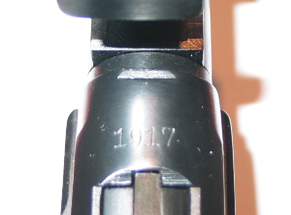

The pics below are of a mismatched Luger with a 1917 chamber date. I am curious as to what the proofs are.
The only one I can actually read is the C/RC, which in a previous post(s) both Dwight Gruber and Ron Wood identify as 'revisions commission'.
What are each proof, and what does the revisions commission stamp signify???
I'm sorry but I can't tell if one is a C/GB and one a C/F...The third one doesn't even look like a crown...Those scriptive letters really confuse me...
(BTW: The mismatched parts it came with [it was disassembled, PO had started to polish it] had both an Erfurt and a DWM middle toggle link...Any way to tell which is correct? It does have the 'notch'.)

OK, let me line those up and stare at them for awhile until it sinks in...The family initials could be used to identify which maker if I could find another 1917 with notch and exact same proof stamps, correct? I can't read the Gothics either.
I am having difficulty with the 'revisions commission'. That is a government body, not a manufacturers quality control division??? I have Walters definition of it, but still don't quite understand what the commission did...It lowered the standards for military acceptance maybe???

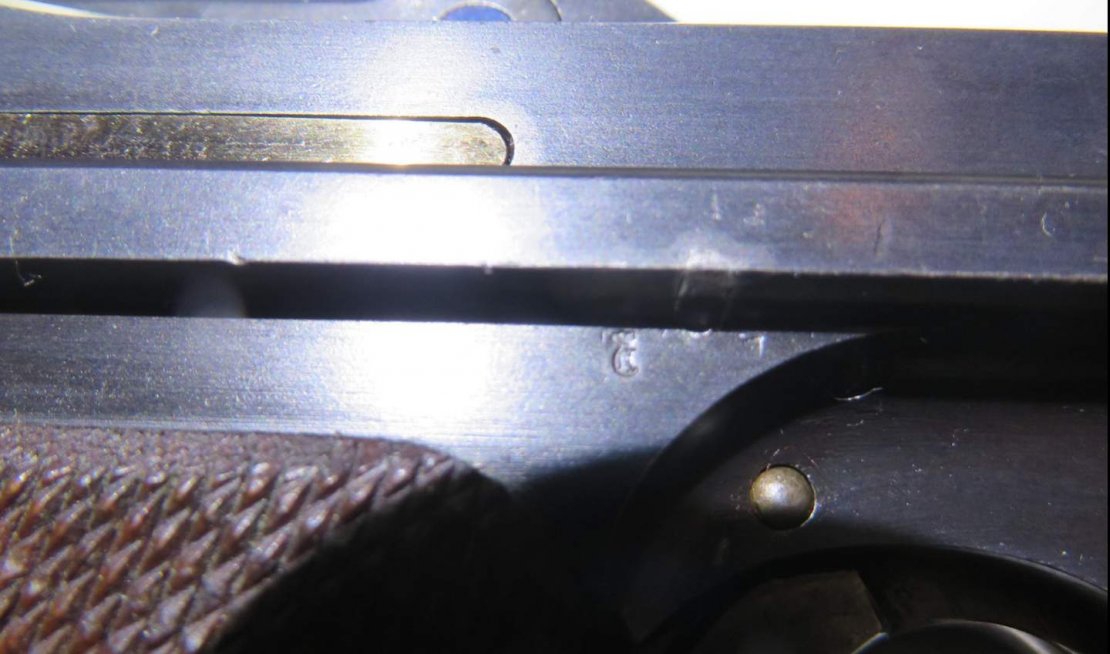

This is not just a crown, I think
Attachment 56622
No, not just a crown, but a crown over a letter, tough to call on these small ones, C/G or C/C or C/some other letter; but they are all Crown over something- as is typical of the small Erfurt acceptance.
I'm sure that is what Ed meant, C/something, not RC/Crown/something.
