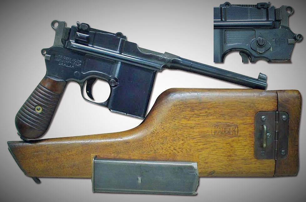

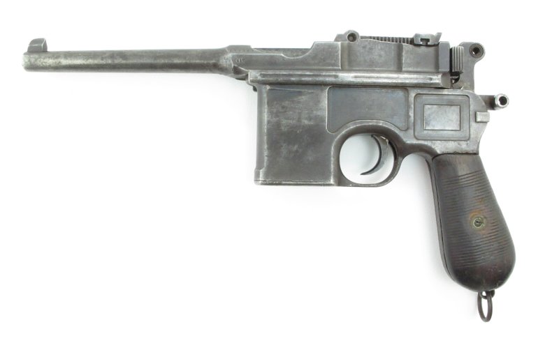

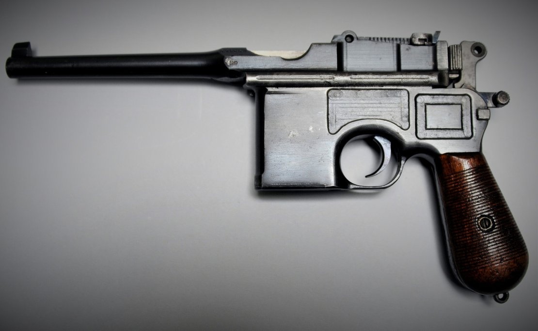

Thanks, that helps a lot! It actually appears like the hammer is in the white, would that be correct for my pistol?
Unread 09-18-2015, 02:24 PM   #8

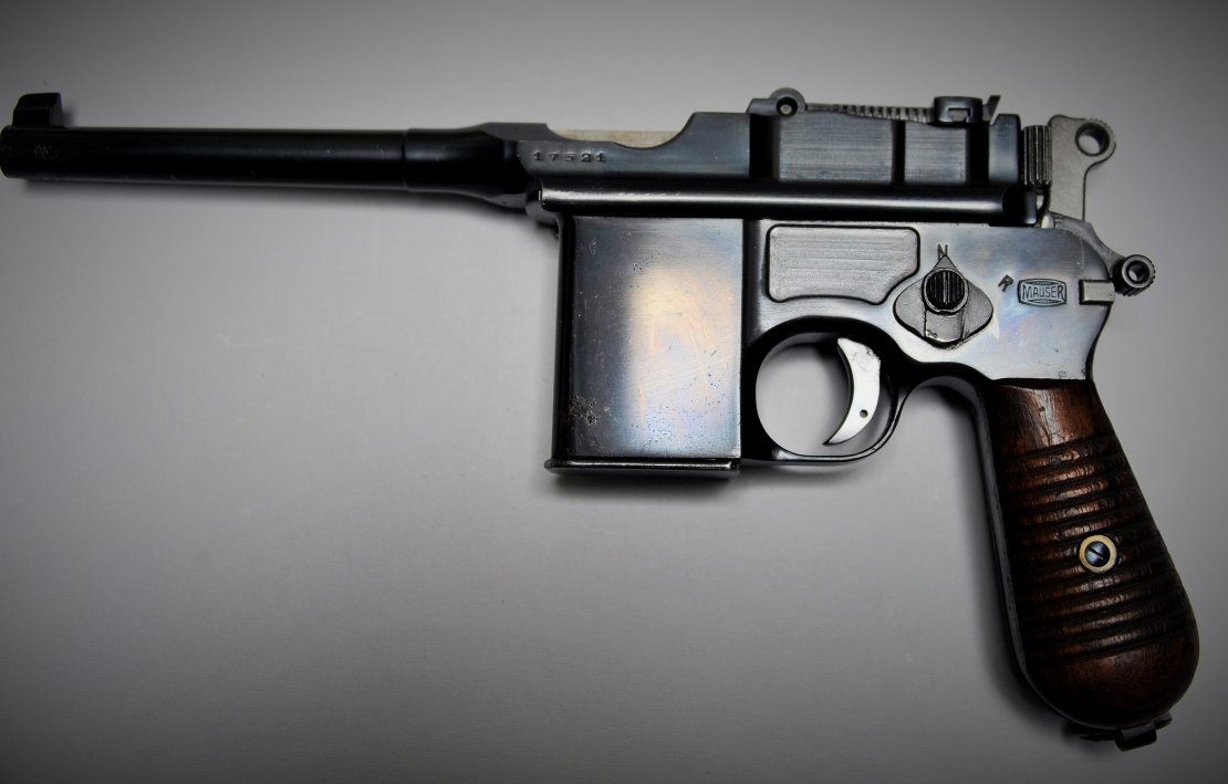

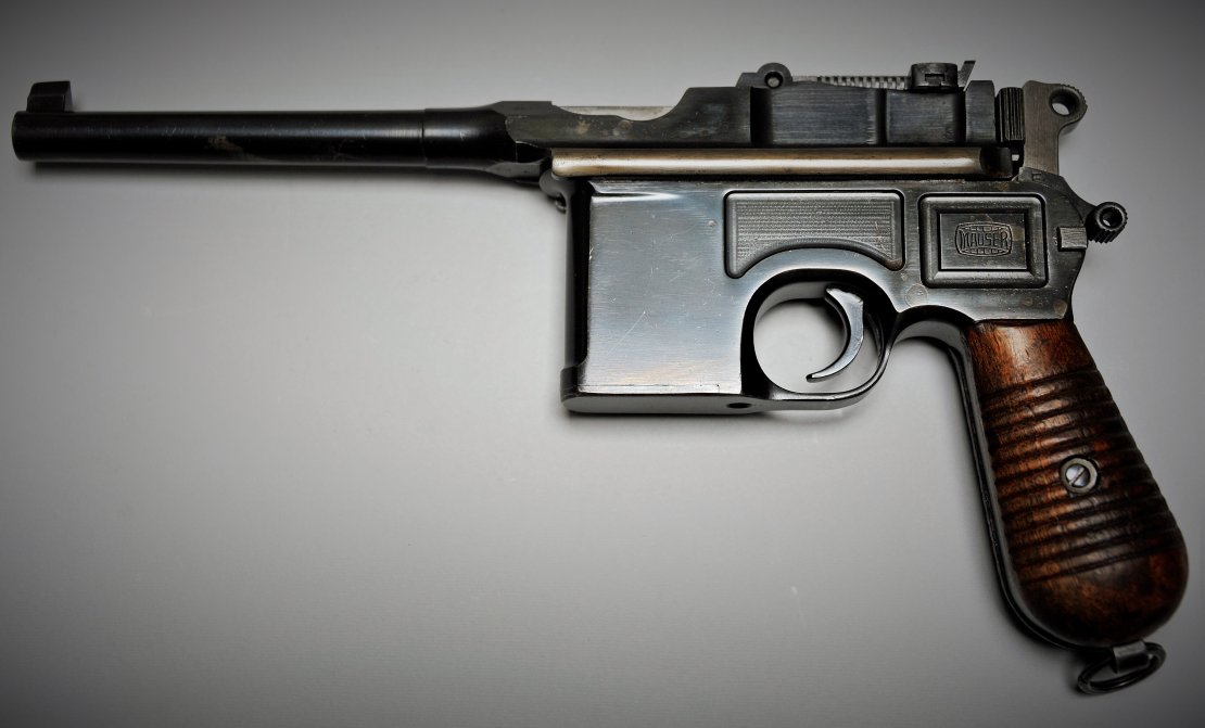

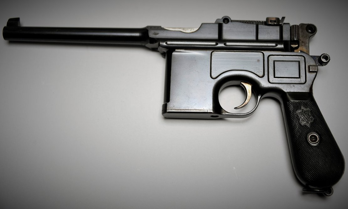

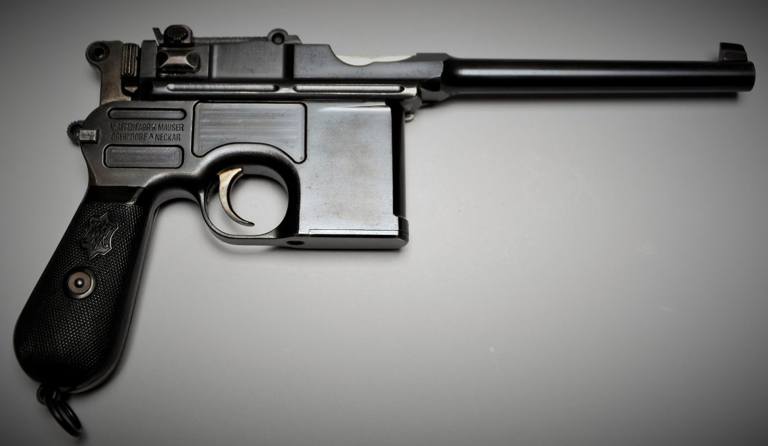

Olle,
Yes all hammers that I've seen are in the white (well at least all my C96 have got hammers in the white) I enclose some pictures of them.
Best
Sergio
File Type: jpg 112_pagine_1398277529_1921_DSCN2562.jpg (103.2 KB, 95 views)

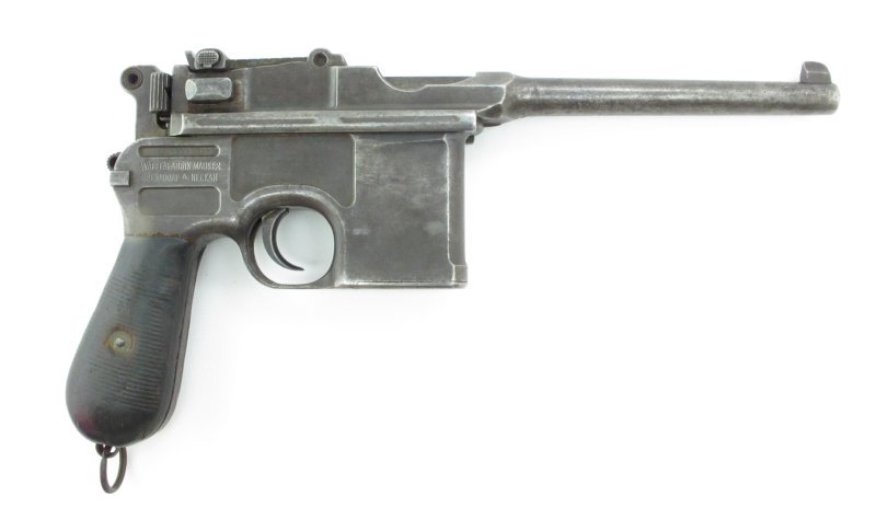

You can use this one as reference.
http://www.gunauction.com/buy/13529540
I just sent it out yesterday. Not in my hand anymore. Mauser finish could be confusing. But this one can be used as a reference.
Hammer is supposed to be grey. Trigger finish depends on s/n. Rough rule of thumb -- if it has 4 rifling lines, strawed trigger. 6 rifling lines, fire blued trigger.

Great pictures, thanks! I don't know if it's just a trick of the light, but is the whole bolt in the white, even the rear part?
Unread 09-18-2015, 03:21 PM   #11
Yes. The bolt is silver white, including the rear end.
Unread 09-18-2015, 03:35 PM   #12
Yes absolutely.
Sergio

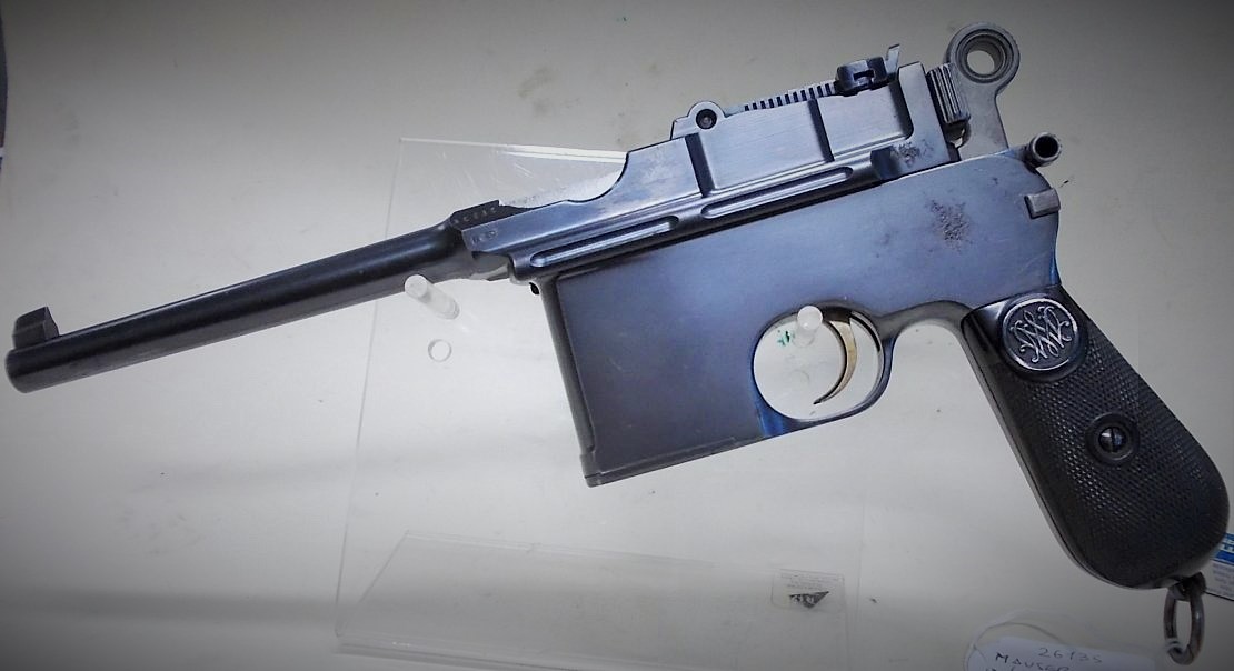

Unread 12-19-2015, 01:58 AM   #15
Olle
Olle's Avatar
Join Date: Feb 2010
Location: Tennessee
Posts: 1,149
Thanks: 159

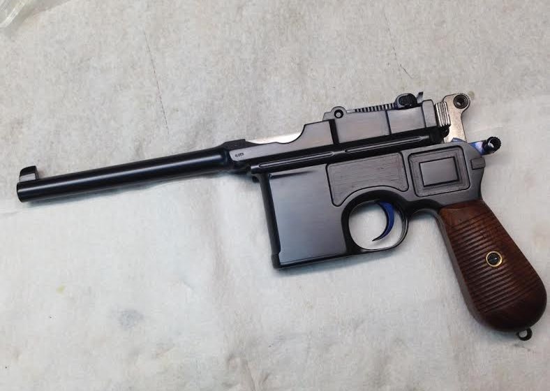

Update: Got it done this evening, just in time for the gun show tomorrow. I'll be selling guns together with a friend of mine, so I hope it will make people stop and look at our stuff.
This gun was pretty rough to begin with, and needed quite a bit of welding, filing, shaping etc. The grip frame was severely rusted, so the only thing I could do was to weld up the edges and call it a day. There's still pitting under the grips, but it should hopefully be in a more stable form now after being boiled and soaked in oil. The grips are repros from somewhere overseas, they needed a lot of massaging to fit and they are still not perfect, but at least they look decent.
I would like to thank Paladinpainter for his role in the project, he was gracious enough to send me his special bluing formula, and he also did some of the nitre bluing. The barrel was relined by Redman's, and all that's left now is to install a new recoil spring and it will be ready to test fire. I should have ordered that spring before I even started working on it, but....
Anyway, here she is:
Looks great. But remember the most important spring in a C96 is the main spring. The recoil spring just closes the bolt.

Nice work, Olle. I suspect there is a lot of elbow grease on this one.

Looks good.
Standard C96 with shorter chamber (like this one) usually has slightly brighter finish. Those with long chamber has dull military style finish -- because WWI was approaching, many long chambers were sold to that direction. So, strictly speaking, the finish is not 100% correct, but it's good enough.
Unread 12-19-2015, 09:23 AM   #19
Olle
Let me congratulate with you from the picture it looks like a nice work indeed!
Unread 12-19-2015, 10:30 AM   #20
Very nice job.
