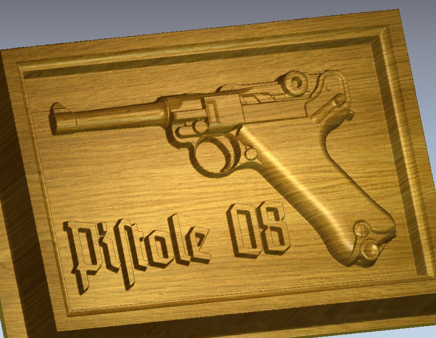

I'm trying to figure out how to create 3D artwork, and though a Luger would make it a bit more interesting. Found a nice 3D model, added frame and text, generated a tool path for the CNC-router and ran a simulation.
All that's left is to put a piece of wood in the router and run it, but I probably have to flatten the model a bit first so I can cut it from a 3/4" board.
What do you think?

I would buy one at a reasonable price. Nice work.........

Looks fantastic but might use a couple of enhancements. There could be a more defined shadow line between the front grip strap and the grip plate, and the rear of the grip is a bit too straight at the heel (l think it might be a vestige of the stock lug showing up in the profile). Ditto nice work !

Very nice work. I think that you are on to something here.

Olle,
looks like an excellent idea !
maybe allow order and tailor to the interest - like
- DWM logo or Mauser or chamber crest eagle and etc logo in area under barrel rather than P08
- option for the new made 1970s Mauser lugers
- model like navy or artillery
- short frame or long frame
- full size or half size like centerpiece for cover of a pistol case
- wood like typical oak and others more exotic
- full 1/2 width like slice gun vertically vs thin relief version
good luck with project !
Bill

Perhaps consider a negative (cutout) version of the other side of the Luger to make a custom fitting tray for display of a real Luger...
That would be a very interesting offering...
Also custom text for an individual's information...

I found the gun model on a site were people share their artwork, and the guy who made that said that he had been using original blueprints. You can still see some details that are not quite right, and I might fix these once (if) I get proficient enough with the 3D software.
That line between the grip and the frame is actually there, but it doesn't show in the rendering due to the artificial glare. And really, there isn't much of a transition with a well fitted set of grips so the lack of checkering almost makes it look like the grips just run into the frame without a seam.
Checkering would be nice, and I would also like to fix the "Indian gap" between the grip and the side plate. I suspect that the guy drew the right panel first, and simply mirrored it to make the left panel. The stock lug is there, not 100% correct but fairly nicely done.
The text can be whatever I want it to be, and you can add all kinds of stuff like insignias, flags etc. It's pretty time consuming to make the 3D model, even if you already have the gun itself, but it's a lot of fun as well. I actually made another one and ran it in the CNC last night. I gave it to a friend of mine this morning and forgot to take a picture, but this is what the rendering looks like.
As you can see, the gun is not 100% here either. The spring housing sticks out too far and the safety is in the wrong position, but it's still not bad for a free download

I bought one of those Craftsman wood cutters about 7 or 8 years ago, was disappointed in it - I would imagine they have improved a lot since then.
The issue I had was with detail and size, it would cut a 1/3 size luger from a scan that I did of my own luger, worked decently, but not as nice as I'd like
I would bet you can get a nice one done right nowadays!

Just use a thicker piece of wood!
I think more relief is better than less.
Looking good though.

Ed,
The one I have (a 3'x4' General CNC) is probably a more professional model than anything Craftsman would sell, but I don't think the concept of a 3-axis CNC router works well for smaller models than maybe half scale guns regardless. And of course, using wood as a medium limits the detail level quite a bit. You just have to look at it as "strictly decorative".
I haven't worked much with scans yet, got a laser scanner off of eBay a while back but haven't really made much of an effort using it. What kind of scanner did you use?
