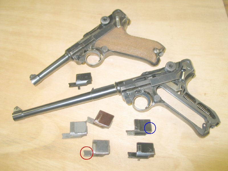

I'm asking for opinions on fitting a non-OEM sideplate to a mixmaster Luger.
Here's what I have so far:
- Mixmaster Luger w/humpback Mauser frame, Sarco repro artillery barrel, all-Mauser upper
- Assortment of sideplates with various problems
Some of the sideplates have bent front tangs [red circle]; some have too-thick rear tabs [blue circle]; some have too-thick front tangs...
The Mauser on top has a sideplate that is a perfect fit on the faux arty...Unfortunately, it is a perfect fit on that Luger as well...
What is your method of fitting??? Do you bend or file the front tang to get it to fit??? Do you file/mill the rear tab to get that to fit??? (The rear tab on the 'long-humped' sideplates are .005"-.007" too thick for the frame slot).
In my mind, the sideplate with the too-thick front tang is the easiest to fit...It just needs a little filing to let the takedown lever fully engage...
...But is that the 'right' way to fit a sideplate???

I bought one of the cheaper repro cast plates (like the one on the left side?) and had to file down both of these spots and the top rail. I definitely would not file the other parts of the Luger. I took off just a little at a time and insured it fit well. And was very careful to insure the geometry of the indent that takes in the trigger pin and the trigger lever clearance was not effected.

The rear tab should be a "perfect" fit or as close as you can get it by polishing the tab until it will enter the slot without much resistance. The front tab if too thick should be polished on the underside until the takedown lever will close, again "without much resistance. It is a "feel" kind of thing. The sideplate when fitted properly should not "float" between those two points. If it does, you will never get a consistent trigger pull.
The curve on the front of the sideplate should be a matched fit to the diameter of the takedown lever.
Now you know why these pieces were numbered to the gun when they left the factory. Other "may" fit, but only the original parts were manufactured to fit when the gun was presented for the final acceptance inspection.
You said that you had a sideplate and a Luger that were a perfect fit... use it as your control when polishing the new sideplate. They should feel pretty much the same when fitting is completed.
In addition, the hole in the trigger lever should be a good polished fit to the pin that holds it. If it is a sloppy fit, then again, the trigger pull will never be consistent, but will vary as the sloppy lever gets pulled down by the trigger. Polish all bearing surfaces of the trigger lever (not metal removal mind you, just polishing where the pieces may drag when rubbing against each other.)
The result should be a reasonably good trigger pull.

The front tab if too thick should be polished on the underside until the takedown lever will close...
What is the rationale for the underside being polished (I assume you mean filed/sanded)??? I would think that if the trigger worked OK that 'polishing' the topside, where the takedown lever rubs, would be the correct area to 'polish' (in fact that was my intention). What am I missing here???
'Polishing' the underside would, it seems to me, bring the entire sideplate assembly closer to the frame. May require filing the notch for the frame, deepening the trigger shaft relief, etc.
Each sideplate does not have all the problem areas mentioned. One has a bent front tang, another two have thick rear tabs, one has the thick front tang. Of these, the one with the thick front tang seems easiest to 'fix'.
Is it safe to bend the front tang??? Will it bend or break??? If the front tang is too short what does that do???

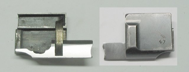

Unread 10-08-2015, 07:57 PM   #5
Out of the several opinions offered, John's seems to be the most reasonable...So here goes...
I draw filed the rear of the sideplate with a fine mill file; progressively sanded it with 220/320/400 grit wet/dry sandpaper; polish with emery cloth; trial fit to Luger...Repeat as needed...Until takedown lever would rotate into locked position.
The sideplate from my other Mauser Luger fit & worked quite well, and on mic'ing the front tang it measured .097" thick. The tang on the #47 sideplate measured .099". So it was only off by ~.002".
I'll assemble it all tomorrow. I'm missing a takedown lever retaining spring and an artillery rear sight base spring (the flat one) but otherwise finished assembling an artillery shooter.

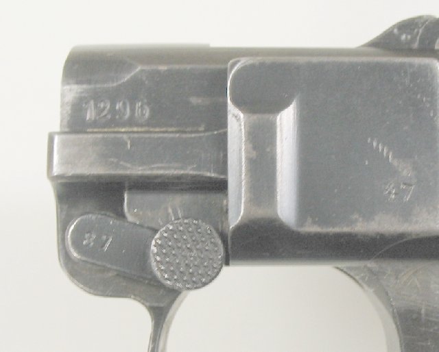

My cannon assembly was very tight fitting to my frame, so last night I stripped the frame down and lapped in the barrel extension. It turned out quite smooth. I cleaned the lapping media off with solvent and scrubbed the parts with a stiff brush and soapy water, then blew the parts dry with compressed air.
This is how the 'thick tang' sideplate fits. The takedown lever is sloppier than I would like (side-to-side) in it's cavity, but it's what I gots.
I don't want to force the lever up any more than I can move it with my thumb. As is, I have to move it down with a clothespin half to get it disengaged.

Where did you get that takedown lever? It could be just the angle at which the photo was taken but it appears that the lever is too long and is bumping into the side plate before it can be fully rotated into place.
Unread 10-08-2015, 02:05 PM   #11
I believe you may be right, looks like contact at that angle to me too.
I have had this problem, one can reduce the front edge of the side plate if the interference is only a "smidge"(that's a tech term for not too much"?
Better solution is another side plate, or lever.
I go for another lever is that one is loose side to side, JMHO.
It came with and is numbered to the pistol.
It could be just the angle at which the photo was taken...
Yes, exactly. New closeup pic attached.
You both need glasses.
Unread 10-08-2015, 04:28 PM   #13
Got glasses, what you need are better pictures!
Just trying to help, no more.

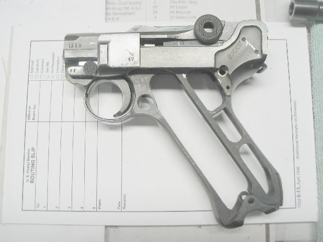

All knowledge is valuable, everything gets noted. Some solutions are obvious, others not so much.
Thanks again for all your comments!
(Sideplate shown here on the rarely-seen 1942 Mauser Cartridge Counter Artillery Luger)...

Unread 10-08-2015, 11:06 PM   #19
Nice work Rich...
Watch out, or a certain dealer with a colorful and wordy website will want to sell your one of a kind "variation"!
How does the trigger feel?
Unread 10-09-2015, 12:14 AM   #20
Nice work Rich...
Ooh, I didn't know he had a website! He's 70 now, I imagine he must have some younger apprentices working for him...
I think I can come up with a 'war story' that would explain this exciting and rare variation...I think it was issued to the long-range Focke-Wulf Condor pilots [from KG200] who planned to bomb New York City by refueling on ice floes in mid-Atlantic with avgas supplied by U-boat...
Trigger doesn't feel too bad, but my experience with Luger triggers is limited. I know enough not to compare them to anything else, but if I think of it I'll test the pull against my other...three?...And see how it compares...
The trigger spring I had been using went into coil bind before releasing; I had a shorter one in my spares that 'fixed' that particular issue...
The mainspring did seem longer than the three or four 'spares' I have in my parts box...
