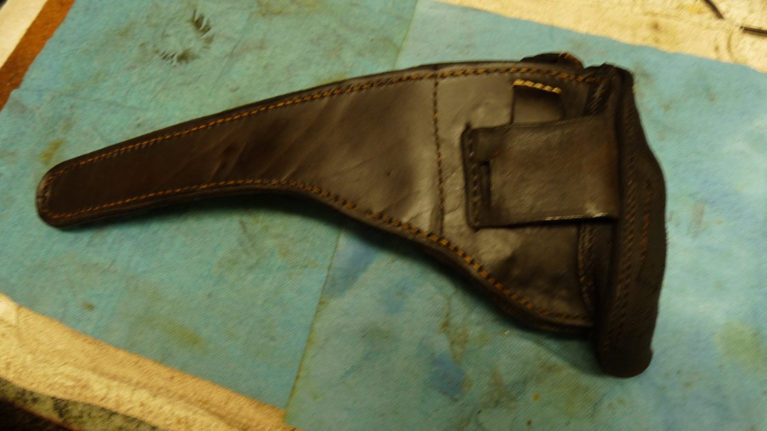

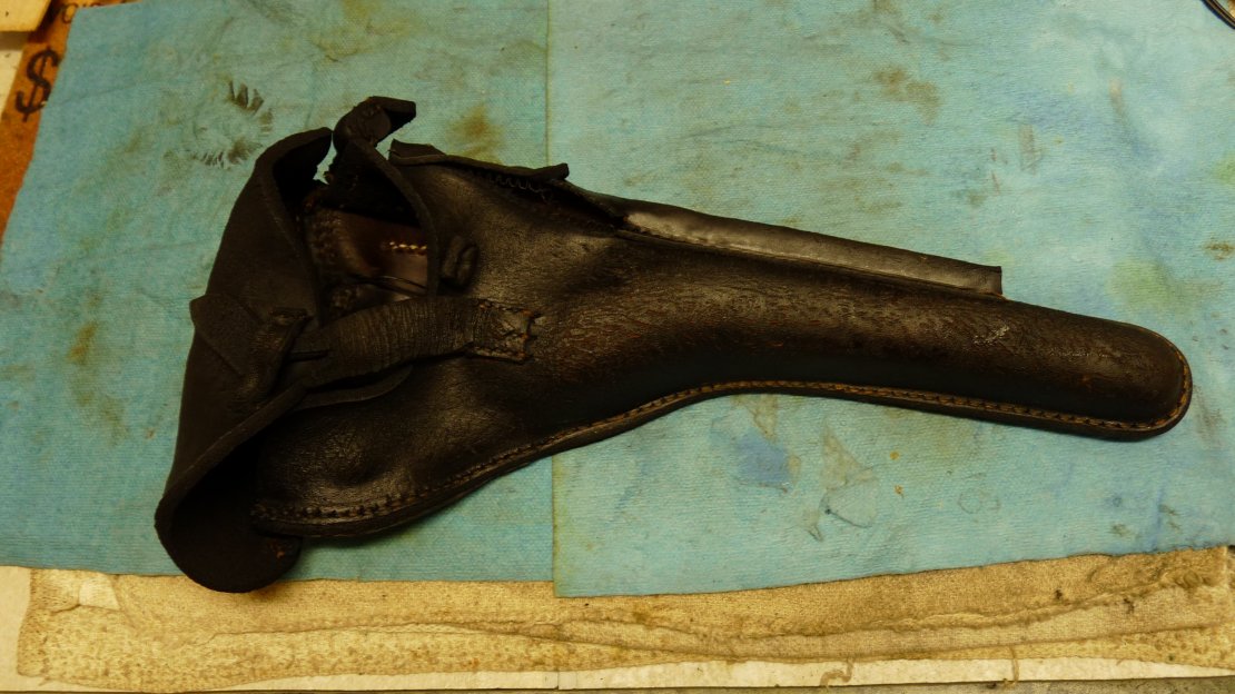

This is a tough thread to write and a super-cautionary tale!
I recently bought an Artillery holster in nice shape at a good price,
1917 marked, belt converted, nice supple leather. Had Jerry the holster man take a look at it before I bought it, looked fine, except for some white mold spores.
Asked the best way to "kill" the spores and got instructions:
"Heat oven to 350 degrees, put holster on a cookie sheet and put in oven at 350 for 5 minutes, cut off the heat. Leave in for one hour and take out. Mold will be dead and no harm to the holster."
Simple, just be aware that it may smell up the kitchen a little.
So me, I think well I'll take care of that and wrap it in foil to keep the odor down and prevent it drying out to boot.
WRONG!!
What I did was "boill" the leather , then dry it out! It was shunk, twisted, and hard as a rock, in short RUINED! Only salvageable
piece was the brass stud for the cleaning rod flap.
I'm not posting this so anyone can tell me I was stupid or dumb or anything of the sort, I have already beat myself up enough.
This is to help someone else avoid a potential disaster!

Before and after disaster:
