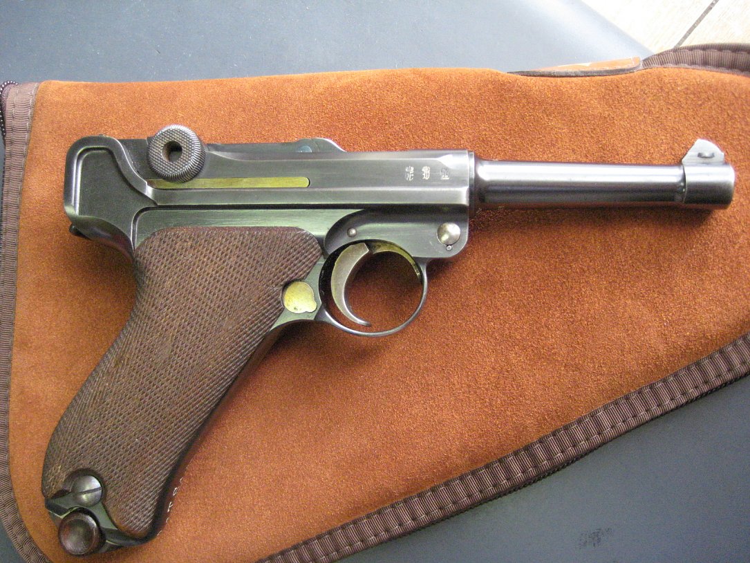

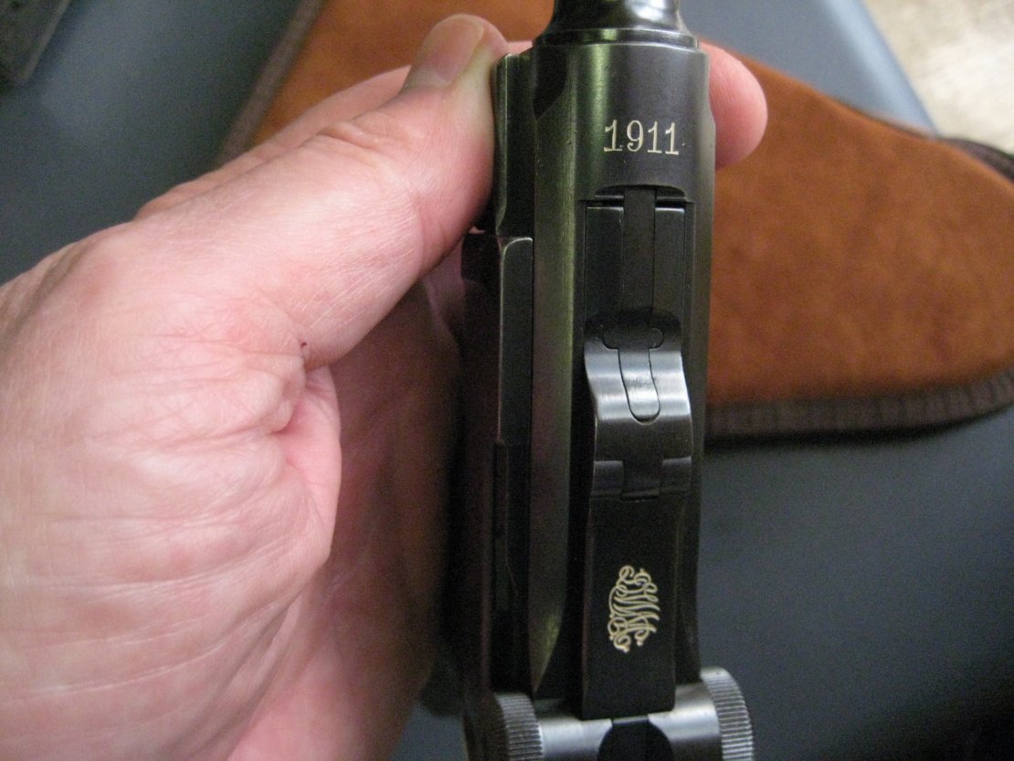

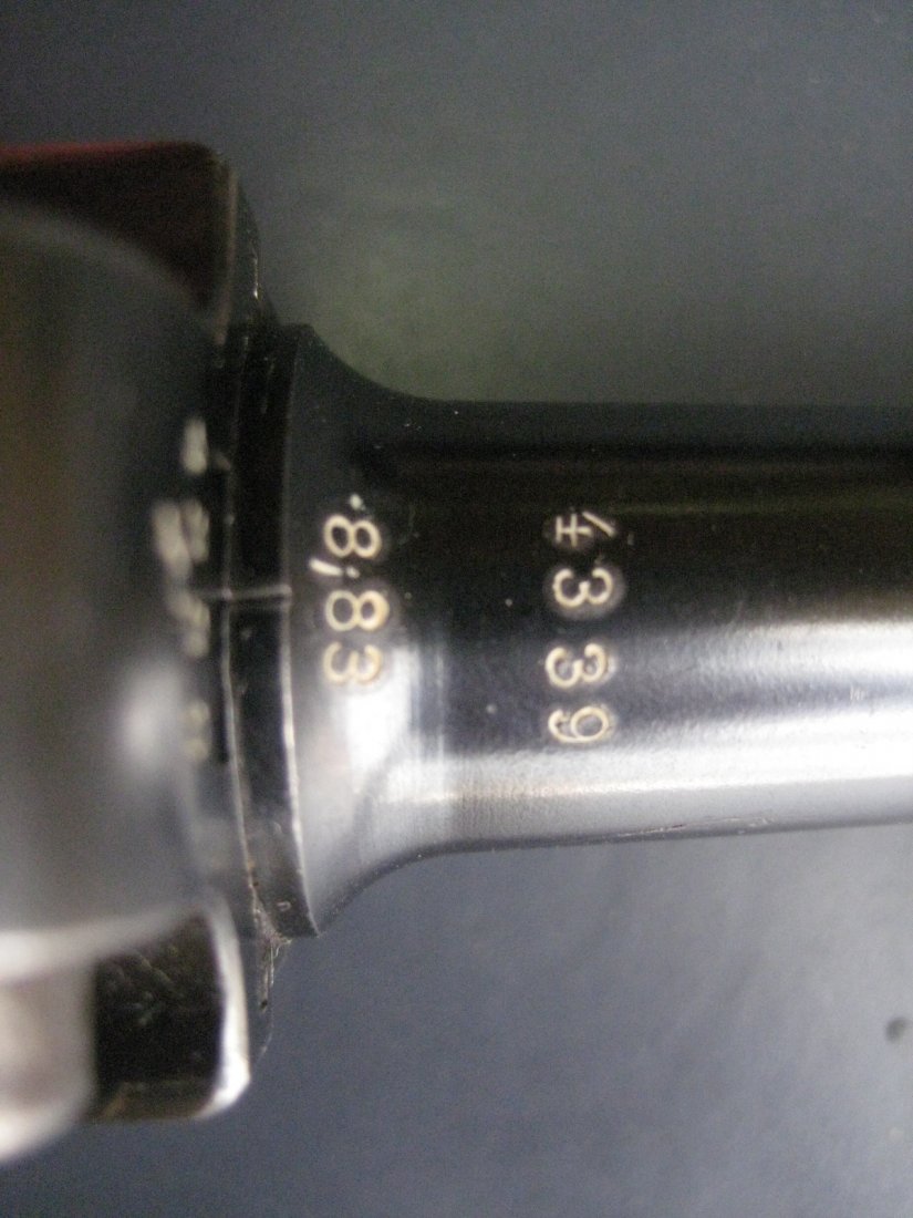

I found someone online who has the pistol within several number of mine in the regimental numbering. Photos included. Seems rude to talk about the pistol but not show it. Rather nice straw. Thanks for the continued discussion

How about showing us a photo of the front of the frame with serial number?

You bet...

Very nice; now take it apart and see if the hold open is there or not!
Unread 07-15-2015, 11:47 PM   #12
No need to take it apart, the first photo in post #7 shows that this gun has not been retro-fitted with a hold-open.
Regards, Norm
At least not by Erfurt.

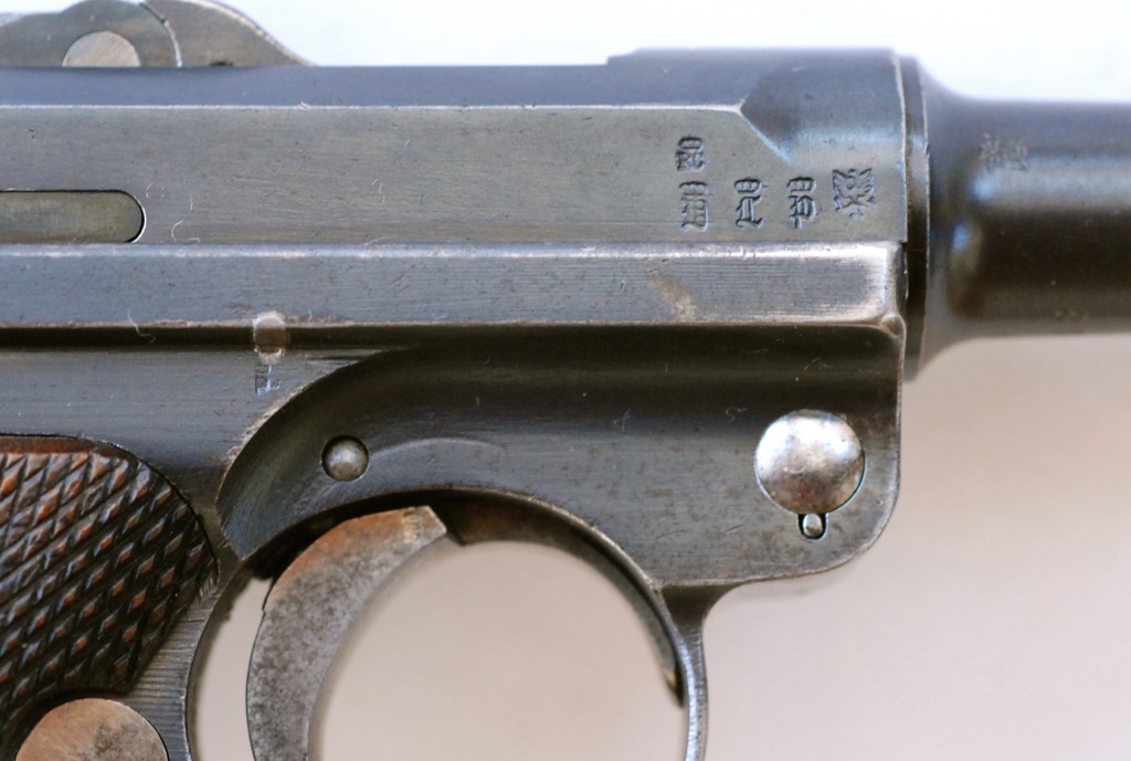

On guns modified for a holdopen post manufacture, you should find a small pin has been installed in the right frame rail. This pin is visible on the outside of the gun. Sorry I don't have a photo handy to show you.
Unread 07-16-2015, 10:49 AM   #19
Here's a photo of a 1912 Erfurt that was retro-fitted with a hold open. As Ron has said, all these conversions were done by Erfurt so DWM Lugers have the same small inspection mark. The end of the pin on retro fitted guns was always left "in the white", if it's blued over then the gun has been refinished.
Regards, Norm
That's the pin up and to the left of the trigger pin, bisecting the edge of the frame rail??? OK, I got it now!
