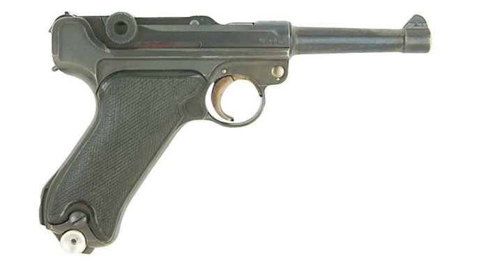

World War II German Luger Pistol by Krieghoff
Serial# 11507, 9mm Parabellum. 4" barrel, very good bore. "1943" chamber date. Matching numbers including on aluminum base of the magazine, with inspection "LWaA/2". 95% bright factory blue with minute pitting on the sideplate, 75% straw, very good checkered black Bakelite grips with a small repair on the left one under the screw. These were made for the German Luftwaffe and in his book Randall Gibson estimates only 300 were made with the "1943" date. {Ref., The Krieghoff Parabellum by Randall Gibson.}

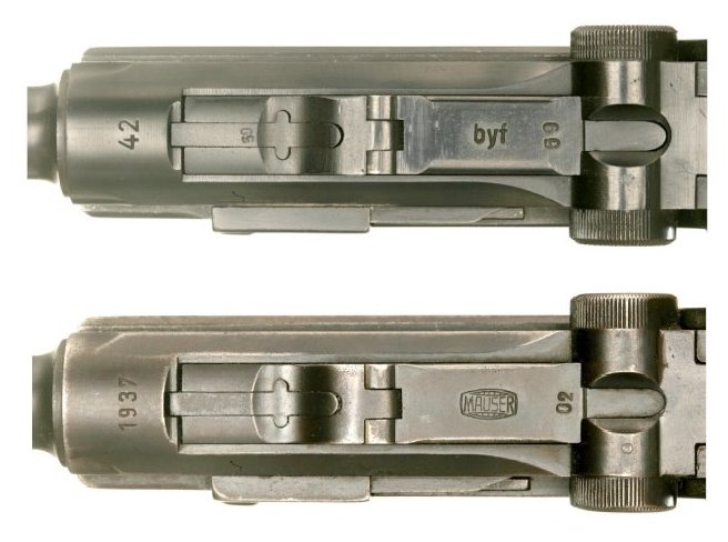

Unread 01-01-2015, 12:29 PM   #9
Originally Posted by Ben M. View Post
* or just "43" like the late Mauser Lugers??? *
please tell me more infomaticions. i was not aware of such 43s
...???...Not sure what you're referring to...But here's a pic below...
1942 production Mauser with two-digit chamber date, rather than 4-digit (like 1937)...

i was puzzled when you mentioned 1943s or 43s.
did mauser make any with this dates?
