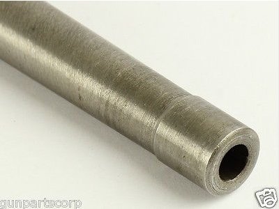

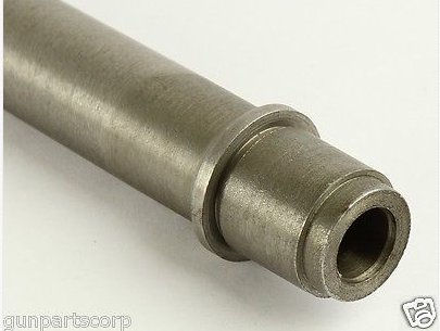

A 6 1/4" 30 cal bbl and an 8" 30 cal bbl...
But no threads and no front sight base...
I suppose if you're into sweating/soldering a front sight base on after cutting the thread, then these would be good deals...At a reasonable price...

Kind of a strange way to make a replacement barrel... If you're going to the trouble of turning the taper and the shoulder, and chambering it, but not machine the front sight base, why not thread it??? It doesn't matter where the barrel indexes, there's no front sight, no feed ramp, and no extractor cut...

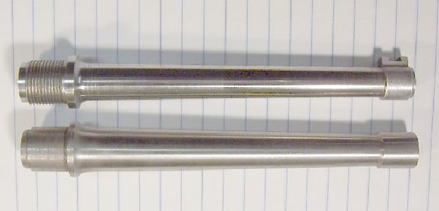

I git the 6 1/4" barrel in from Numrich today...I'm somewhat disappointed...
It may not be readily apparent, but the taper is quite 'fat' up where the shoulder is...More so than a 9mm or 7.65mm [100mm/98mm] barrel [first pic comparing 98mm/7.65 barrel to Numrich]...
The Numrich barrel measures .710" at a point 5/16" forward of the receiver flange surface...The Luger 7.65 barrel measues .620" at the same point...
I tapered a home-made 9mm barrel using 7.65 dimension at the barrel band and the point 5/16" from the receiver flange surface (IOW, a stretched 7.65mm taper)...That's it [second pic] compared to the Numrich barrel...
While my homemade tapered & stretched barrel is no show winner, IMHO the profile is much more esthetic than the Numrich barrel...
I don't see why the Numrich barrel was made so 'fat' at the rear...
The 7.65 Numrich chamber is 'sloppier' than my Clymer-reamed barrels...Lot more 'wiggle'...Thread stub is right-on in length and diameter...Bore looks OK...
Flange/shoulder is artillery thickness; not 98/100mm thickness...Numrich front sight band diameter is .008" greater; flange dia is .020" greater; end of taper in front is .018" less...
The dimensions on the Numrich barrel don't equate to anything I have here...In 7.65 or 9mm...Even the 6 1/4" OAL length is odd...
I suspect I'll probably end up re-tapering it...So that it has a 'stretched 7.65 barrel' taper, like my barrel in 2nd pic...

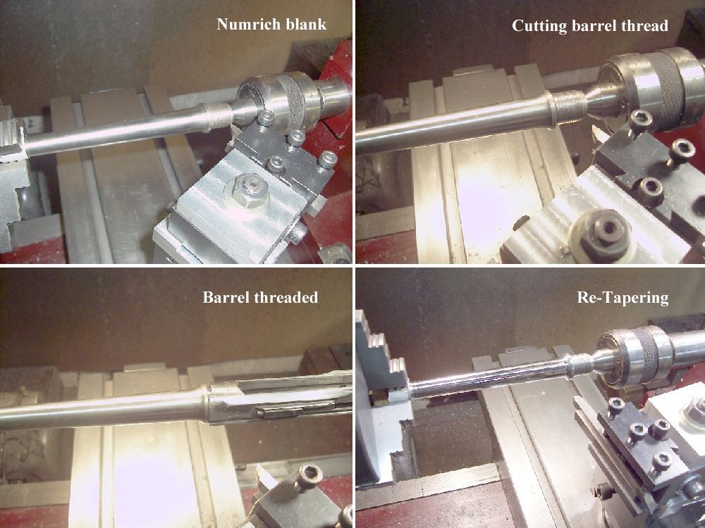

Yes, as John noted, I cut the threads on a lathe, feeding the 60º thread cutting tool bit in one thousandth at a time, until I get close then I switch to 1/2 thousandth. My tool post is set up at 60º also; that is what I feed in by hand (in thousandths). My table feed is set to the thread pitch, and chuck/spindle speed is lowest I can go.
I don't know if anyone makes a Luger barrel thread die or tap. In any event, trying to thread a barrel with a die wouldn't get it concentric with the bore, as John commented.
I have pics of the threading process before & after, but I can't take pics while threading. I need both hands free to throw the appropriate levers to stop the feed and retract the cutting bit at the end of the cut.

I do thread these on a lathe...
Here's the receiver end of the barrel being threaded, ~.704" x 20 tpi...
I've also re-tapered the 'fat' taper...
Next will be threading the muzzle end...I'm still deciding whether to make a threaded front sight base + band or saw off an old Luger front sight base/band and thread it...
