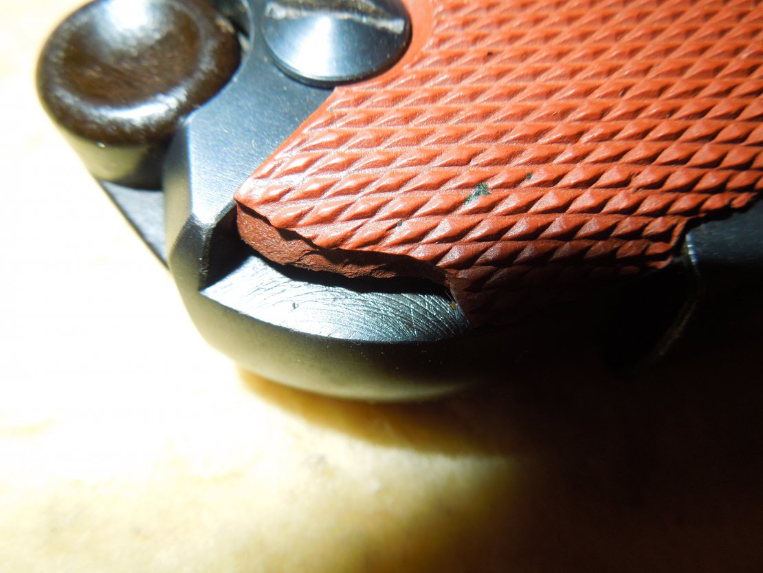

Is there anyone on the board that has a way to repair the early Red 1906/29 Swiss Plastic grips?
I recently acquired one, and it has a chip out of the left grip near the base:
What material are these grips made out of?
Thanks, Marc

Google "Bakelite repair".

Unfortunately, there is no real good Bakelite repair.... the method of fabrication make this a tough nut to crack... the best is probably epoxy painted... Check some of the web sites concerning old radio repairs.. these guy can do the best with what available today... best to you, til...lat'r...GT...

I know that the later (post 1938) Swiss grips were bakelite, but I don't think that these are.
They look more like some kind of dense plastic.
Looks like it's called Canevasit Resin or Canvasit Resin or Canevasite Resin.

I think a tinted epoxy would probably work out best. Mohawk Chemicals makes a variety kit of powdered tinting pigments. It will take a little patience to experimenting to get a good match. Then build up the material again, work down to proper shape, and blend in the checkered pattern. I wouldn't shoot with them.
You may remember the Red Swiss grips I made a while ago by modifying and re-checkering a cast urethane pair which were originally molded from a pair of those extra-thick and extra-coarse grips Mauser applied to a lot of the 70s' production of Swiss frame guns. I sent a sampling of pics of Red Swiss grips to the grip casting company, and I was impressed how close they came in matching the color.

What you called red plastic grips really was "CANEVASIT" some sort of extremely fragile vulcanized red rubber with the same hardness of bakelite used for early Mod 06/29 for grips and magazines bottoms.
Real "Bakelite" came only a few yars after (1938/1939) with the new brown grips, and around 1942 for black grips.
So those W+F BERN 06/29 Red Grips lugers in practice were only a big mistake made by W+F Bern in 1933, and nowadays we collectors are dribbling after these beautiful "wrong" Lugers.

Another option would be to rfough mold the missing part out of JB Weld or similar compound and then sand/file to fit.

Here's a link to Mohawk powder pigments. http://www.mohawk-finishing.com/cata...asp?ictNbr=130 The one you're after is the 12-color kit, which may seem a little pricey at $93.26, but these pigments should last a lifetime unless you're going into massive production. These will tint or color just about anything. I've desired this set since I worked with it in the 79s when I had a job as a furniture service guy at Louis Shanks of Austin. Louis was a genuine Texas "good ol' boy" and had stories of LBJ, with whom he had grown up.
These pigments would likely work with JBWeld. The disadvantage to painting the repair is that the color would soon be worn from the patch. If the entire volume of the patch is colored, this problem would be solved.
Your repair will need to be opaque, so I'd blend in a solid white base of some sort to accomplish this, then adjust the hue and intensity of the color.

I do have another Swiss with a complete left grip. Is there a way to make a mold from it that could be used to form the epoxy repair?

If the checkered pattern lines up exactly, this might work--but I suspect they won't line up. Consider sending the good grips to the urethane casting place. Their policy is to provide a set of grips for free if you send in a set they don't already have a mold for. Specify the Red Swiss color they developed for me, and you'll be all set. Here's another more comprehensive powdered pigment set http://shop.kremerpigments.com/en/pr...ml?info=491005 Less powder per container, but more overall volume and many more colors from which to start...
