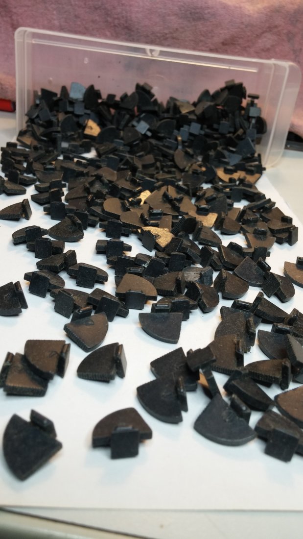

Now, where did I put that Erma front sight leaf?
