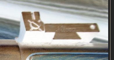

What is the brand on the right side of the rear sight? That may help date its manufacture.
Alan, where does this one stand on the SBR restrictions?
Unread 10-04-2014, 10:49 PM   #7
It looks like a Micro. It looks like it says Micro.

The site says "Micro" on it.
