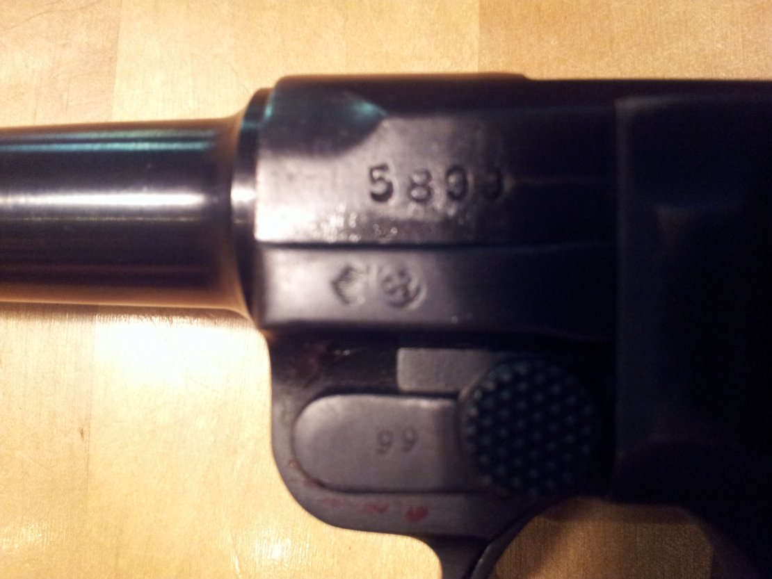

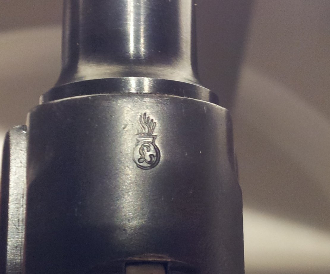

I´ve tried to identfy this marking on a DWM-P 08.
There is a DWM without any year markings.
Is there any one who has an idea what it might be?

A proof house marking I am pretty sure. I do not know who off hand. John
Unread 09-14-2014, 06:38 PM   #3
Does it appear that the date has been ground off? Any other proofs or acceptance markings? Stock lug? Serial number?

Belgian issue
No, there is no trace of any date on the gun.
And there is only that marking.
There is same serial number on all parts on the gun except the barell.
According to one source the barell has been changed.

IMHO The cursive capital "L" inside the proof mark stands for the Liege Belgium proof house. More photographs of the area above and both sides of the chamber are needed to be sure but just with the photo already provided of the top of the chamber I believe the date has been polished off before this proofmark was applied. There are minute traces of polishing or fine sanding visible below the blue in this area and the receiver corner reliefs appear "softened" instead of sharp.
Just my tuppence !
Unread 09-15-2014, 09:20 AM   #7
I agree with John in all respects.
Unread 09-15-2014, 11:03 AM   #8

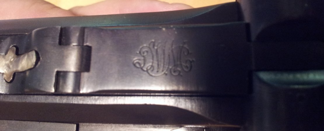

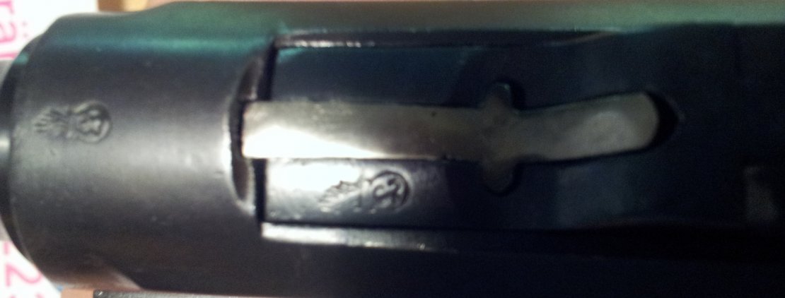

Thanks for the help so far.
I took some more pictures and hope they are in some way helping to get some more information about the back ground of this gun.

Last picture.

The photos suggest a different degree of polish to the barrel than to the rest of the gun. Blued small parts but polished or strawed extractor, and I'm still on the fence regarding whether or not the date has been removed.
More photos, including the witness mark, will help confirm or dispel such notions.

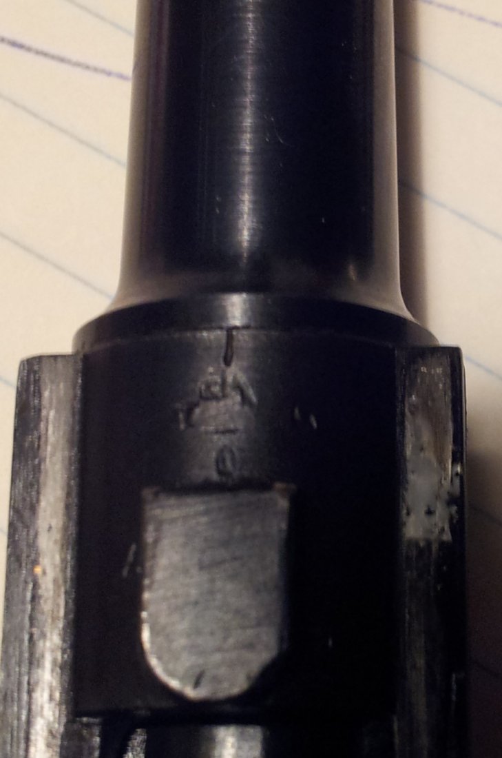

As I understand the barrel is not the original one.
Where schould the witness mark be?
MD650 is offline   Reply With Quote
Unread 09-15-2014, 12:16 PM   #12
Bottom of the barrel... there will be a small notch which should line up with a similar notch on the upper receiver when installed.

Ok, I got it now.
As you can see there is no correct proof mark.
So the barrel is not the original one.

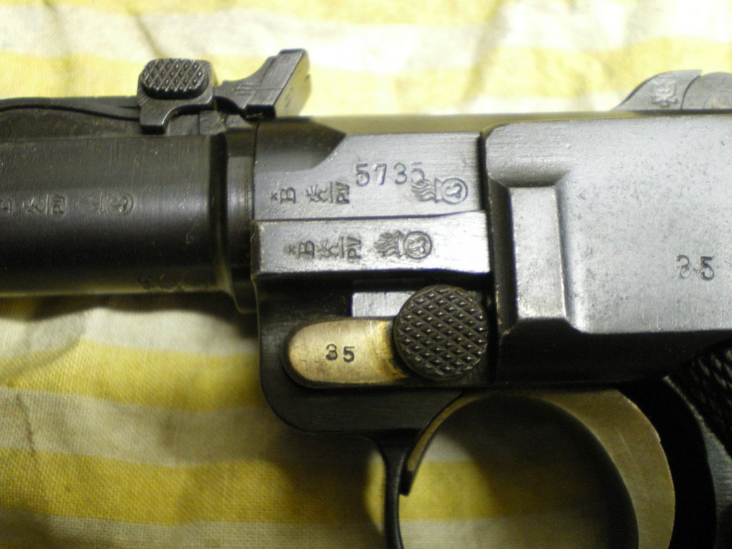

Unread 09-15-2014, 03:34 PM   #14
So we know it has been rebarrelled and refinished. Whether the date has been ground off remains unknown, but my guess it that it has been. The right side MAY show spots where the original acceptance marks were filled prior to re-blue (your 4th photo) and at some point in time it ended up in Belgium.

My first question was about the marking ( the L inside a flaming grenade).

I have a matching AC41 P-38 with the same 'L flaming bomb' proof mark. I suspect it was pulled into service after the war in the rebuilding of Belgium. It also has German export marking 'WAFFSCHU DE 10', then was eventually imported into the US at C.A.I. Georgia VT.
