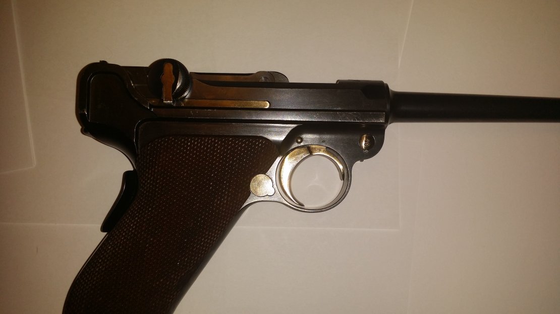

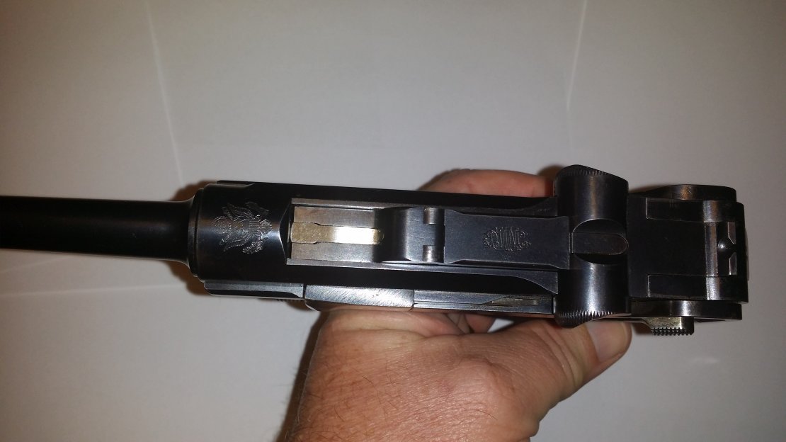

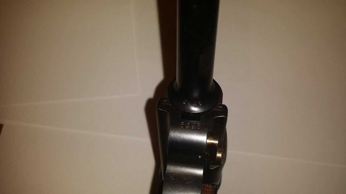

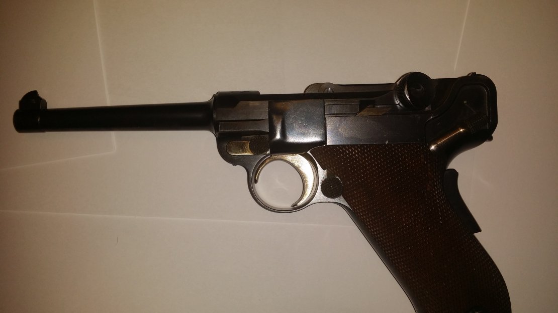

I believe I have a 1900 test luger that I've pm'd Ron Wood to help me identify. I'm hoping someone can help me locate a sideplate that will fit this long receiver model as the current sideplate isn't working and have been told it was from a P-08. I know the sideplate may need finessed to work but what do I need to be looking for to at least get one that is close enough to make this gun functional.
Any help would be appreciated.

Looks nice - a 1900 sideplate is hard to find, not impossible, but not common.
I think the sn is 6448? which would be a bannerman number - 8448 would be too high
I like it no matter what

The side plate is from a later model. A 1900 side plate will have a square upper left corner, not rounded at all, and the right edge of the plate will be flush with the frame. The little L-shaped transfer bar is also different in these early guns, that is why yours does not function properly. Tom Heller (lugerdoc) has quite an inventory of Luger parts and might be able to provide what you need
