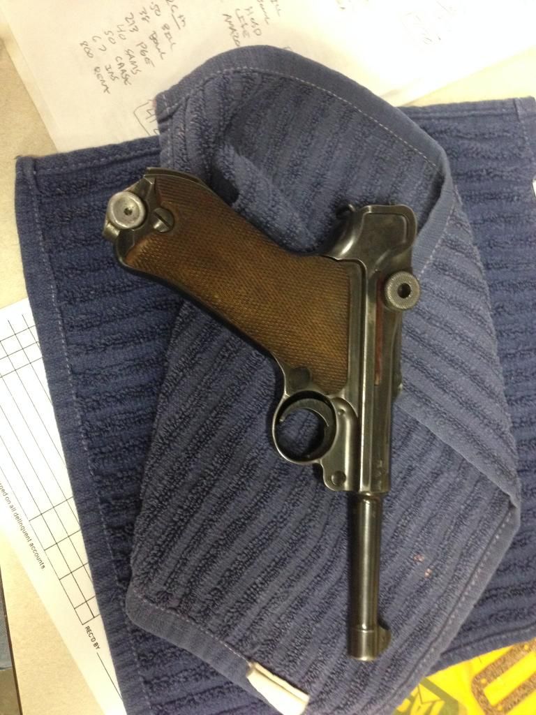

So my coworker has the chance to buy this all numbers matching luger with holster and extra mag. Both mag serial numbers match pistol. I posted it up on calguns and was told to visit here for more info. Any help would be appreciated along with approx value. Here are some pics.

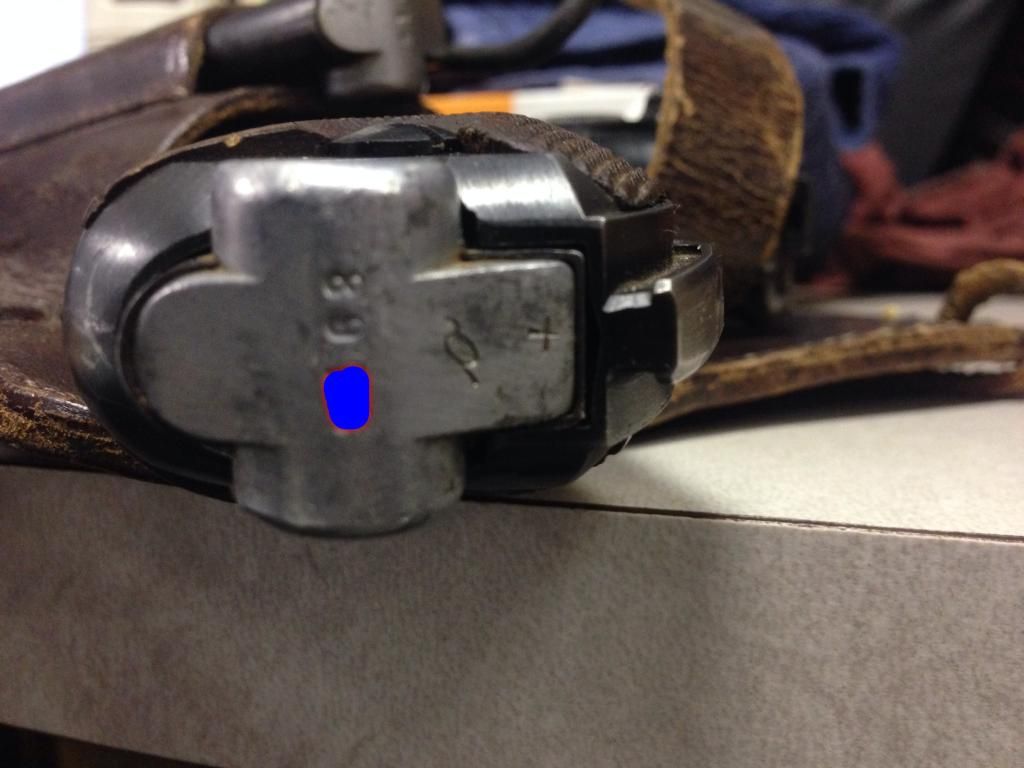

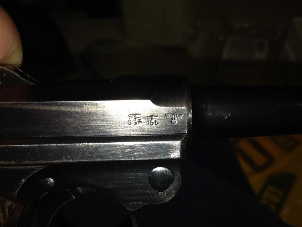

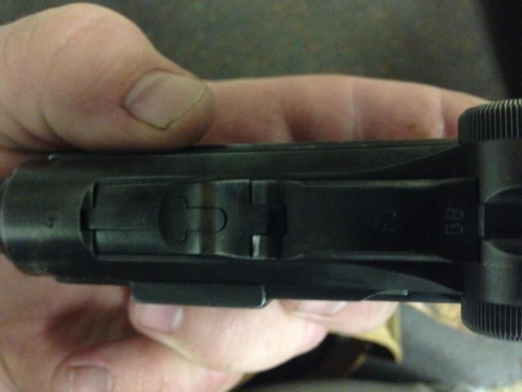

It is a 41-42 Luger .
Unread 08-19-2014, 12:35 PM   #3
Welcome to the Lugerforum. I see this is your first posting.

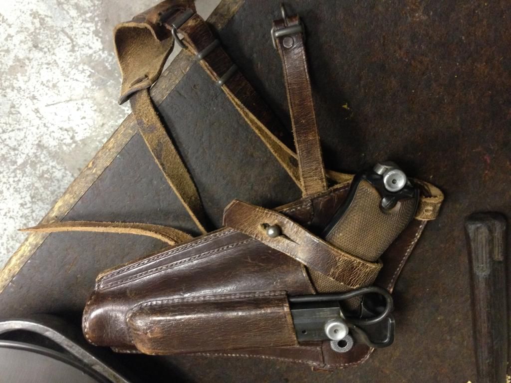

A nice honest looking Military Mauser P.08 (code 42 on the toggle), and made in 1941 (over the chamber). The holster, while very interesting looking, and appears to be period, would not be a German issue item. It is more likely a commercial holster, purchased by a previous owner.
A value? All matching, including all internal parts? ...and the magazine? Somewhere between $1500 and $2500 depending on how bad the buyer would want it, and where the gun is physically located at the time of the sale. It is a nice specimen.

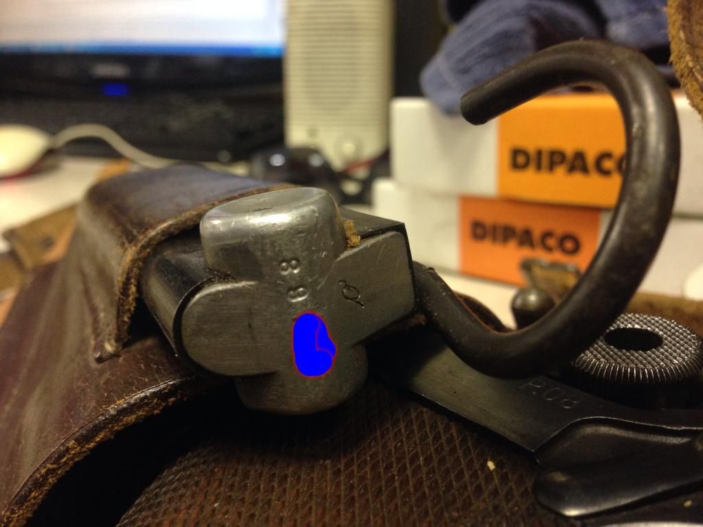

BTW, the script letter "o" that appears on the magazine bottom, is part of the serial number, and the same script letter "o'' would have to appear on the front of the frame under the serial number for the magazine to match the pistol correctly. The "+" symbol on the magazine indicates that it is the "Spare" magazine for this pistol. The primary magazine would have no "+" on the mag bottom. Does the second magazine have a Matching serial number? If so, that would be exceptional. Not often encountered for both mags to remain with the pistol for this length of time. Especially if the gun saw combat.

I pictured both mag bottoms. One is in the gun and one in the holster. They are slightly different. Thank you for the info. You do not think the holster is german?

The holster is not issued by the army or air force.
It looks like a P38 holster that has been modified

While the holster may have well been manufactured in Germany... (or not), it is not a military issue item that came with the pistol at the time of issue. As I stated before, it is likely a commercial item purchased by some previous owner. German military issue leather items such as holsters and belts would have inspector acceptance stamps and a manufacturing code stamped on them somewhere.

If all matching, in original finish and with two matching magazines it would be worth more toward the higher end of what John mentions.
It's very hard to judge finish in flash and underexposed or soft focus pictures. It looks right, but I can't be sure.
Be sure to inspect every numbered part. This would include the inside of the grips (be particularly careful if you remove them. Don't lift and break the left one up near the safety).
The inside of the trigger plate should have a number one more than the first two digits of the serial number. I can't tell you this number because you obscured them in the photos.
You should check the barrel witness mark to ensure it's original and not replaced.
As Ed mentioned, the holster is not original issue German WW-II, and appears to be something sold after market, possibly here in the USA. Are there any makers markings on it?
Note that while your magazines look OK as far as I can see, it's not unusual to find the bottoms of magazines scrubbed and renumbered to match a pistol. It is very unusual to find two numbered matching magazines with a Luger, particularly without the correct German holster and loading tool. Note that as collectors, we are skeptical by nature.

Be very certain that the serial number on the front of the frame also has the "o" beneath it. 2 matching magazines is very rare, and both of those show signs of grinding across the numbers. I'd personally want to see close-ups of each mag bottom and the serial number on the frame. If it is priced right, then no problem, but if it is priced according to 2 matching mags, then look very hard.
Overall it looks like an honest gun.
Those holsters keep turning up but everyone here says they are non-issue. Probably correct, but there are a lot of them out there.

Also, please tell your friend not to store the pistol and mags in the leather holster. Acids used to tan the leather will damage the blueing.
the primary mag looks good but the photo of the spare needs to be clearer to determine wether scrubbed or not.
