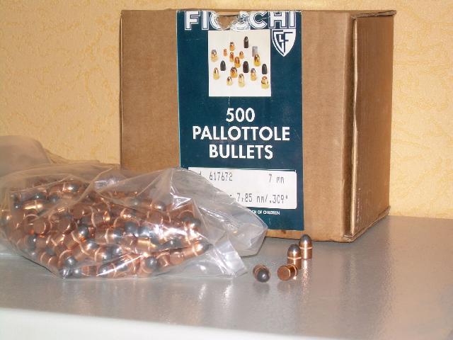

If you can buy Fiocchi nice one's ,
Here the ref and that'all I have about reload :

I sure do wish that I could purchase the Fiocchi 92gr FMJ bullets here in the USA, but I have never seen them for sale here. They would be perfect for my handloads.
