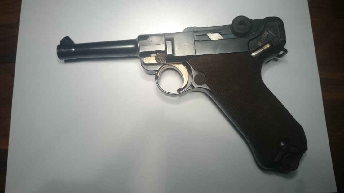

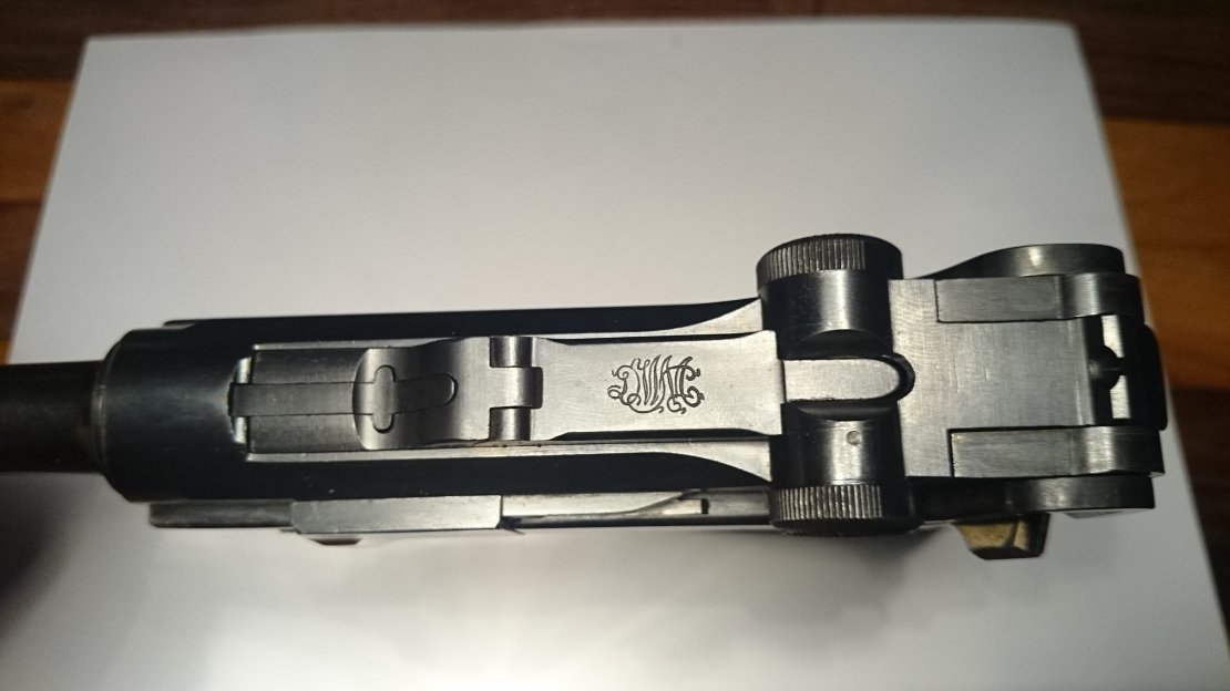

Hi
I am trying to find out more about a Luger that belonged to my Grandfather, who served in the Finnish army. He started his military training in Germany in 1915 (in the socalled "Jägerbataillon"). Later he took part in the Finnish Civil War and served in the army until the late 1920s. Hence the Luger could be from any time from 1915 to 1927 or thereabouts.
I have tried to understand the markings on the Luger, and match them with the information I have found on this excellent site and others. Unfortunately I have not been able to determine what year the Luger is from. Can anyone help me, based on the enclosed pictures? (Let me know if other pictures are required to form an opinion.)
Thanks in advance!
Anders

Hello Anders, and welcome to the forum.
The suffix letter on your Luger looks like the letter "q". See the key on our site at:
http://lugerforum.com/lugermarkings/suffix.html
The full serial number would be "1379q" (S/n corrected per pictures below...)
This Luger looks to be in a very high condition. It was made by DWM in Berlin. It looks like it's marked in the Commercial manner.
Is it in 9mm Luger or .30 Luger Caliber?
Are there any proof markings on it?
If it's a post WW-I commercial Luger, and falls within the Alphabet Commercial time-frame, the "o" suffix would occur in about 1924-1925 (based upon the ones we have here in the USA from that period).

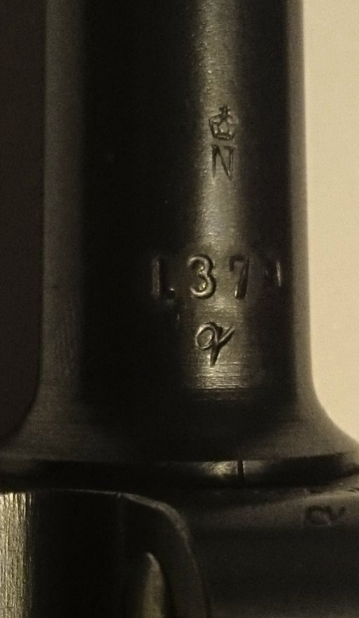

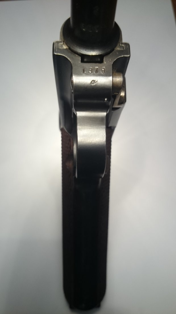

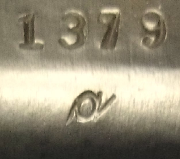

The images I first posted were compressed during the posting process, so the markings were not that clear. Enclosed two more pictures of the markings, which are hopefully more clear. Curiously, I just noticed the letter looks different on the barrel (where it looks like "q" I think), and on the frame (where it looks like an "a"). My inexpert opinion is that the letter is supposed to be "q". Do you agree? What year would that imply?
As you can also see the proof is an N with a crown. I believe that is called "Nitro".
The caliber is 7.65 mm.
Yes, as far as I can judge, it is in good condition. This makes sense if it is from the 1920s, since it would not have seen military action in that case. (My grandfather was a military attache in the 1920's and worked for the Red Cross after that.)
Thanks again for your help! Any further input would be much appreciated!

Hi Anders,
After seeing the barrel markings, I agree with you. The suffix is "q" making the serial "1379q". It looks like the lower tail of the "q" on the die didn't get completely stamped into the frame. The C/N nitro proof confirms that it is a commercial pistol, informs us that it's likely a DWM Alphabet Commercial and pushes the date back. Probably 1926-1927. The halos visible around the serial number on the barrel confirm it's original finish.
Is it possible that your bought this as he left Germany? That could also help account for it's excellent condition...

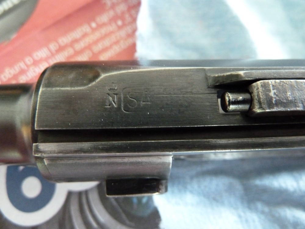

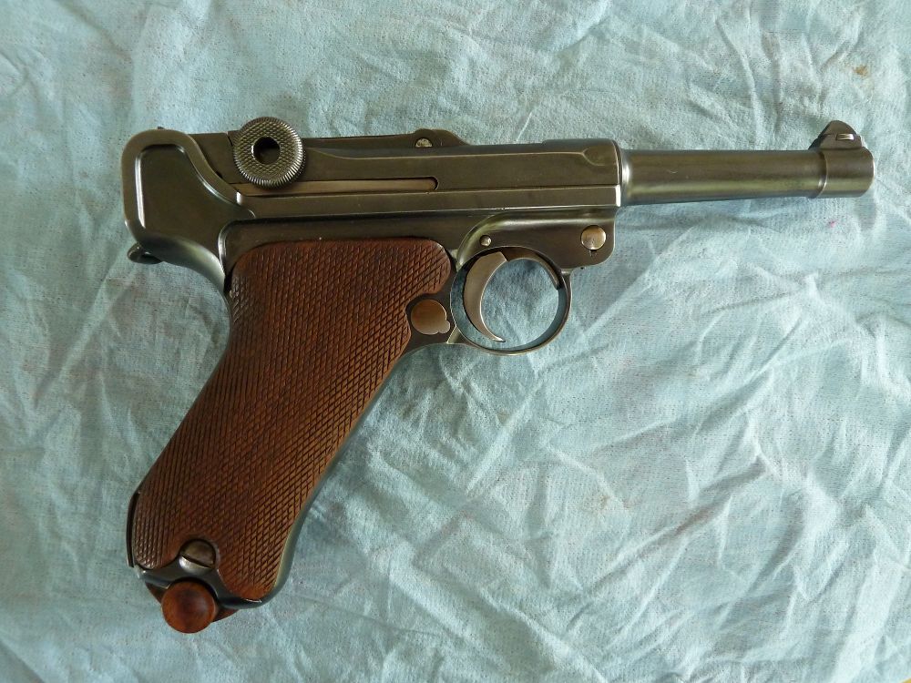

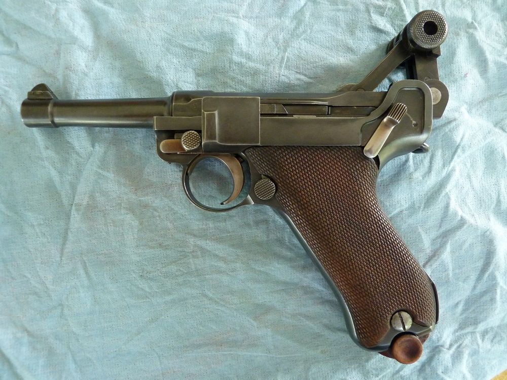

Hallo,

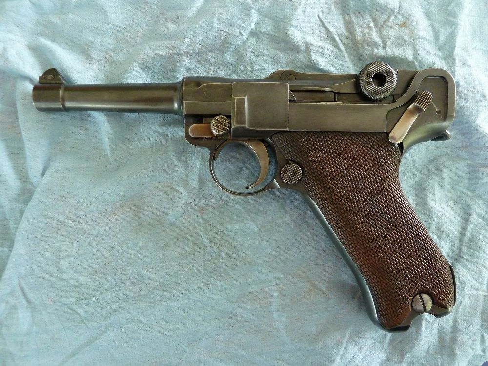

my Luger has serial # 3139q and, as you see from the pictures, it happens sometimes that the "leg" of the "q" is not printed well on the front of the receiver, I suppose due to the fact of the curved surface of the receiver itself.
Anyway, my Luger is also stamped SA near the C/N, because it was issued to the Finnish Army.
Compliments for the conditions of your gun, it is much better than mine.

To implement the discussion here, I want to say that I like to shoot my Luger sometimes, about 100 rounds per year go through it.
