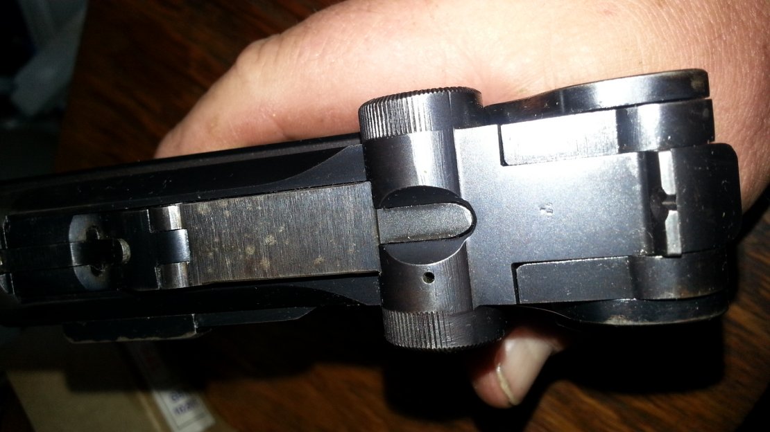

Default New Luger - VOPO?

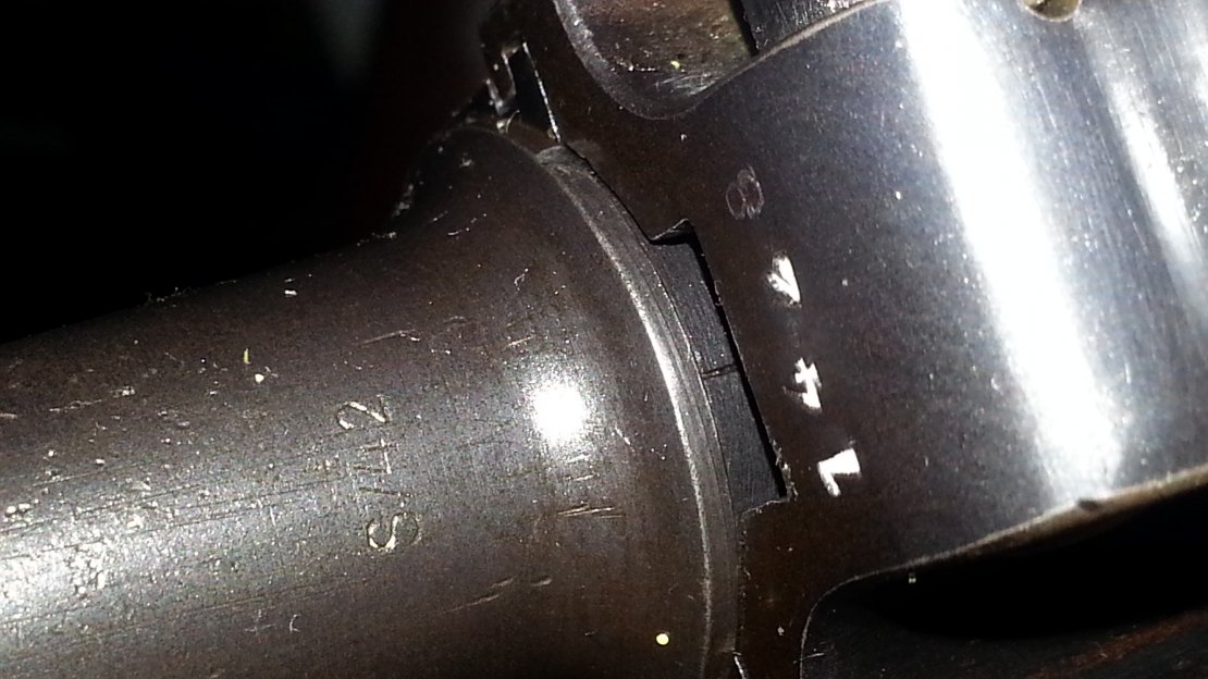

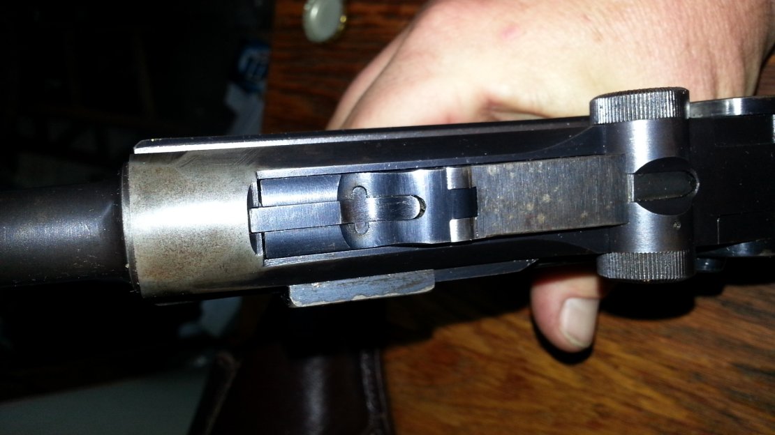

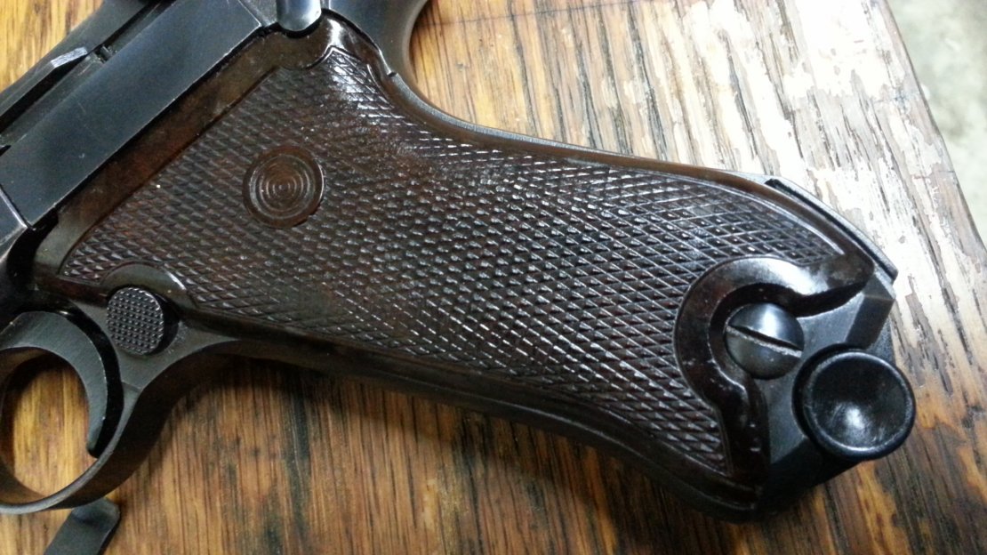

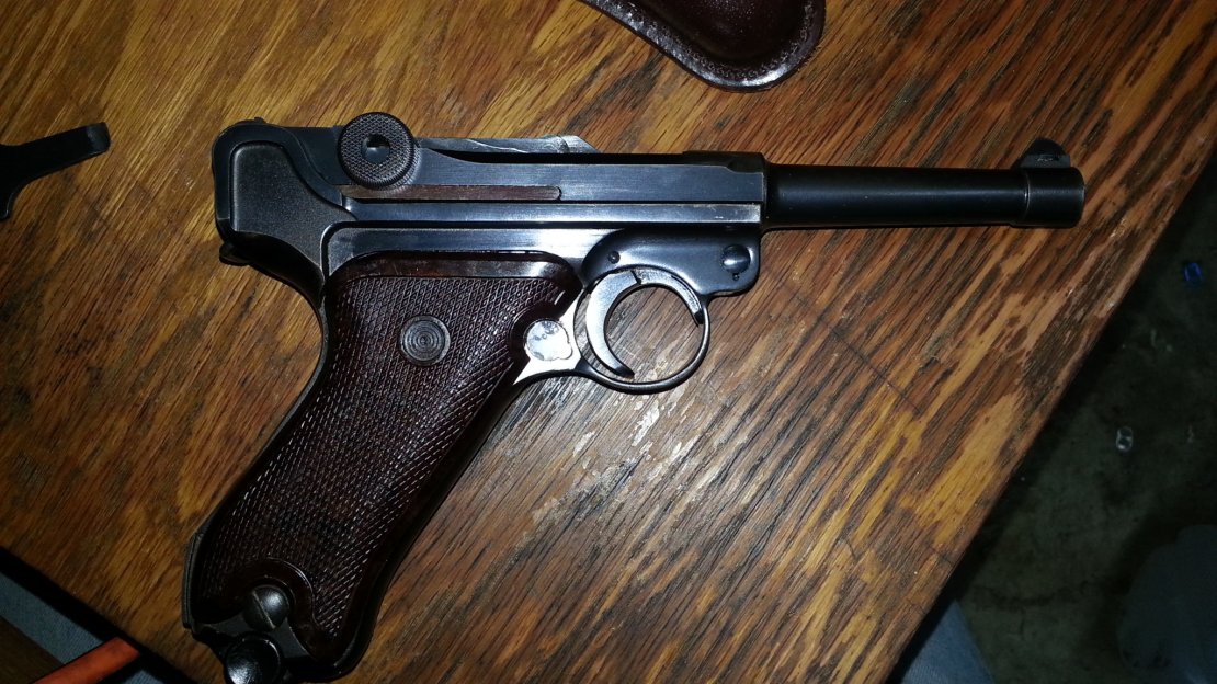

I picked up my 3rd Luger today. It was billed as a VOPO. Only 2 serial numbers on the gun. No date - appears to have been removed and the finish is thin or redone in this area. No markings on toggle. Plastic/Bakelite grips. Holster looks like a reproduction and was told such. Came with 2 mags that appear to be cheap repops of the Ebay variety. (already have 2 like them). Aside from the mismatched accessories, what are your opinions on the pistol itself?

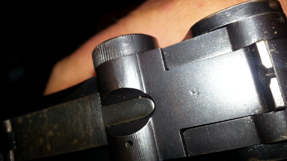

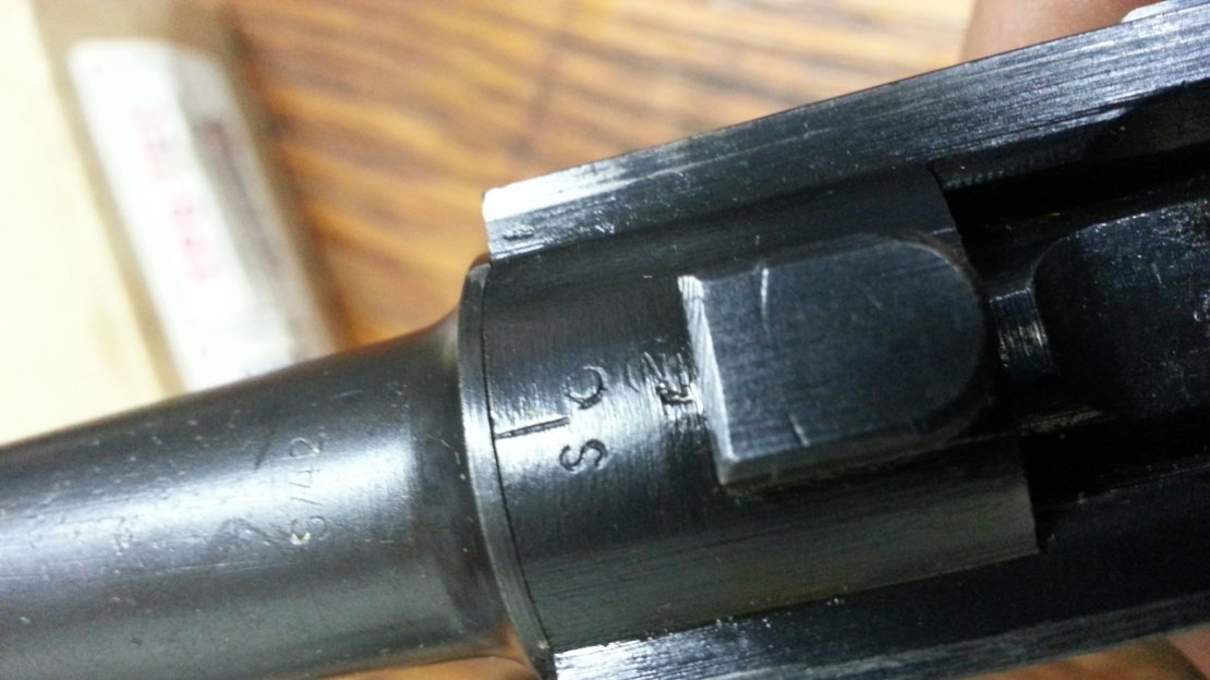

Bore is excellent. Finish looks pretty good. Only a few blemishes. All parts are tight and function well. No rust or pitting anywhere. There is an S/42 marking on the underside of the barrel. Appears to be a small Waffen stamp on the rear top of toggle.

It is certainly a parts gun and the grips are East German. It does not look like a Volkspolizei rework to me as it only has a couple of serial numbers and no DDR proofs of any sort. I would expect to see some evidence of VP proofing if it were an official Vopo arsenal rework.
Unread 06-04-2014, 10:16 AM   #5
This DOES look like a post war East German rebuild to me.
I am not sure why they might have sanitized the maker mark on the toggle, but that toggle has either been milled off to remove the maker mark, or it was brand new EG production replacement part.
The barrel is a Mauser (S/42) replacement part.
The grips ARE VOPO. And if memory serves me correctly, the small number visible through the toggle hole is the same number they put on newly manufactured EG VOPO magazines. The mark on the top of the rear toggle appears to be an inspection or acceptance mark for the work done on rebuilding the toggle train. The photo of that mark is not very clear. Can you take a better closeup?
The number "42" appears on the back of the safety lever, so that is also an armorer's replacement part made by Mauser, probably war stock captured by the Russians.
The VOPO armorers did excellent work, and this should prove to be an excellent shooter.

The mark on the top of the rear toggle appears to be an inspection or acceptance mark for the work done on rebuilding the toggle train. The photo of that mark is not very clear. Can you take a better close up? .

Hi,
Well, it's an interesting Luger.
The S/42 on the barrel would indicate that it is an armorer's replacement made by Mauser. This also is confirmed by the lack of a witness mark being added when it was replaced.
It's missing a little retaining pin in the toggle. This is what keeps the toggle's central axle in place, so be careful about firing it until that pin is re-installed.
I think that the axle itself may be machinist's pin rather than the proper hardened axle pin that should be in the toggle train of a shooting Luger. The issue is one of proper hardening and strength. A soft pin could shear or be deformed. Again, I'd get a proper replacement. (I just saw John's post above, and as I'm not familiar with how the VoPo may have marked replacement parts, defer to his judgement... Still, the retaining pin is missing).
Somebody carefully ground off the factory concealment code marks from the forward toggle. I can't see enough of the profile to tell if the front of the receiver top was also scrubbed.
The "RW" mark under the forward toggle is a Mauser factory approval mark.
Those are VoPo plastic grips.
So, it probably will make a good shooter. I would have someone familiar with Lugers thoroughly inspect it and consider having the toggle axle pin looked at.
Unread 06-04-2014, 09:35 PM   #8
The small number visible through the toggle hole is 0,05 indicating it is a replacement pin .05mm oversize to compensate for wear. This probably explains why the retaining pin is missing, it was either too loose and came out or was never re-installed when the axle pin was replaced. Although the new oversize axle pin is probably nice and tight, a new retaining pin should be installed as recommended. Pretty nice looking gun.
