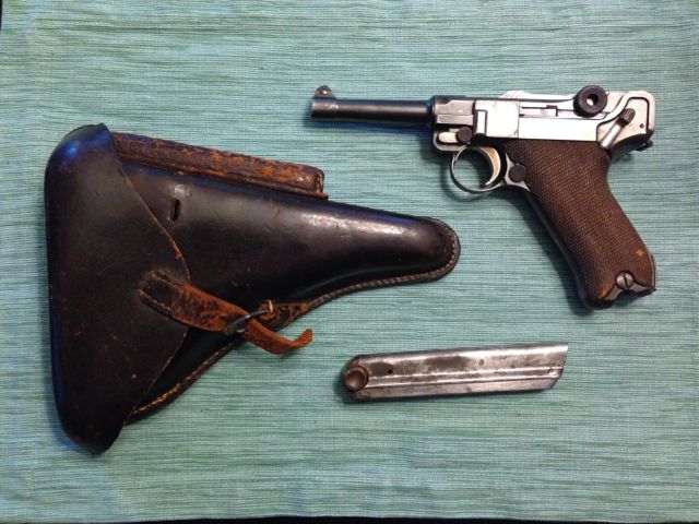

Several years ago I inherited a luger from my grandmother. She told me it was brought back from WWI by her uncle Don who served during that war. I've never shot the gun, but will get it serviced by a local professional gun shop in hopes of being able to take to the range on occasion.
I'd like some help with the meaning of the markings on the gun and holster to see if I can get some history about it's origins. If anyone can help, I'd appreciate it.

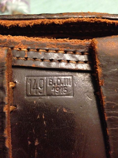

The gun has a holster that is in deteriorated shape. There is a stamp in the leather on the backside of the holster that reads: "149" in a box and "B.D. III 1915" another box.

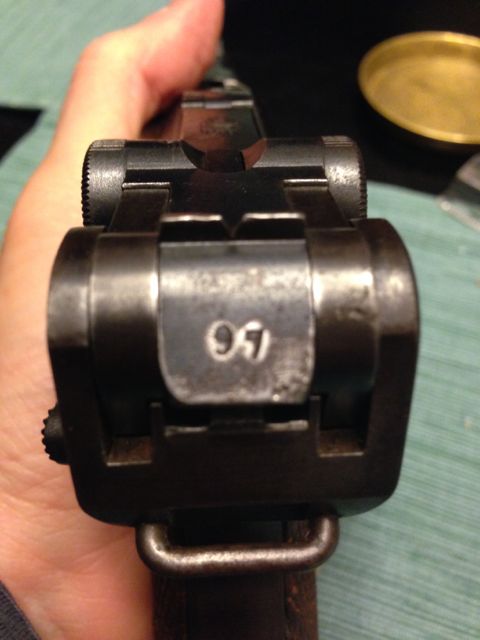

On the pistol there are the following markings:
On the top of the slide action: "DWM" in a script font.

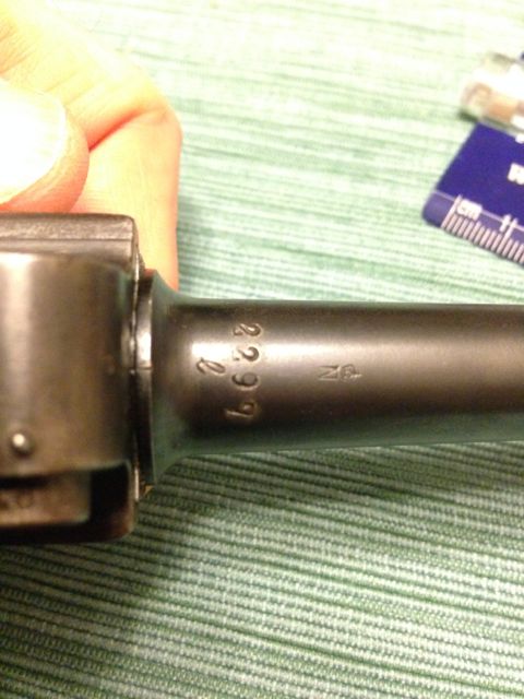

On the underside of the barrel: "2297" and either an "e" or "l" in script font.

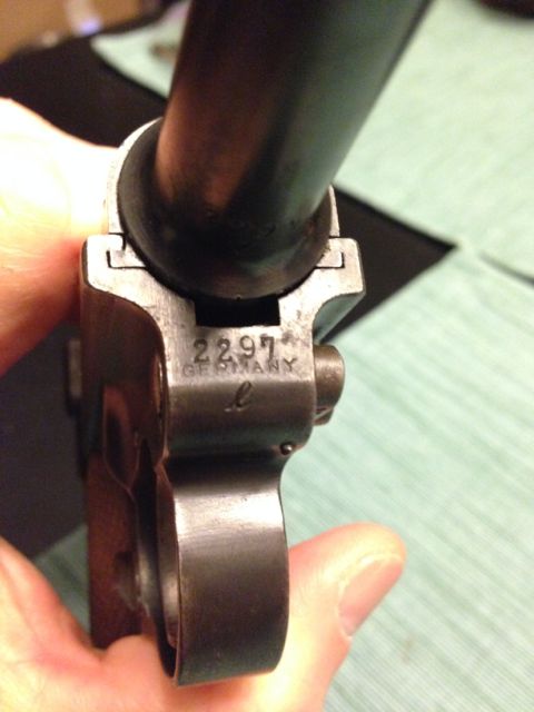

On the body, under the barrel, in front of the trigger guard: "2297 GERMANY" and either an "e" or an "l" in script font.

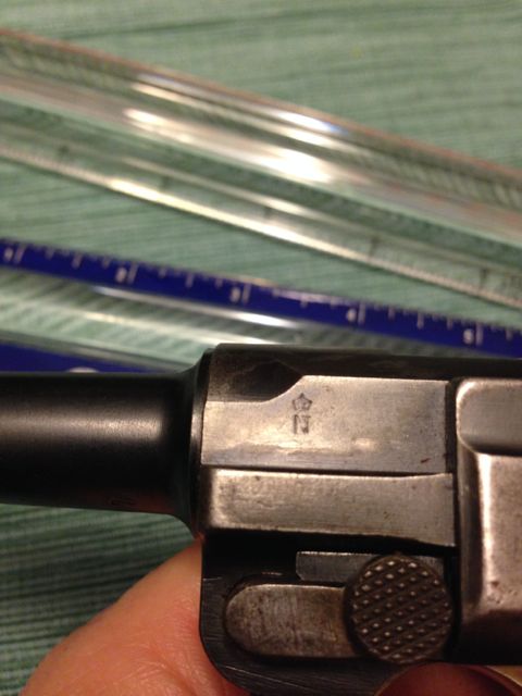

On the left side of the body above and in front of the trigger: A crown and the letter "N".
On the back of the gun above the grip: "97"
On the bottom of the magazine: "GERMANY"
The barrel measures 75mm from muzzle to the body, 90mm from muzzle to the extractor opening.

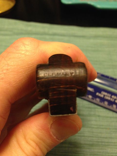

The grip appears to be made of wood, and is "checkered". The magazine plug appears to be wood as well.
The caliber is .30 based on the cartridges that were in the magazine when I received the gun.
Any help in understanding the markings so I can have an idea of where the gun was manufactured, and when, would be appreciated.

Hi Kirk and welcome to the forum.
We have an expert on leather holster restoration on the forum that can probably help you with your holster. I'm not familiar with the marking... Watch for Jerry Burney on the forum.
Your Luger was a commercial rather than military Luger. It was manufactured for export from Germany to the United States in about 1923. The variation is commonly called a "DWM Alphabet Commercial" Luger. The Crown over N (C/N) symbol is a commercial Nitro proof mark.
The full serial number is "2297l" and the suffix letter is a "l" as in "lima" character.
I think that your Luger is in it's original rust blued finish, but someone has cleaned all the cream colored paint from the "Geschert" safety mark from the receiver.
Another member, Hugh Clark or Gerald "G.T." may be able to help you get the left grip repaired.
Be careful taking this to a regular gunsmith. Very few are actually familiar with the Luger mechanism and several subtleties associated with it and it's tuning.
This would normally be a .30 Luger caliber handgun.

You have what we know as an "Alphabet Commercial", made in the 1920s. It was manufatured by Deutsche Waffen und Munition Fabrik in Germany for commercial export to the United states, (The "Germany" stamp was only applied to guns destined for the US market). The idea that it was brought back from WW1 would be a family legend, not based on fact. still, it is a nice, original commercial gun. I have never personally seen that holster manufacturer's stamp, but one of the leather experts will chime in on what you have there.
