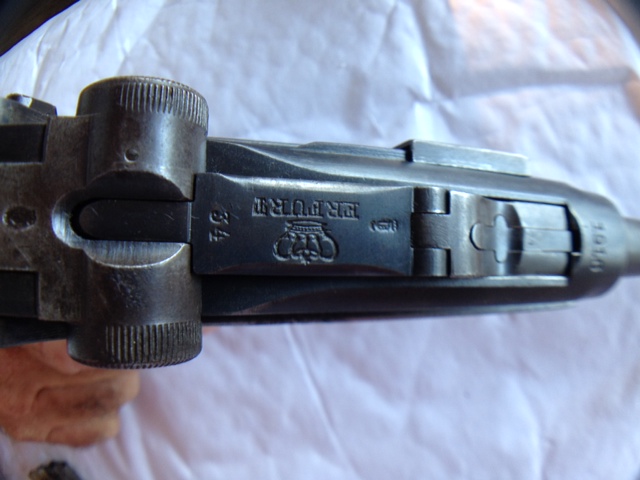

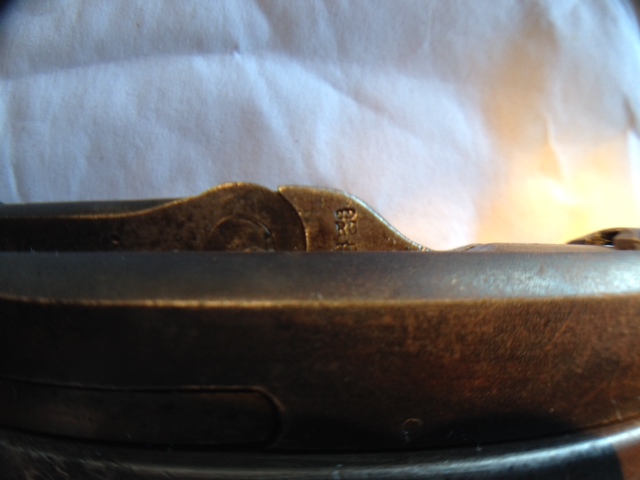

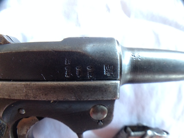

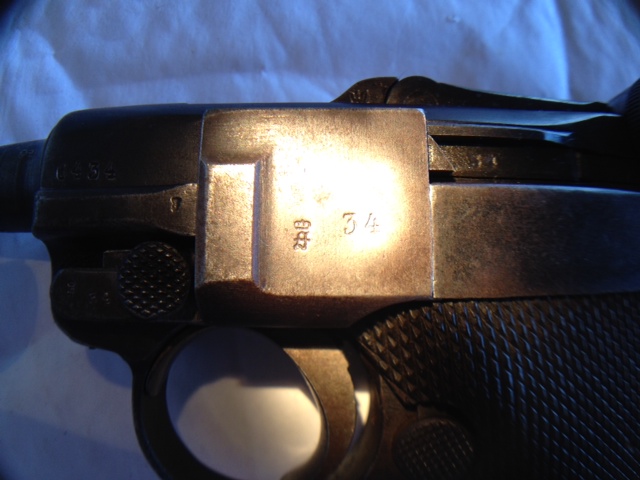

I'm trying to identify the Unit Markings on my Luger P08. All match (apart from the magazine). The gun is dated 1916, and the number 34 features on all parts. The number 6434 is also present on some parts. I have attached some photos, but can post more if needed:
I will be very grateful for any help with this.

You have not shown us anything we would regard as a unit marking. I think you may be confusing inspection and proof markings for unit markings. Unit markings are usually hand stamped on the pistol's grip area.
That being said, you have a 1916 dated Erfurt Arsenal pistol that appears to have its original finish. Erfurt tended to inspection stamp everything down to the grip screws. The "buffed" appearance seems to be typical of these guns versus the much crisper edges of the DWM guns.

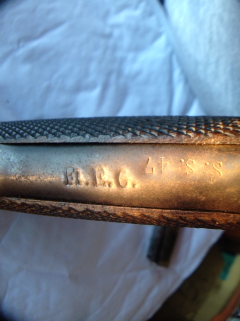

Ah, thank you. I know nothing about these! Here is an image of the hand stamped markings on the grip are.
I can make out: S.S. 47 F1.E.C.

The S.S.47. looks like it might be a police unit mark. Which means Schutzpolizei Schneidemühl waffennummer 47. Which was the protection police of the Schneidemühl district weapon number 47, per Don Maus's book History Writ in Steel. The other mark I'm not sure of.

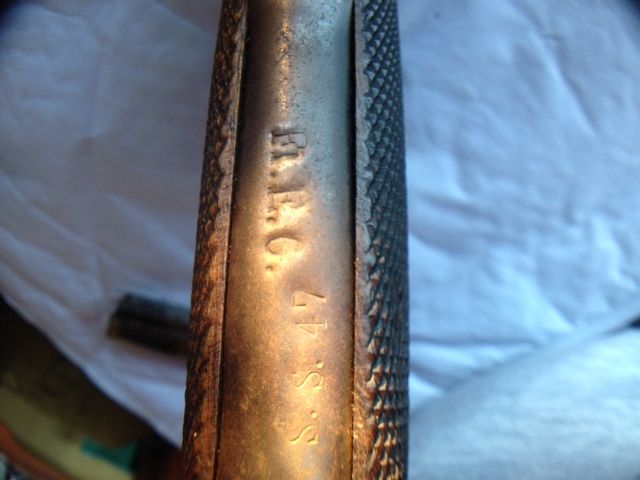

Beazley, If you would repost your unit mark photos so I don't have to lay on my side it would help.

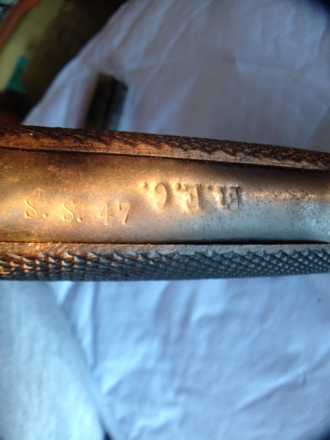

I also read S.S. 47 and F1.E.C. but it should be pointed out that the "S.S. 47" reads one way and the "F1.E.C." is inverted from the first mark, leading to the supposition that they are two separate marks applied at different times.

Here are the photos flipped the correct way for easy viewing. With some guidance I can take more pictures if it'll help. Thanks for all the help!

The pistol probably was issued to a barracked Bereitschaftspolizei unit that was excluded from the order to add sear and mag safeties.
