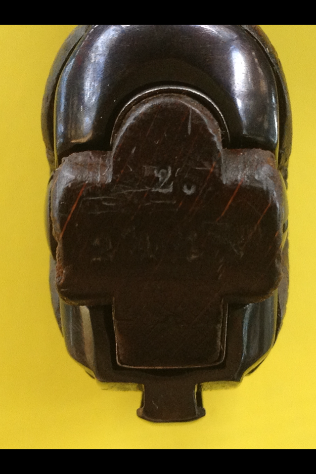

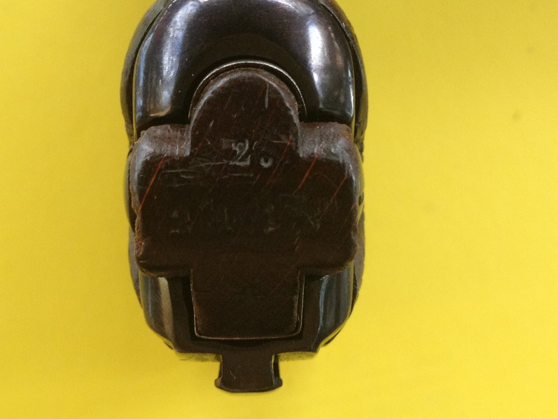

Hi all this is my first post!

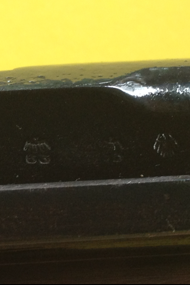

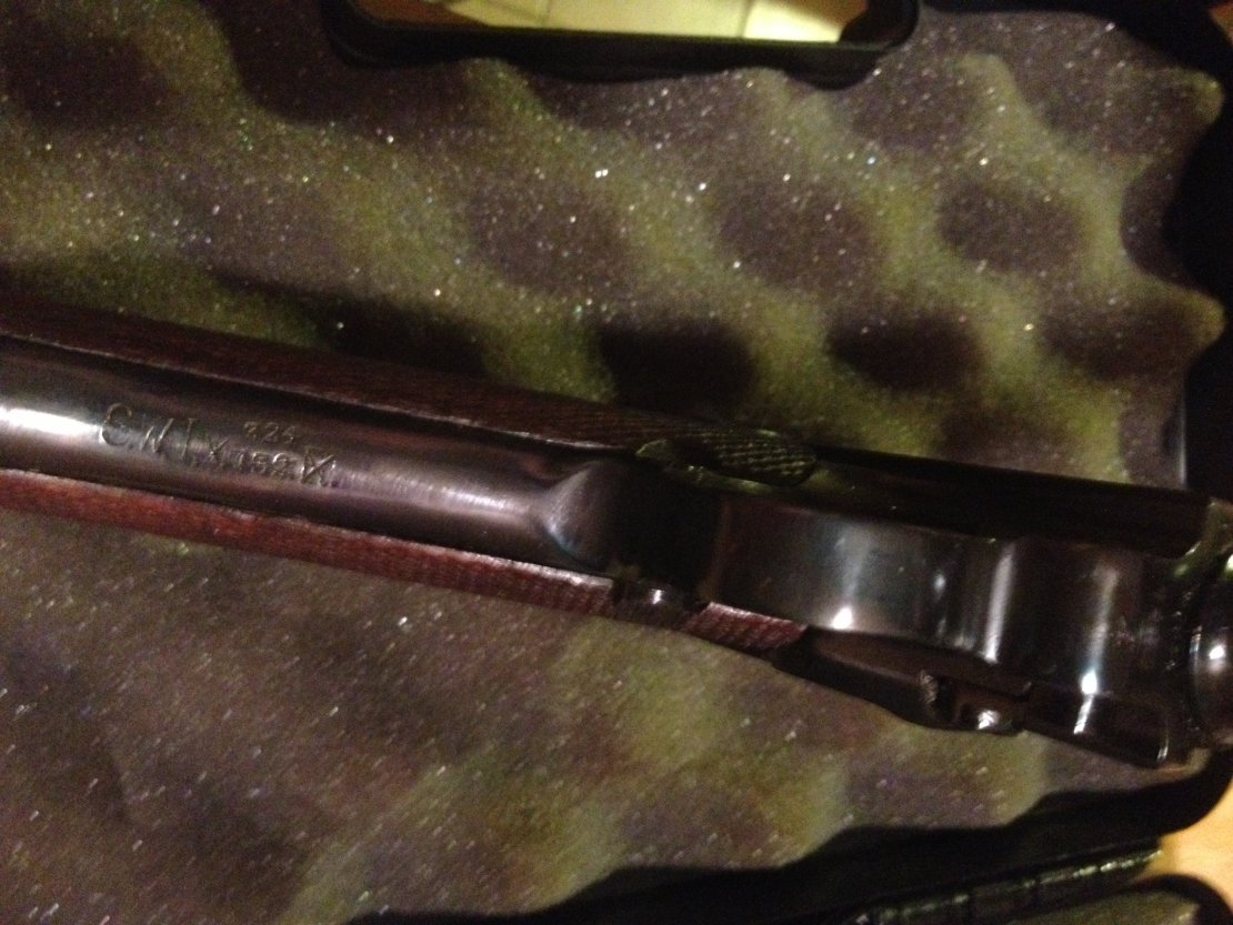

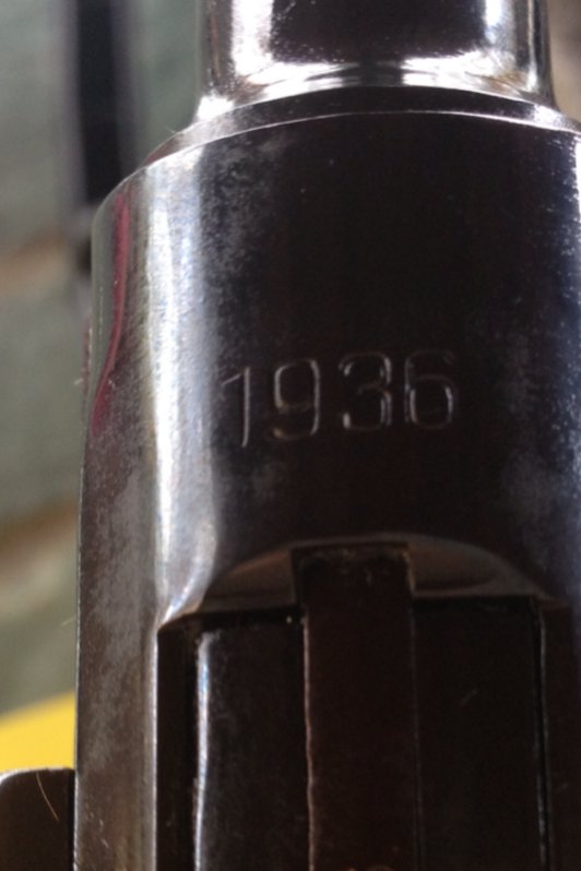

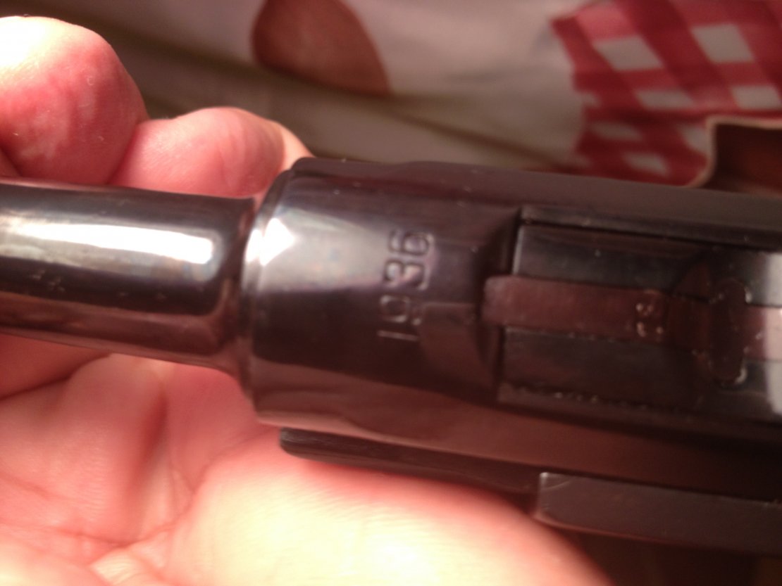

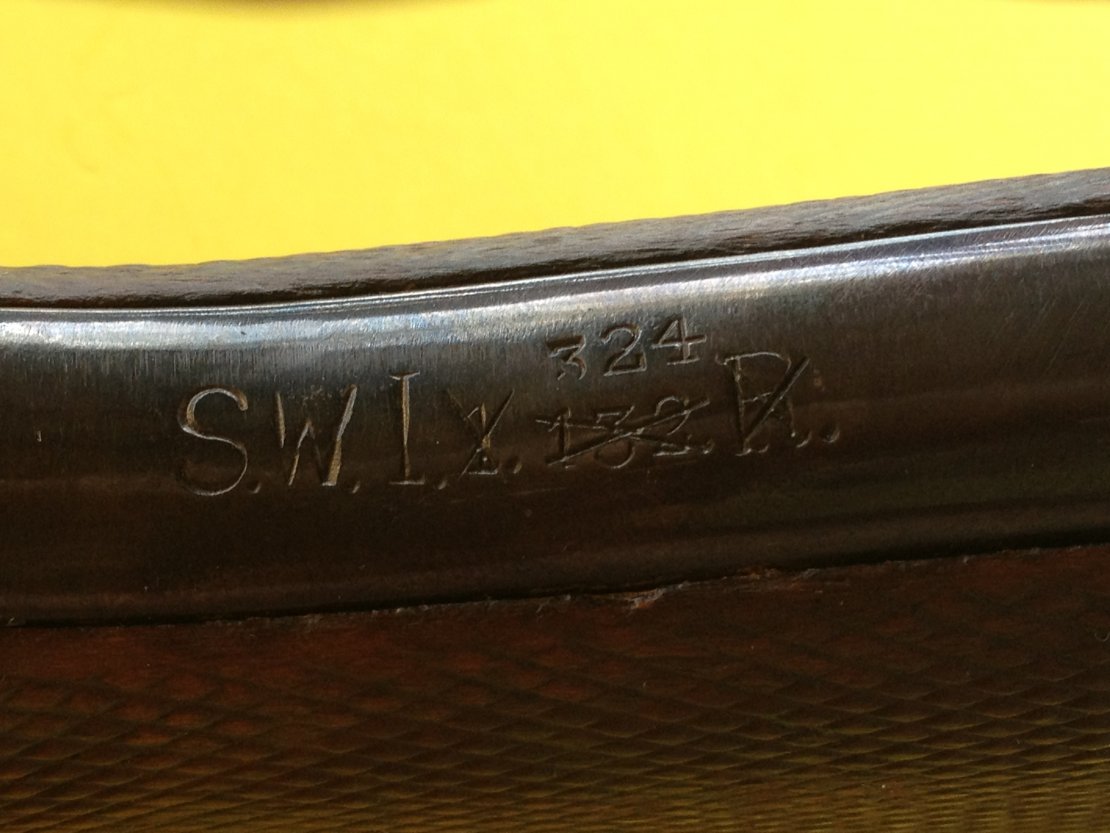

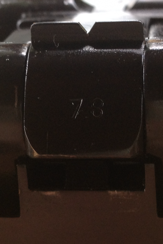

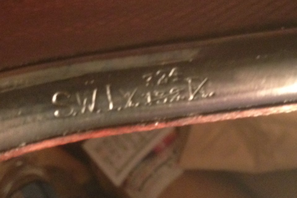

My dad is giving me this Luger 1936 as a gift. It's coming via mail but he sent me some pictures that have me confused. They are some markings (letters and numbers) engraved below the trigger that read like this: S.W.I. 1. 132. R. and there is a 324 in top of the 132. Also some of the numbers are x out (1.132. R.). I am including the pictures that I have so far but if anybody has an idea of what are these markings I will really appreciate your time and input.

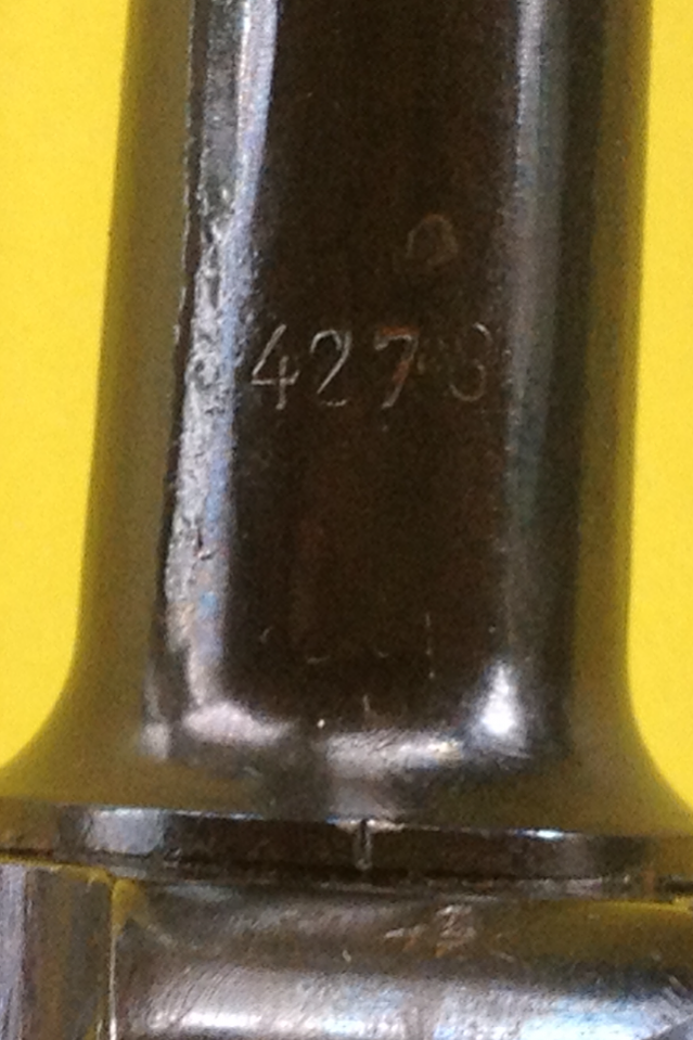

The big questions are, do the numbers match? I bet not, as unit markings were not being applied by this year.
Welcome to the forum
What part of pa?
Unread 04-17-2014, 03:05 AM   #3
Like Ed, I bet it's various parts. A 1936 top cannon and a WW1 DWM frame. It's been buffed & re blued so there's a good chance it's mis matched.

Definitely mismatched. The markings on the grip strap (frame) are those of the Weimar-era Schutzpolizei of Frankfurt am Main in the Wiesbaden administrative district. The original marking S.W.I.1.132.R. is in accordance with the 1922 marking instructions and was stamped sometime before 1932, probably in the 1920s. The second marking is S.W.I.324. and is in accordance with revised instructions issued in 1932.

To specifically answer your question from the first post, the markings on the grip strap are unit markings associated with a Weimar era police unit. Don, the expert, gave you the details in his post above...
These would not have been found on a 1936 era Luger, which is why the others are confident that the gun has been assembled from parts of other Lugers.

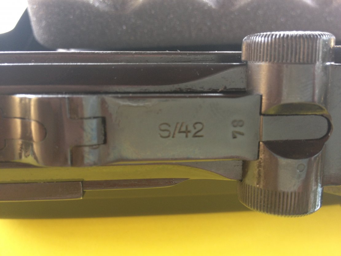

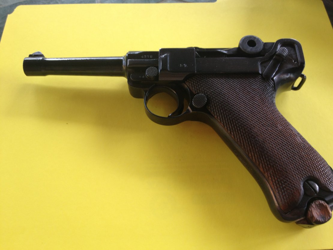

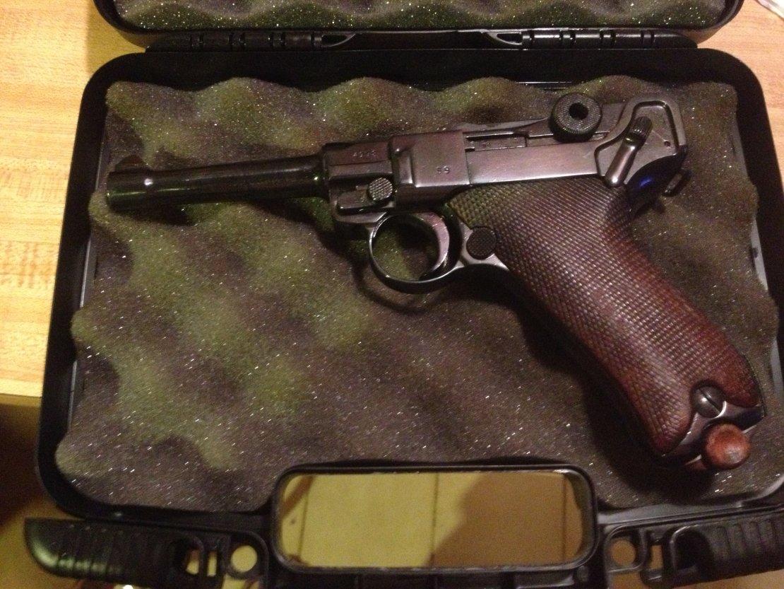

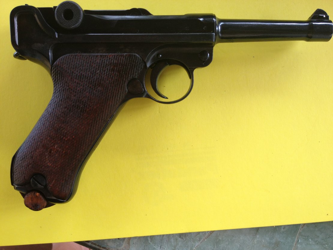

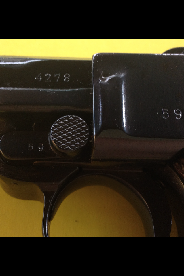

Thank you all for the information. I really appreciate your time and patience with my amateur questions. Thank you Don and Marc for clarifying what was the meaning of the markings. I just got the gun today and took some extra pictures and you guys were right it is a mis match.
I plan to use it as a shooter and will try it soon.
One last question. I was wondering being mis match and then buffed plus blued, what is the value of a gun like this? Other than the sentimental value. lol

Because of it being a mismatch of parts, plus buffed and reblued, it falls into a shooter category and not into a collector category. If it is a reliable shooter, and functions correctly, in my area of the Country it would sell for $7-800. In some areas where a Luger is scarce, a bit more.
