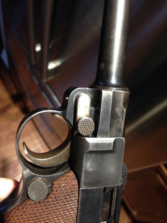

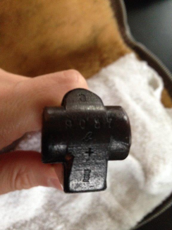

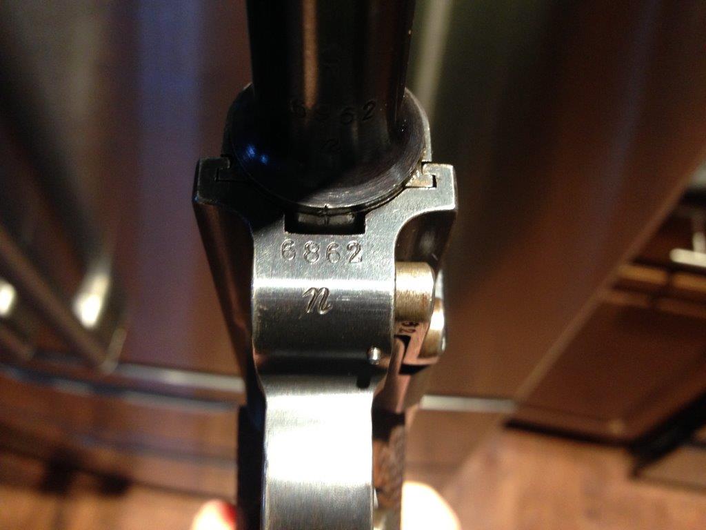

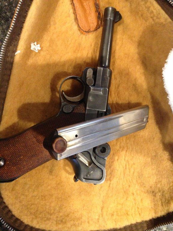

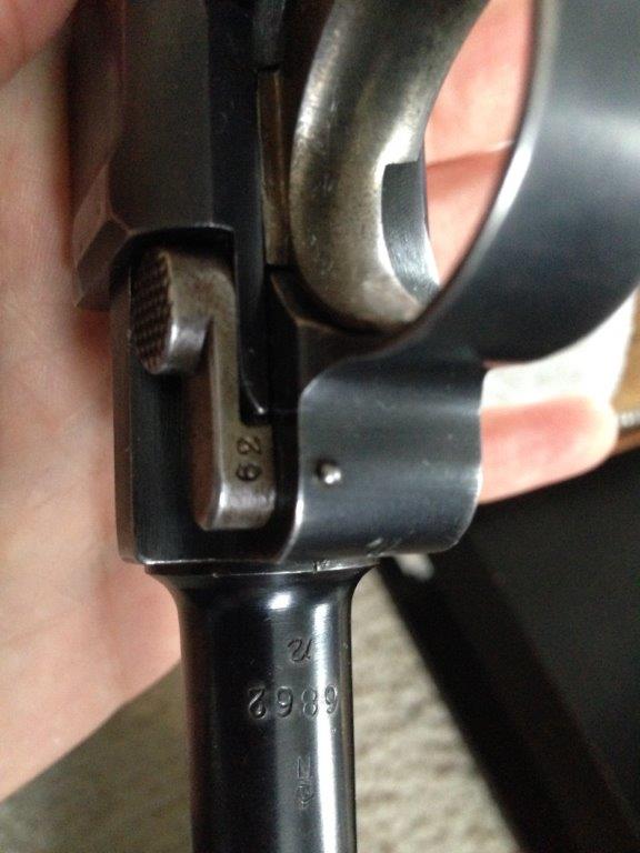

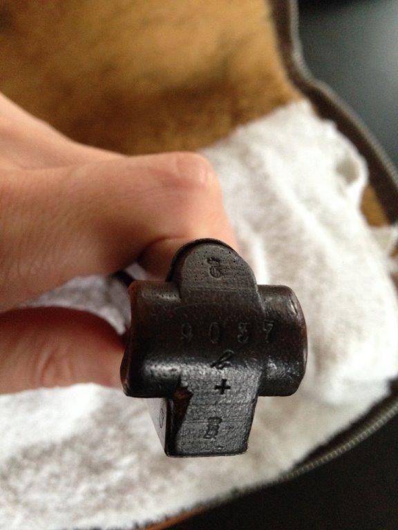

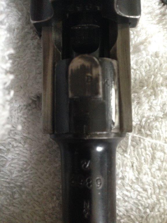

dear all, would appreciate if someone could help me identify the Luger I received as a gift from my father in law this week for XMAS.
I have noticed that the magazine serial and details don't match the guns details/ serials.

I'm certainly no expert, but your pistol appears to be a .30 Commercial, or "alphabet" Luger. The magazine should be unnumbered

I assume its in 7.65mm? and not 9mm?
no date on the chamber - likely a mid 1920's what we call an alphabet luger made for army and police - unless it has 'germany' stamped on it, then an export to the USA
mag number being different from gun is very common
Unread 12-14-2014, 11:33 AM   #4

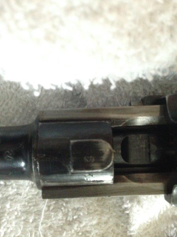

You most likely have a DWM Alphabet Commercial Luger, made in 1923 or 1924. Looks to be in good original condition. The magazines that came with these Lugers were wood bottom, and normally not numbered.
It should be in 7.56 (.30 caliber) Luger. A no. 2 pencil should either not fit down the barrel, or just barely make it in.
If numbered, your magazine is likely from an earlier period.
Looks like someone cleaned it rather aggressively, removing the paint normally found in the safety marking on the frame ear.
The crown/N proof marks are commercial marks.
It may have a "Made in Germany" or "GERMANY" marking, applied when it was imported.

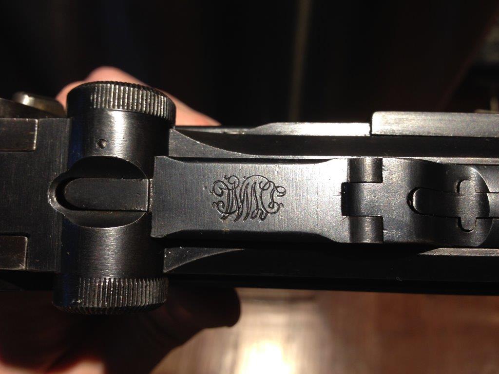

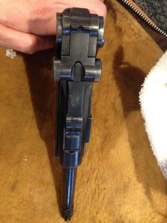

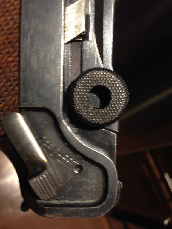

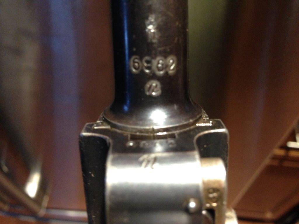

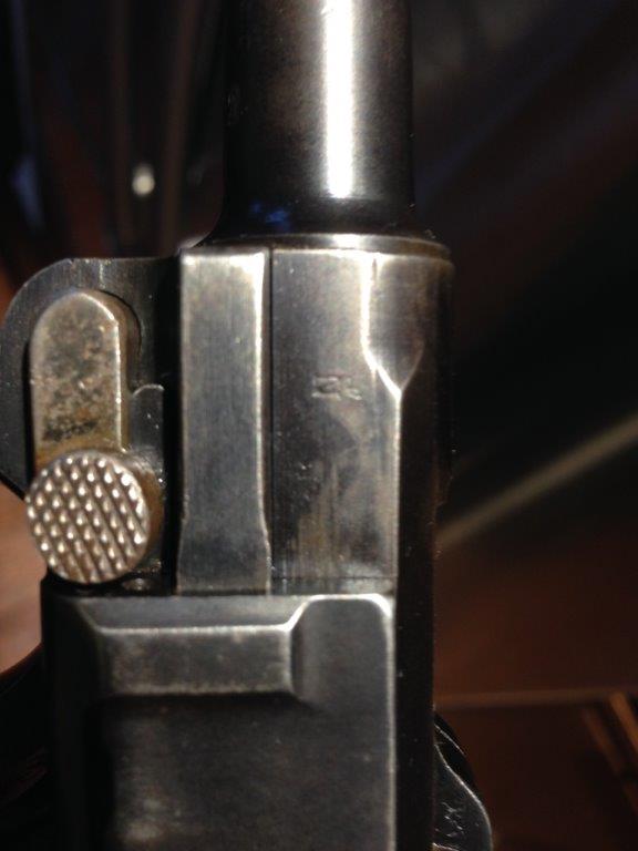

I posted some more pictures, since I don't know much about the Luger's history, markings and other details.

Your magazine is the "spare" magazine (as indicated by the "+" mark) for a WWI Erfurt Luger. It appears to be in nice condition, although in the one photo it looks like there may be a chip out of the top of one of the "knobs". The chip is repairable if one wanted to do so, and even without the repair the magazine has value.
Unread 12-14-2014, 03:36 PM   #7
Welcome to this site made by LUGER enthusiasts.
First of all, lucky you, you got a lovely Christmas present I would say!
It's a 7,65 Parabellum made around 1920's so short after Versailes Treaty that as a consequence of the WWI forbid Germany to build handguns with caliber bigger than 8mm and barrels longer than 10 cm.
Although not that rare, these LUGERS like yours were mainly made for the foreign commercial market.
Those should be the last LUGERS made by DWM (that in 1922 became BKIW and with warehouse remnants assembled "Swiss Comercial" Lugers 1920/1923 with the Swiss "sun in burst" marking and 12-15 cm long barrels.)

I have Lugers, but none of them has the original "straw" color that yours has, on the trigger, takedown latch, etc. So nice to see one with no bluing on those parts!
