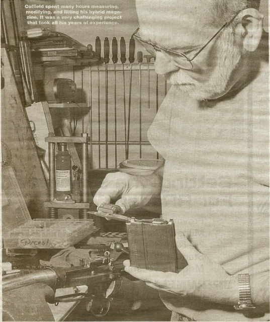

Unread 01-06-2014, 05:04 PM   #15
I got my monthly issue of 'Shotgun News' today, took a quick look through it...Their resident gunsmith, Reid Coffield, has an ongoing article on converting a No 5 Enfield carbine to .223 Remington caliber. I got a chuckle out of a pic, showing Coffield's barrel vise in the background...
I'm not criticizing...It beats what I've used in the past...

Rich, that isn't a barrel vise! It's a machinist's/gunsmith's "work" holder!
