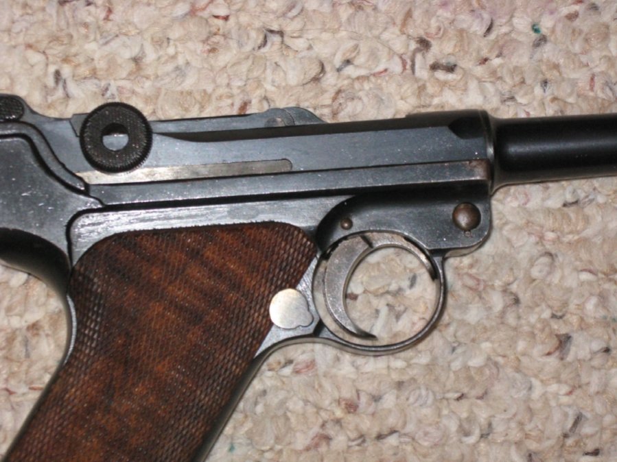

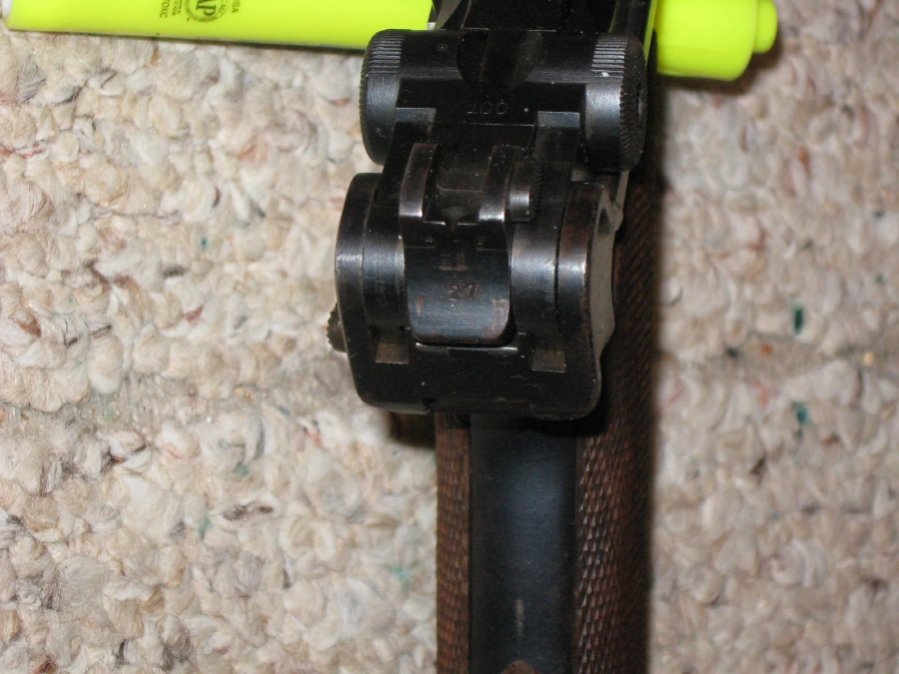

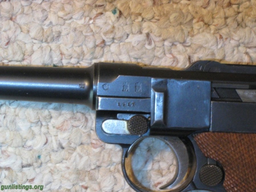

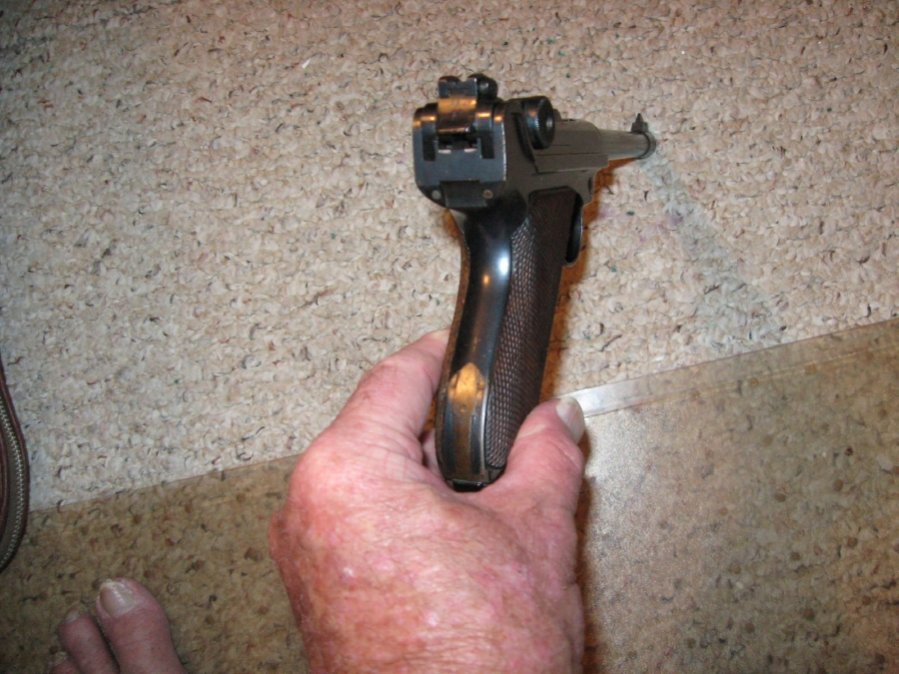

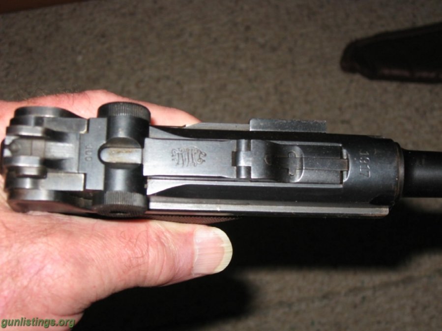

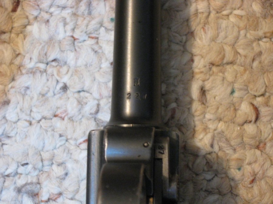

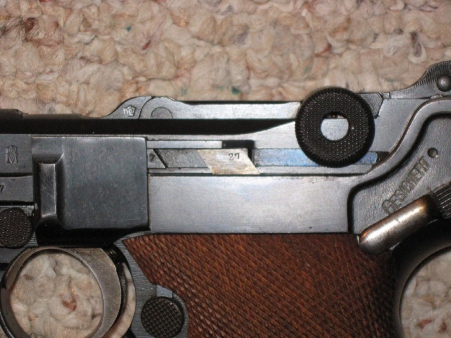

Hi David, 1917 Navy #227 has been kicking around on the market for a while. As you've probably noticed, the stock lug has been ground!
Regards, Norm
Unread 12-01-2013, 09:15 AM   #3
The grips, takedown lever and sideplate are also not original to the gun.

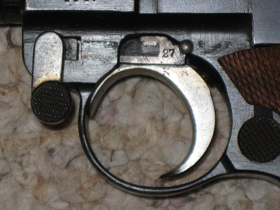

td lever seems to have 27. is that not right?
how did you decide about side plate?
grips seem pretty new. agree.
Unread 12-01-2013, 12:30 PM   #5

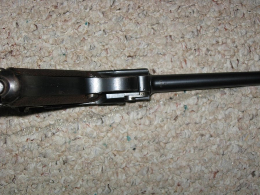

The side-plate does not appear to be numbered (on it's bottom edge), but that may just be the photo. The grips are most likely replacements, as alanint has said, but the take-down lever looks original. However, there is another missing part. Anyone?
Regards, Norm

The loop for the lanyard looks like it is missing.
Paul
PaulP is offline   Reply With Quote
Unread 12-01-2013, 04:48 PM   #7
Paul
Give that man a cigar!
Best regards, Norm

Ed, I think I may have lucked out--$860, shipped. Restored Lugers seem to do OK on the market, and providing that this one does not need much other than what's been mentioned, there seems to be room for restoring the stock lug and lanyard loop. But, for now, it's to shoot and enjoy as is.

Hi David, 1917 Navy #227 first appeared on Gunbroker in May 2011, at which time it was discussed on Jan Still's forum (see link). More recently it was listed on Gun Auction in September of this year. If you bought it for $860.00 shipped you did very well indeed.

Since it is dated on the receiver, shouldn't ALL numbers be in the military style? That's why I commented on both the side plate and TD lever. TD lever is numbered in the commercial style and if there is any number at all on the side plate, it is in the commercial style as well.
Unread 12-02-2013, 06:42 PM   #14
Jan C Still
Posts: 463
Thanked 52 Times in 32 Posts
Imperial Navy Lugers dated 1916 and 1917 are numbered in the commercial style. See pages 124, 139 and 141 Central Powers Pistols.

The seller is a little different from most I've dealt with. The pics in the listing did not show the missing lug or loop--just received one that is appropriate for this, this A.M. It is likely that the lister knew all about these issues and did not mention or depict them in the listing. I think the entire pic series is left over from a previous listing in that specific shots were not provided when requested, but more general ones that just sorta worked. And the name I've been given to send the M.O. to is a woman's, while the person propping up the gun appears to be a male in dire need of a pedicure. Interesting how many sellers take pics on their kitchen floor while they are barefoot.
I needed to tap my IRA to buy this, but could not resist adding it to my legacy. I already have a chunk of rear frame, provided by G.T. a couple of years ago, earmarked to use in restoration of the lug on my LP.08. The plan was to section out the damaged area on that frame and replace with intact structure from the donor frame chunk. So, It appears that I'll need another such frame segment to restore this one, as well, when the time and money come for it. And if anyone has an orphan lanyard loop, I could provide a home for it as well. I'm not sure if it will be an advantage in restoration, but the damage on the frame is less to this one, where only the lug structure was eliminated, contrasted with more extensive grinding on the LP.08, which flattened and thinned the entire area.
