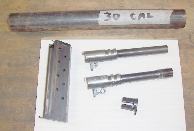

Do you have a Colt Gov't Model in 9mm??? If not, you'll need at least the magazine, slide [complete], ejector, and recoil spring from a 9mm Gov't model for your 45...
I'm wondering if you could just cut the barrel section off a 9mm barrel and tap & thread the chamber section for a screw-in 7.65 Luger barrel...(I don't have mine in front of me)...Not one from a Luger, but a blank chambered for 7.65 Luger and turned to the correct diameter & length...and threaded to fit the chamber section...And I would get a Colt Series 70 collet barrel bushing for it...Dremel or mill the feed ramp...
I don't have much faith in silver soldering liners in (others may); I haven't quite figured out how to keep the silver solder where you want it and not all over the whole barrel...

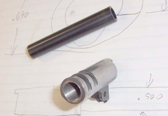

Just got home from work; had a chance to mic my 38 Super barrel and a barrel that I got from Numrich a couple years ago, also in 38 Super...but not for any Colt I ever saw...Muzzle section is way too small for the Colt bushing......
It mic'd .690" major dia in the chamber area; it should take a 1/2" x 28tpi threaded barrel insert OK...I've done these on C96 Mausers & P-38's with no problems...
So, IMHO, if you can locate a 9mm barrel and have your lathe friend turn you a blank & chamber it (and add ramp, ejector cutout, etc) it should take the 7.65 Luger cartridge with no problems...IMHO...
I might try this conversion myself on this Numrich 38 Super barrel...Since I already have a spare Series 70 Colt 38 Super barrel (with Big Bulge muzzle) for my next 80% M1911A1 project...

Unread 01-06-2012, 09:36 AM   #11
Something like this...

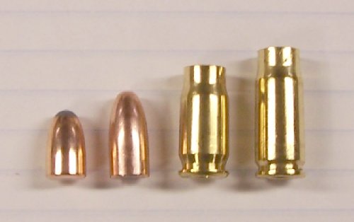

I've used 30 carbine FMJRN bullets for my 30 Mauser, but I drilled them out to lighten them (110 gr with 1/8" x ~3/16" hole = ~86gr)...Worked great!
110gr is a pretty long bullet, though...In the 30 Luger, might be a problem with available space for powder...
Here's an 86 gr 30 cal bullet vs a 110 gr 30 carbine bullet; and a 30 Luger case vs a 30 Mauser case...just for illustration...

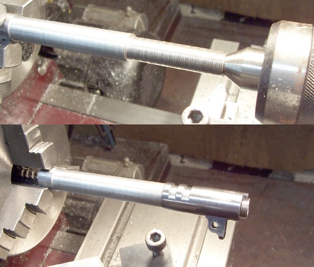

Looks like any runout from the boreline will be of interest as the project goes along, when the tuning of the lockup and barrel bushing is worked. Guess one could always plan ahead and put the newly stubbed barrel assembly between centers...
I don't have a center plate, or a 4-jaw...What I did was cut one end square and chamfer the bore for a live center...then swapped ends and did the other end...Then, with one end live centered, I turned that end's OD, enough to chuck it in my 3-jaw. Runout was ~.002"...I turned the workpiece 120º in the 3-jaw, and it was down to ~.001"...Close enough...I swapped ends and did it again...Then I cut the threads...Took a while to get a nice tight semi-interference fit...Long thread means lots of friction surface...I'll thin down the mid-barrel section & turn the bushing surface later...
I've checked this enough now to know that this can't be done by mail, or over the phone...To make this worthwhile, you'll have to have the pistol on hand, and trial fit everything as you go along...Trying to make it a universal 'fits-all' just isn't practical...
I've never thought about any other custom chamberings for the 45 except for my 38-45 Clerke barrels...Everything else has always been available in new barrels, fairly cheap...

Matt - Even though the barrel is identical to the one already fitted to the Colt Gov't Model, the new barrel will have to be 'fitted'...The locking lugs need to be lined up, the barrel hood needs to be located, the link cutout on the bottom of the barrel (where the takedown lever/slide stop fits) needs to be checked & recut if necessary, the barrel bushing needs to be checked & fitted...
You need the complete package on hand...
In theory, if you had a working 9mm Colt Gov't model and just bored it out and sweated a 7.65 Luger liner in place, it would only need minor tweaking...My way needs major tweaking...

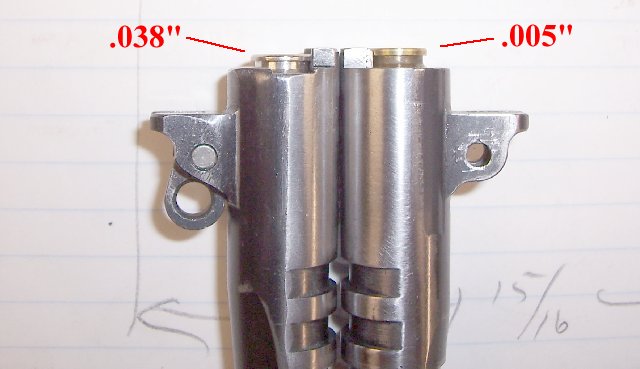

Well, finished turning, milling, chambering, and a [very] little polishing, and this is what I have...(first pic)...I don't have any spare links or link pins (or a 9mm magazine), so I ordered those from Numrich today. It still needs a *lot* of hand fitting to this Colt frame/slide...I might just put it on one of my in-the-white 80% M1911A1's...
...BUT...Whilst (cool word!) I was measuring the headspace on my Series 70 Colt Gov't Model 38 Super, I was aghast (aghast I say!!!) to find it was .038"!!! That's thirty-eight thousandths!!! I chamber my barrels at .003" - .004" typically...
The second pic shows a Winchester 38 Super round in the 38 barrel, and a reload/resized 7.65 Luger in my 30 Luger barrel...at .005" headspace...(I was off by a thousandth...second time...have to check where I'm going wrong)...
The 38 Super case measures .900" exactly (I expect that from Winchester) and since the 38 Super indexes on the case mouth, there is no excuse for Colt to have this much headspace...I've fired it with no problems, but this is definately something that quality control at Colt should have caught...I bought it used, so there's no point in trying to get it warranteed, but I'll have to look into a new Series 70 Colt 38 Super barrel...
