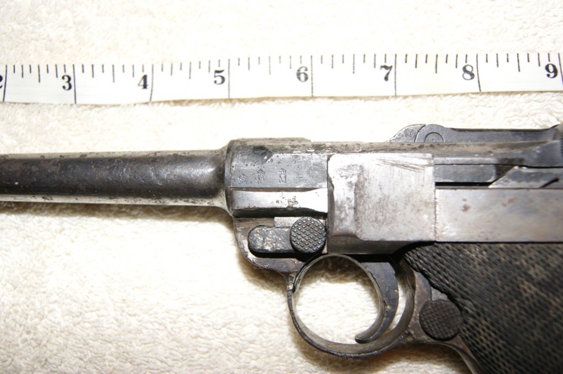

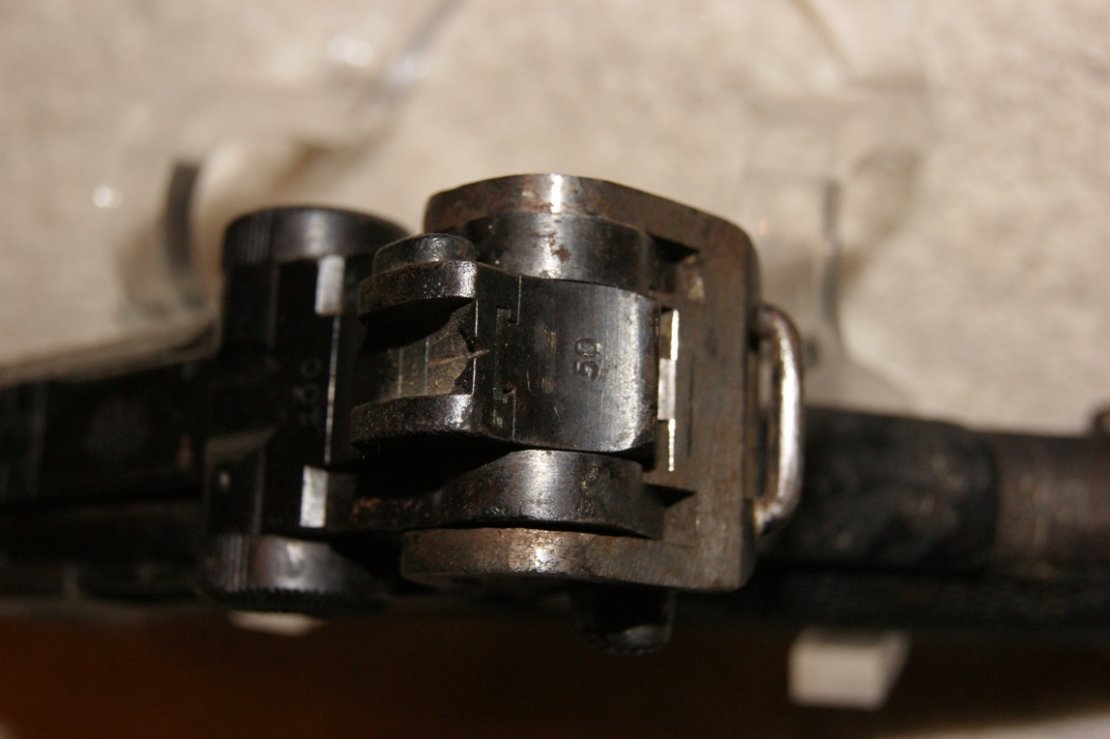

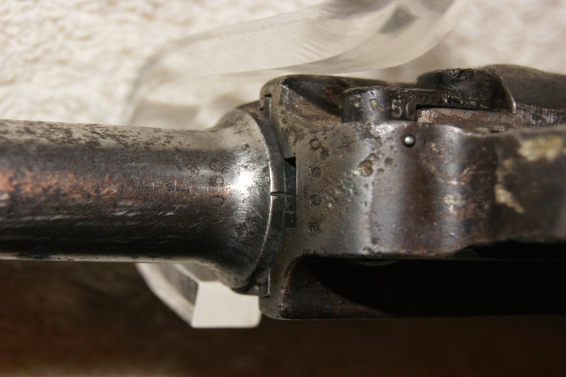

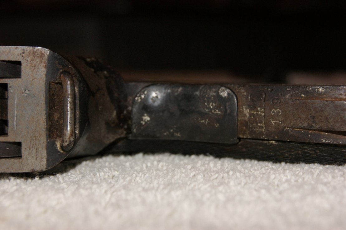

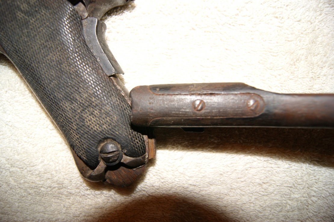

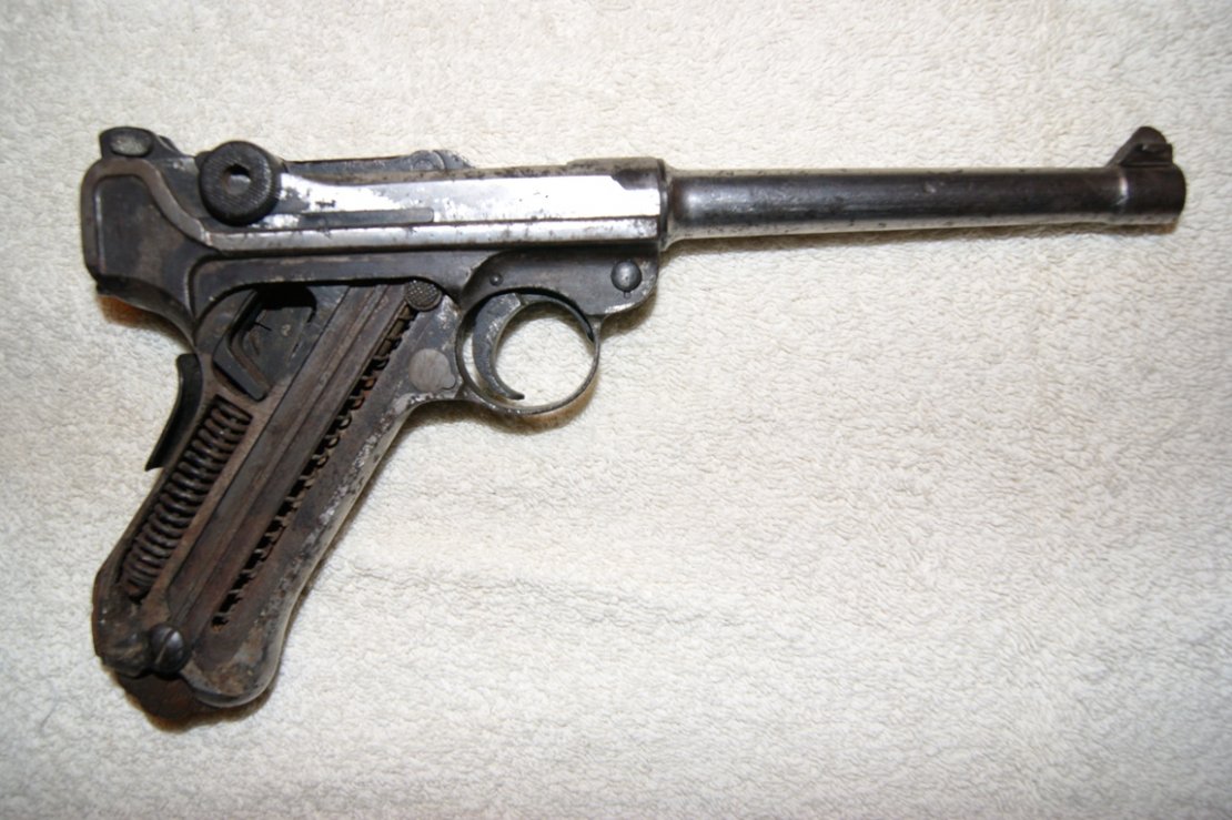

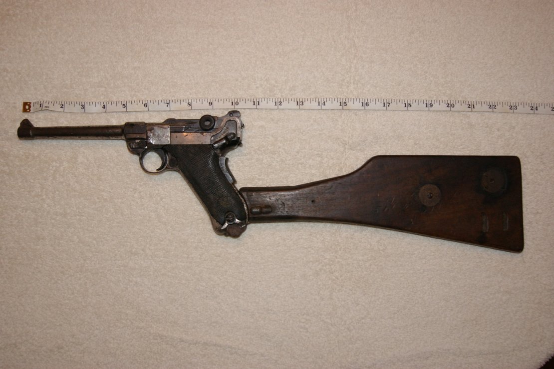

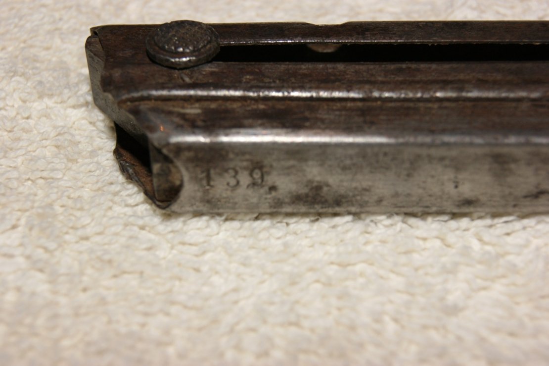

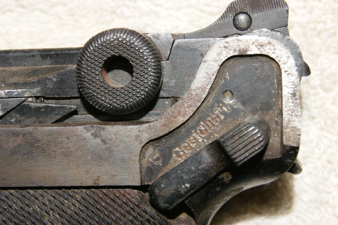

I am wondering if someone may be able to help me. My grandfather brought back a WWI Navy Luger from the war that I have inherited. The luger is a DWM Gesichert navy luger, 9mm, which is represented by a marking M with crown anchor on it. It is complete with the shoulder stock serial number #6050 that matches the gun serial number #6050, therefore the wood stock is original. The barrel is 6". There is no date stamp on the top of the barrel and the shoulder stock and back of the gun has IITD 139 stamped on it, which represents the Second Torpedo Division. I've attached some pictures.
The mechanics of the gun are working. However the overall condition is poor, as can be seen by the pitting and loss of blue. I would be interested in selling the gun depending on the value in it's current state or restoring it prior to selling. However, a few dealers have recommended that I do not restore it as it may lose value and I won't recoup the restoration cost. I appreciate any help.

welcome to the forum. Are you reading notes or? As you seem to already know about it? Sorry to say, but wow, thats in pretty poor shape.
I would think a proper restore would cost several thousand dollars, or most restorers would not accept it, as it will require welding and then proper fixing....
I will take a guess and say that it might be worth $2000-$2500 as a complete rig and that is generous in my opinion?

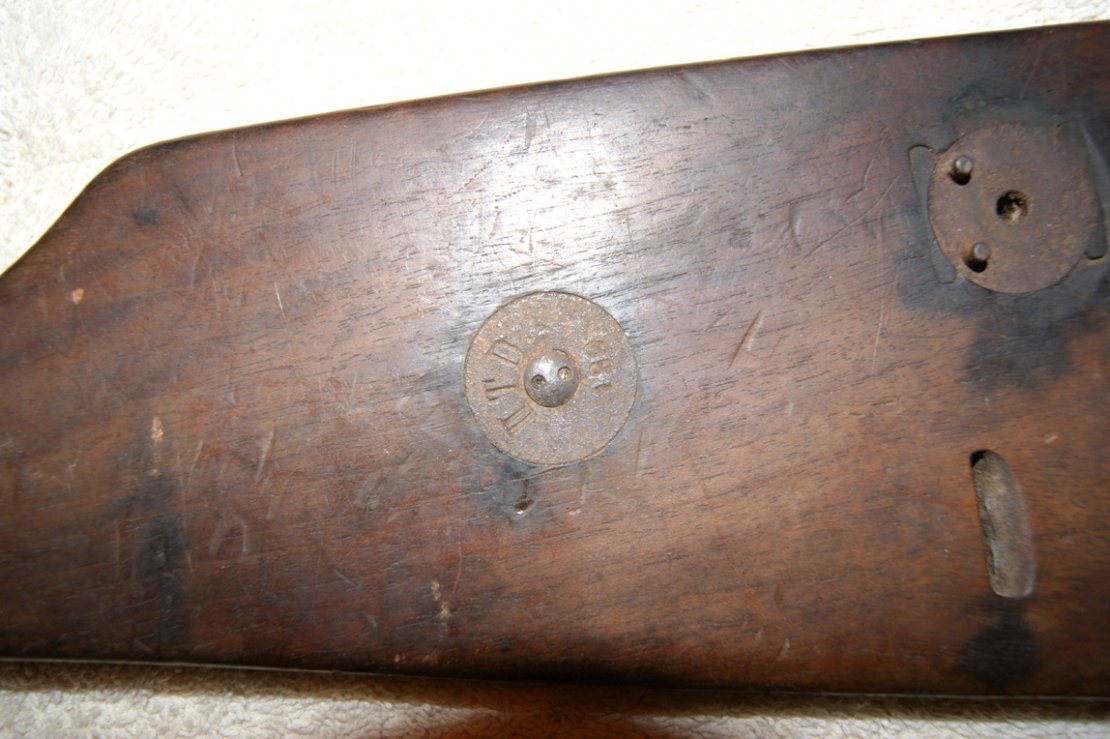

That is one Navy rig of big interest to me: It has the altered stock with the second disc which can only be seen with torpedo boot units (I started a thread on Janīs site some month ago). It is the forth of these altered stocks and in this kind it did not allow to use it with holster and strap. I would like to know what the reason for the alteration was.

Hi Rob, Welcome to the forum! I was sent photos of your Navy rig a week or two ago, and as you have been told, it's in very sad shape. It's especially sad as it's an ultra rare double matched rig, not only do the gun and stock have matching serial and unit numbers, but the magazine does as well! I think Ed was too conservative in his value estimation, the stock alone is worth over $2,000.00, but finding a buyer is not going to be easy.

Hi Rob, First, some history. 1906 Navy #6050 is a known gun. It was first reported in a list of surviving Navy Lugers put out by a Mr Pat Redmond in 1975, and then was listed in "World of Lugers" by Sam Costanzo in 1977. I'm presently carrying the Navy List torch, and it's nice to finally set eyes on this piece, although it's sad to see it in such pitiful condition.
I really don't know how to advise you going forward. This double matching rig is of great interest to serious Navy collectors but it's condition is too poor as it now stands, and they wouldn't touch it once it's been restored. Lugerman does do excellent work, but he's painfully slow. I would expect a job of this complexity to take him at least a year. If you think I'm exaggerating search "Lugerman" on this forum! Furthermore, I think his estimate of a finished value of over $7,000.00 is very optimistic. If someone offers you $3,000.00 for the rig in it's unrestored state, I'd suggest you take it. Perhaps Lugerman would be interested?

Norm has given very good advice..There are restorations and there are restorations. One on a pistol like this would have to be done correctly first of all but EXTENSIVELY. Every pit filled and filed. Proof marks refreshed. At the end you would be offering essentially a reproduction pistol..not what it EVER was. Although interesting it is not the holy grail of Navy pistols. IF it were in even 75-80% condition it would certainly be worth $7,000. As is I have to agree with Norm..$3000 is as much as I would pay. Mayhap someone out there would pay more. Suffering through a restoration could bring you a bunch of agony. Not knowing the right guy to send it to. Not knowing the questions to ask..then after a great deal of time and money..trying to re coup it on the other end. What? To make another 500-1000? Maybe?
If I were going to send this one to anyone on this Planet for the best restoration in the known World it would be to Gale Morgan. I know another handful of GOOD restorer's-bluers and no disrespect to these great craftsmen but Gale would do this treasure justice..the right way. You are not shopping price here but skill. IF you were to put the money into having it done RIGHT I think you MIGHT get it out of this pistol. A collector would do this and not care about the cost..a re seller HAS to think it over carefully.
So I guess it depends on how much trouble you are willing to suffer.

I personally know of a rare luger that Gale did for a collector, I want to say the collector paid $8 or $9,000 for the restore ALONE and it was a year or more to get done.
When you start needing welding, filing, then getting everything to look good (so I have been told) the cost goes up dramatically....
If this was a 1904, then I would say yes and I like the rarity of the gun, stock and mag - but ALL needs to be restored IMHO

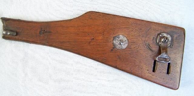

I'd like to hear more ideas as to the additional disk on the stock. Perhaps the fastener for a single point sling? an additional attachment?
Unread 11-11-2013, 09:09 AM   #15
Hi Doug, The "second disc" is actually the base for a shoulder strap attachment. This modification is quite rare and is only found on stocks with Torpedo Division unit marks. It allows a gun with stock attached to be carried over the shoulder, ready for instant use.
