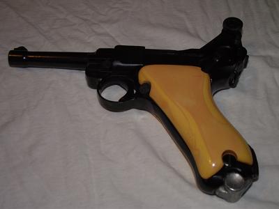

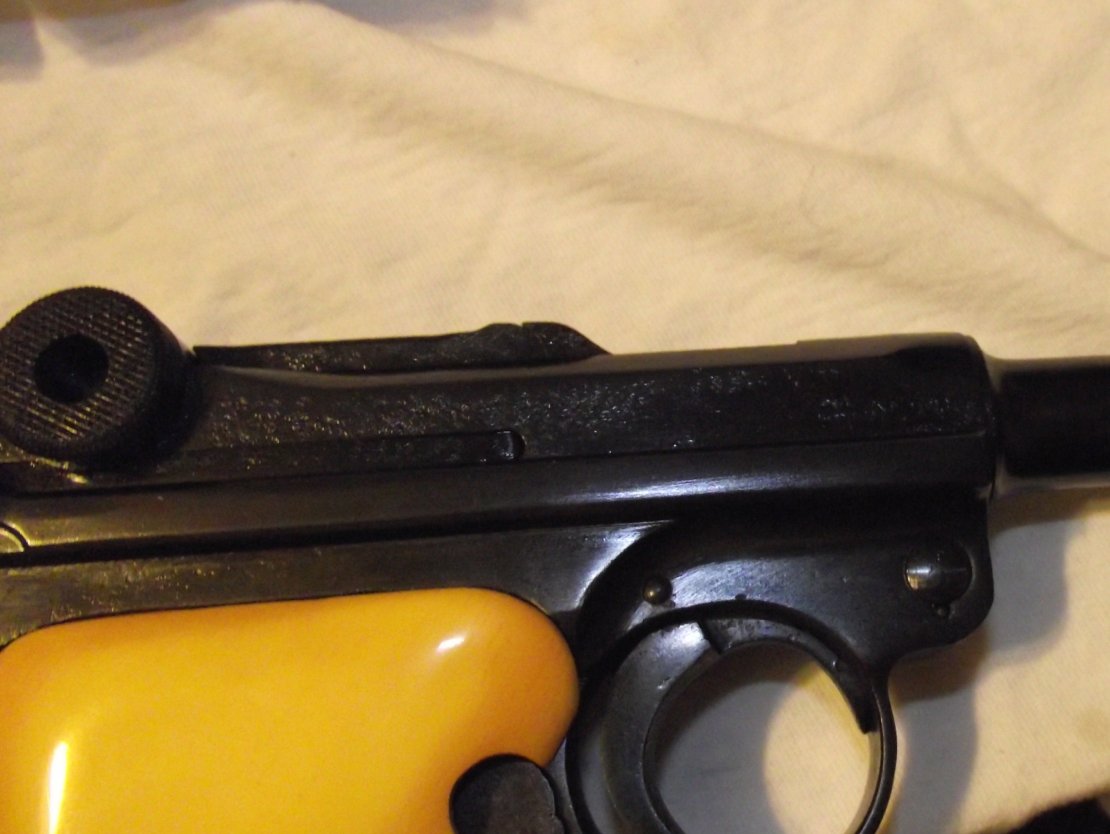

Greetings one and all. I'm new here and new to owning a Luger. Last weekend I bought a 1937 Luger at a gun show. I've been looking for one for years but never had the money to buy. At the gun show there was one dealer who had a luger. I asked what he wanted for it. When the dealer told me what he wanted,which was half as much as any I've looked at I jumped on it. It has surface pitting and I'm guessing has been re blued since the pitting appear blue. Looks like it has all matching numbers , but the pitting has made the proofing marks unreadable.
Anyway I bought it as a shooter. Gave it a fair cleaning and took it to the range today. It had 2 issues. First the magazine appears to have some play. It can push up too far and hold the slide lock open. Once I figured that out I just pulled the mag down a centimeter or so.
The second issue was that the trigger wouldn't reset all the time. I was wondering if this might be a worn spring?

Many issues with shooting lugers is the magazine, so a good mag would see where the issue was.
For the trigger, well, it pushes against the sear and I have a heck of a time with this issue.
I would first check that the firing pin and breachblock is cleaned well (on the inside) and that it is decently oiled.
Welcome to the forum!!

Thanks. I also suspect the trigger issue may be resolved with a full tear down and cleaning. And I'm looking for another mag, as well as a firing pin. I want to put the matching numbered parts aside and save them.

I have been going through mine replacing springs as needed. There are some great Youtube videos on field stripping. Make sure you take the firing pin out and clean the heck out of it. I actually take the wooden grips off and spray the heck out of everything with brake cleaner. Then relube and reassemble. It doesn't hurt anything. Just don't get it on the wood.

Private message them. I would also agree that the trigger issue may be cleared up by completely cleaning the sear area and making sure that the little plunger on the sear bar moves freely.

Hi Don, and welcome to the forum. Congratulations on your Luger .
As Doug mentioned, the disconnector is the small plunger at the front of the sear bar. If this sticks and doesn't push back out at the end of the firing cycle, the trigger will not appear to reset. The sear bar may require a soak in a good solvent, or there may be a problem with the plunger or it's return spring.
The correct operation of the receiver includes the magazine follower pushing up on a small hold open lever that is on the top of the frame. This is reset by a very small leaf spring that might be missing, mis-adjusted or broken. Take a good look at that part.
You should not have to drop a magazine a full centimeter to ensure proper cycling.

Marc, A centimeter might be an over estimation. The issue us with the magazine follower. Looks like its worn into the top of the slit it rides in.
