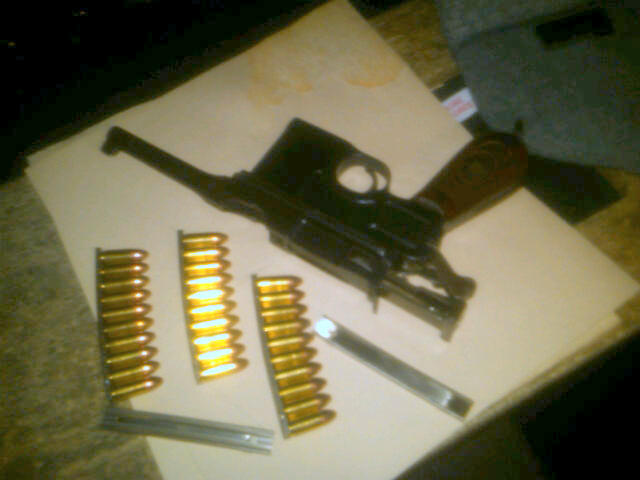

Have shot a few full size Red 9s in the past, but never got a chance to fire one of those reworked short barrel Weimar police Red 9. Today tried one instance.
The gun is in excellent shape, but it has no wood stock. From the stock connecting slot on the back of the grip, I doubt it has ever had a stock attaching to it. None of these Weimar Red 9s that I have met got matching stock. So no stock.

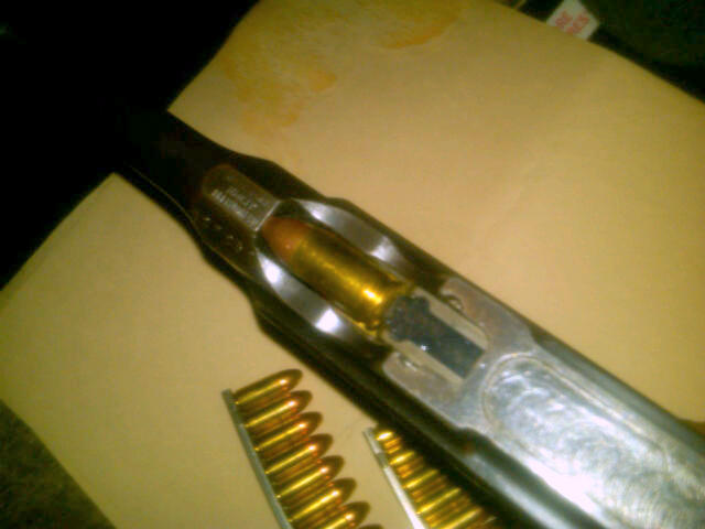

Fired exactly 100 rounds Winchester white box 9x19mm 115gr FMJ. It worked perfectly, except jammed once on the 67th round (see pix) -- the cartridge failed feeding. The cartridge's jamming position was high, it horizontally jammed between bolt and chamber. After pulling the bolt, the round dropped out freely. Planned to buy a few snap caps to find how this could happen. Probably due to weak recoil spring..... not sure.

This gun was acquired as a collectible, so originally I had no plan to shoot it. But I still have 200 rounds 9mm left, so.... consumed 50% today. The gun had Renaissance wax applied on the surface in the past, and its internal was protected by Rug grease. Before carry it to range, I erased the wax using a little bit Hoppe 9 oil, and then wiped it dry. The steel shell of Mauser protects its internal organs well, after shooting 100 rounds, the grease on the internal lock frame is still in light yellow color, looks clean. Just cleaned the bore and magazine well, wax reapplied, stored it back.
Unread 07-29-2013, 07:21 AM   #4
Thought about that instance of feed jamming issue again. The myth was how the round jumped out of the magazine well's mouth and blocked horizontally at such a high position. Somehow, the magazine well's mouth did not hold that round, the cartridge simply jumped out. Not likely being a spring strength issue.
Looking back, I did not clean up the grease inside the magazine well thoroughly before shooting. One possibility was the residue grease melt under higher temperature after certain number of rounds being fired and that cartridge case became very slippery.
Unread 07-31-2013, 08:32 AM   #5
Studied the case with snap caps last night. Under no scenario I could reproduce the problem statically in slow motion. The only possibility that I could think of had been mentioned above. Cleaned up residual grease from the magazine well, will try another time again this week to see it's reproducible or not.

Fired another 100 rounds. Worked flawlessly this time. Lesson learned: clean up the grease and gun oil in magazine well before shooting. This Red 9 shoots so smoothly and accurately, I even thought "this thing could be used for self-defense purpose" while driving home ... Just kidding
