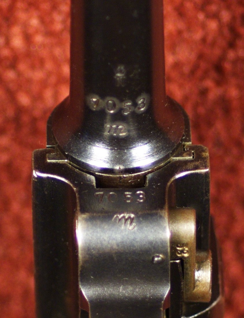

Unread 07-14-2013, 07:50 PM   #10

Congratulations on your Luger and welcome to the forum, Wade.
Lightened areas around the barrel serial number stampings should be visible. These are called "halos" and occur due to the stress on the metal caused by the stamp when done after finishing.
I can't see these in your photos, but they may be there under different lighting.
If there are none, it's likely that someone has refinished this Luger at some point.
If the grips are properly numbered to this pistol, you should contact Hugh Clark (on this board) about repairing the broken one.

Wade, here is an example of what halos on the barrel would look like on an original rust blued Luger:

Unread 07-15-2013, 10:27 AM   #14
Not necesarily. The finish on the gun in general looks good to me. The photo you show of the markings at the bottom of the barrel, however, looks like it is coated with oil and poorly lit. Halos do fade with time, handling and exposure.
A better lit photo of this area, shot from straight on and free of oil would help.,
Unread 07-15-2013, 11:06 AM   #15
Wade, your Luger has the sharp edges, aged straw and high point wear that you would expect to find in an original finish gun.
If you take the receiver off the frame, you should see much of the interior of the frame (on the top, not sides under the grips) in the white.
Also, the front of the muzzle and the small pin holding the toggle axle in should be in the white. None of this is visible in the pictures you posted.
Sometimes halos are barely visible, but they should be there. If they are completely missing, it would indicate refinish in that area.

Althought pictures can be deceiving, in my opinion, the finish is completely original.
The overall wear and patina looks uniform and correct.
Oh, and the bright blue ("indigo") on the sear bar spring is correct: it is achieved by heating that part at a specific temperature.
