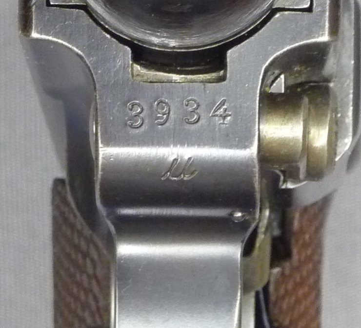

Particularly in the second pic, the receiver seems noticeably proud of the front of the grip frame. Is it just my eyes, or is this an early long receiver assembled to a short frame here?
Unread 10-27-2018, 03:50 PM   #8
I think it is an optical illusion, due to angles or shadows.
It is a short receiver.
