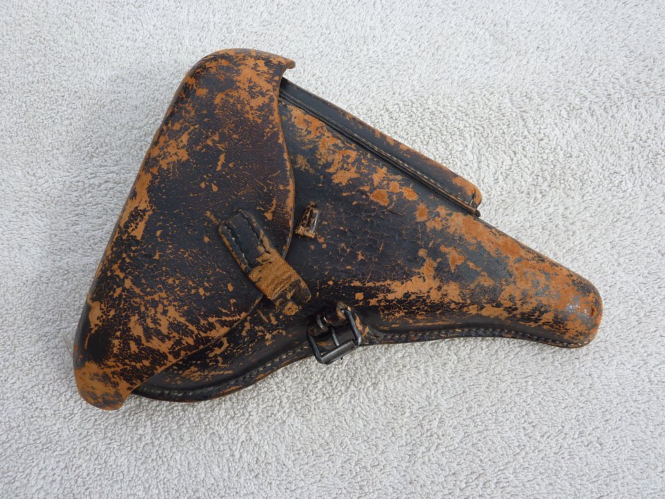

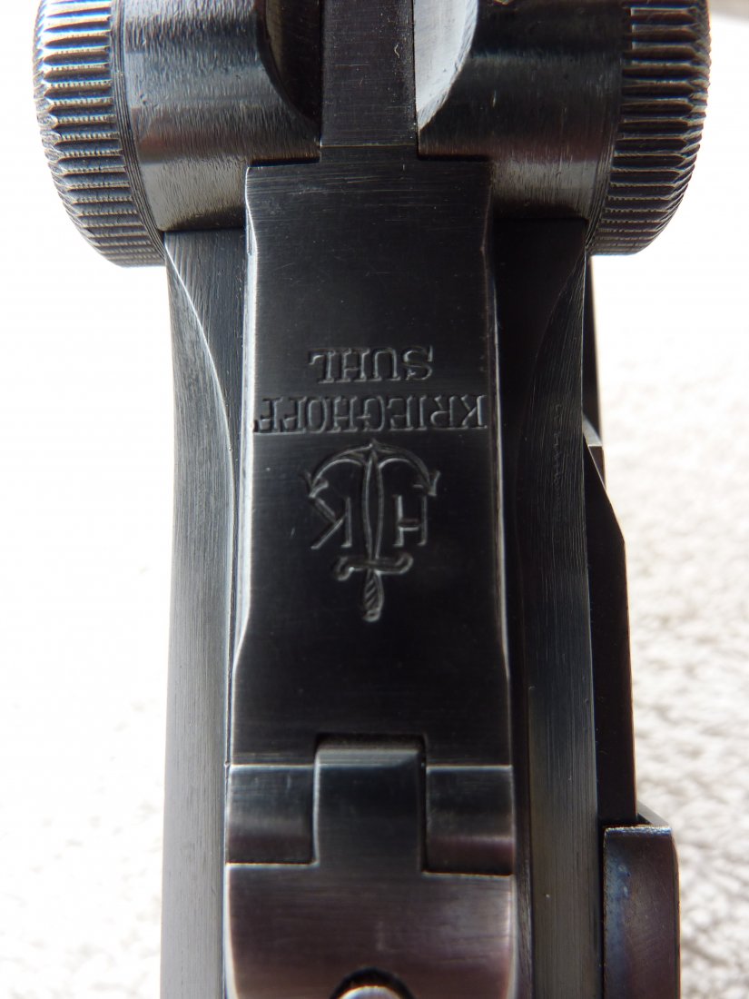

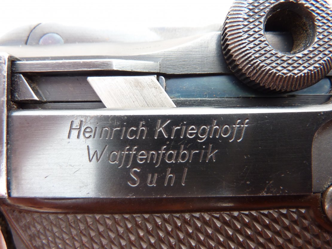

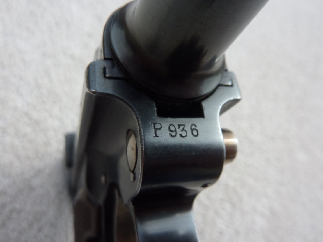

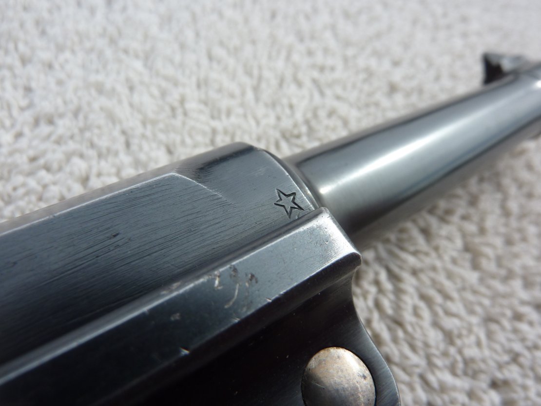

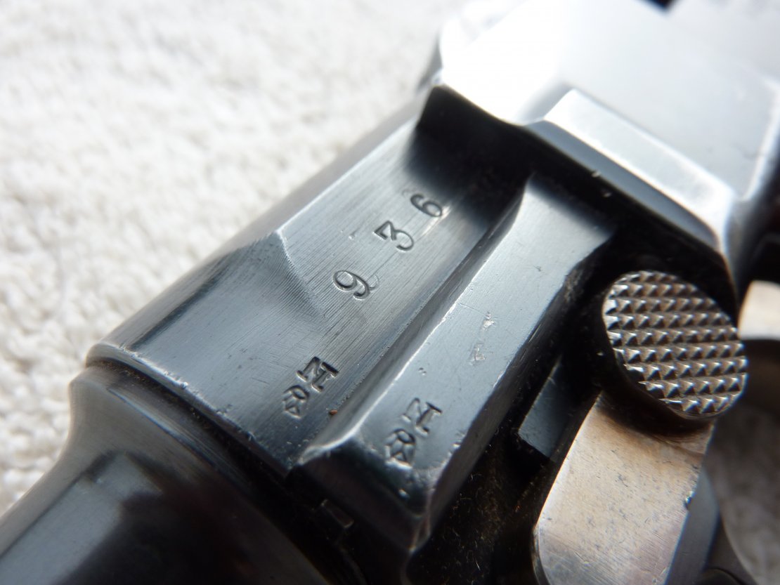

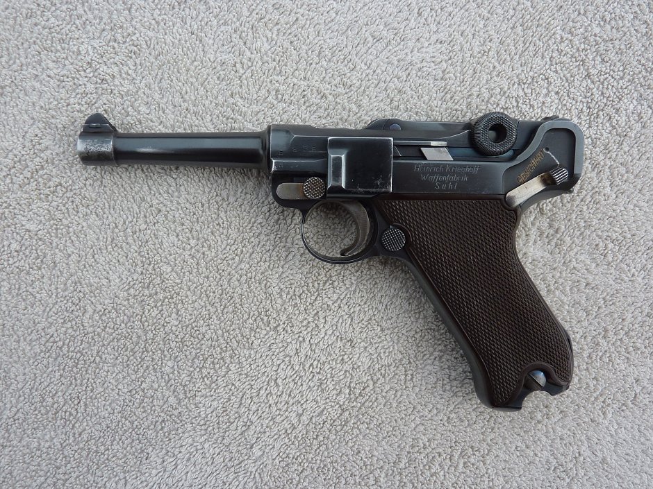

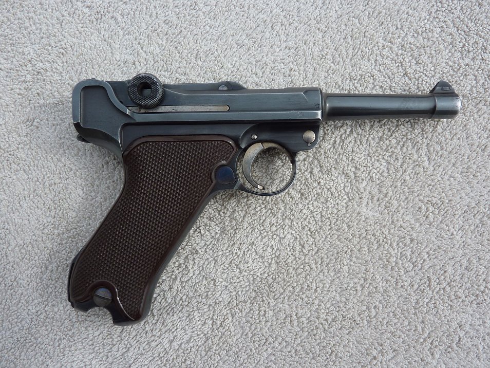

Helping a neighbor who doesn't know guns very well. He wants to get an accurate value for this Luger his dad brought back from WWII. The holster is pretty worn and is dated 1939. There are two mags with it but neither match the gun or each other. Also, the pictures do not show it but there is no date on top of the reciever like most I have seen.
Any help is much appreciated.
I have more pictures in my album.

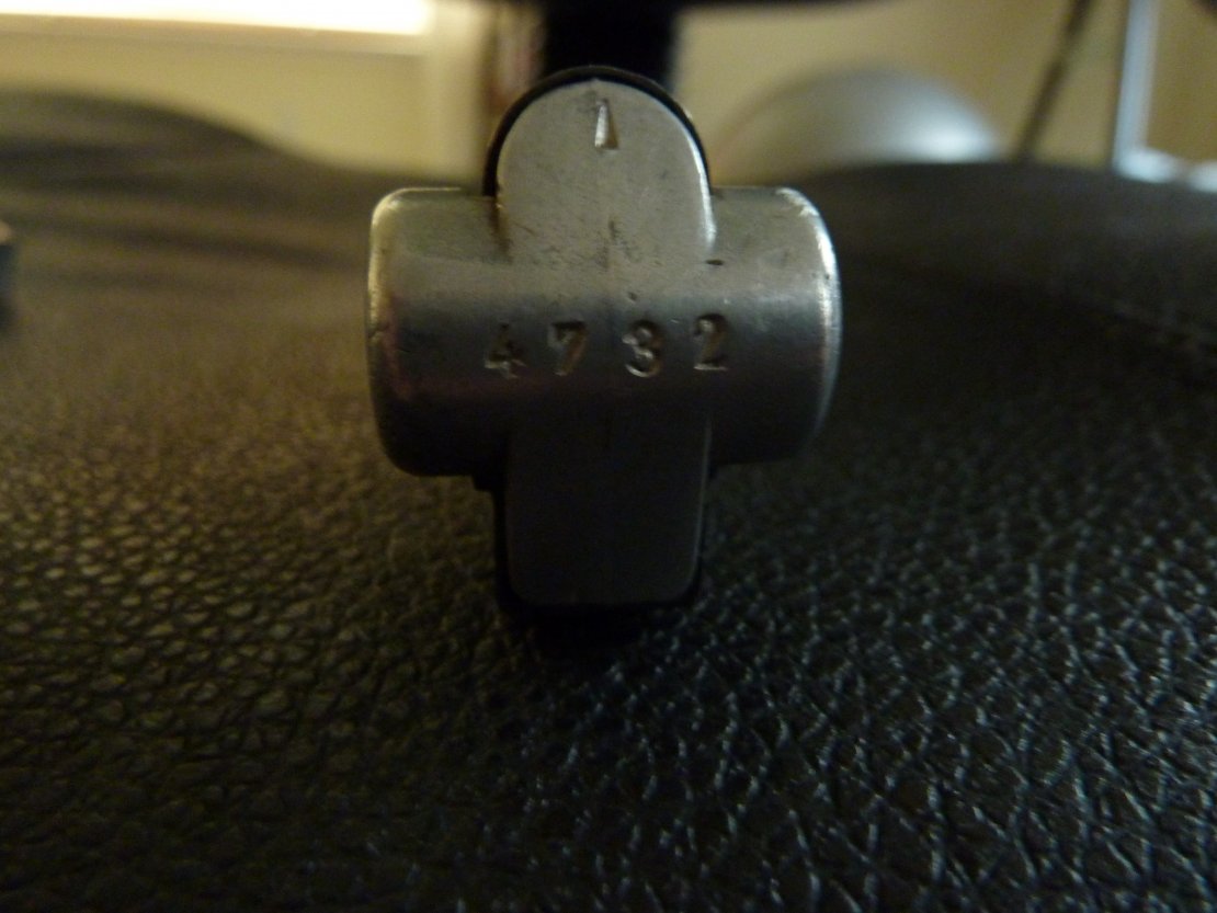

Also please show the markings on the bottoms of the mags.

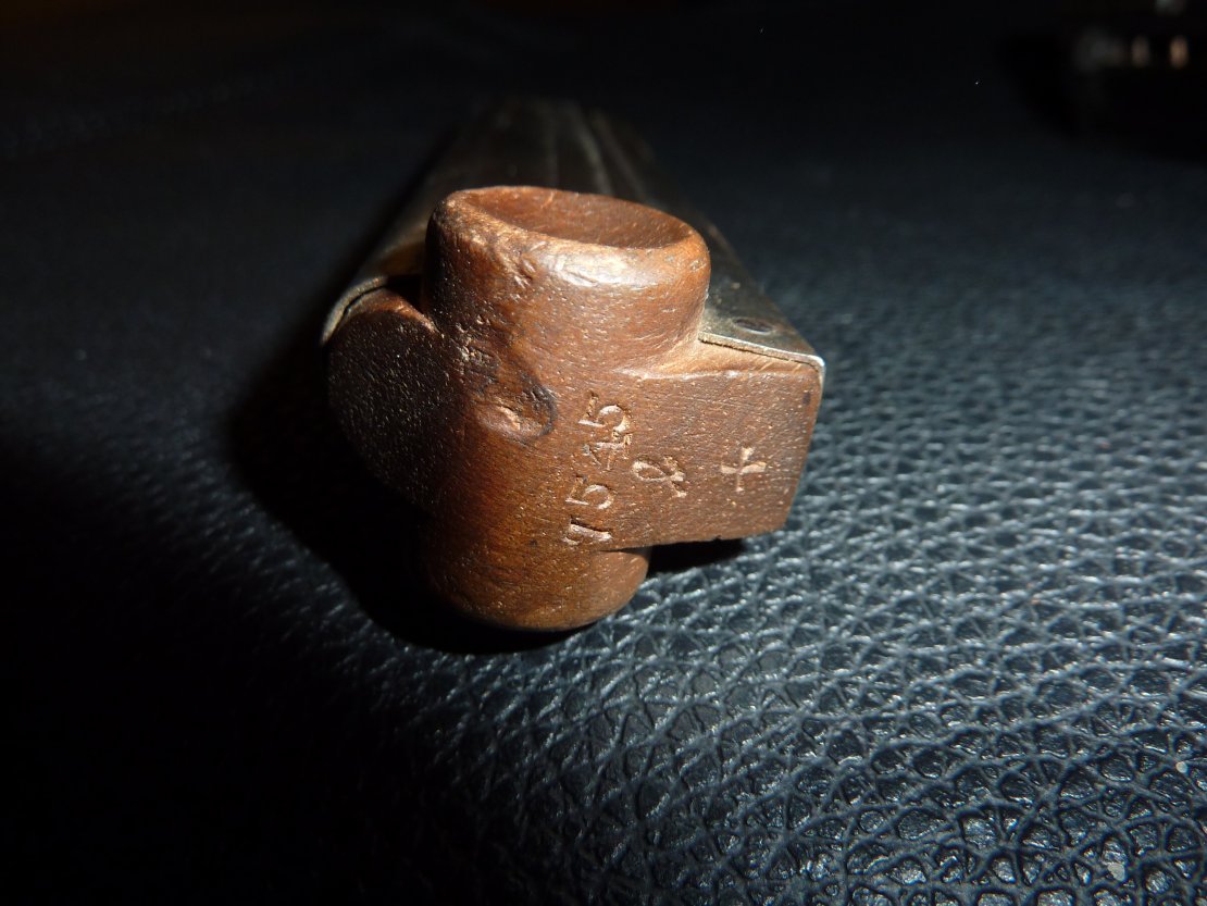

Mag #1 - Aluminum bottom, S/N 4732, no other markings
Mag #2 - Wood bottom, S/N 7545, with a cursive lower case L and a plus sign underneath the S/N
Sorry didn't get a pic of that....

Your commercial Krieghoff "P" Code pistol is stunning and rare. It is in better shape than the Simpson offering. The only downside is no matching mag.

coudnt find that serial in gibson

Your neighbor has a very rare and very valuable Luger in what appears to be exceptionally good original finish and condition.
It would be very helpful to see pictures of all markings on the magazines and any others on the holster.
One like this should be individually appraised by an experienced appraiser with a good background in Krieghoff Lugers. Ben already mentioned Simpson's Ltd in Illinois.
My best guess is somewhere in five figures. Probably closer to $20,000. I am not an experienced Krieghoff appraiser.

Hard to say with the economy the way it is..the last one of these I know about sold for $25,000 here in Arizona about 5-6 years ago.
I authenticated that one and have done several Krieghoffs since. It was discussed on the Jan Still forum and some collectors thought it was a fake. I went through that pistol with a fine tooth comb and if it was fake I would dearly love to shake the hand of the man who did it. That would be an honor. If it was fake which I don't believe.
Not many people are knowledgeable enough to authenticate these or any Krieghoff for that matter. It is necessary to dismantle many of the hidden parts looking for markings and numbers. Comparing fonts etc. to what should be there. I am unsure who I would recommend for this.. Off the top of my head I can't think of many people I think could do it or that I would trust for any accuracy.
Ben already mentioned Simpson's Ltd in Illinois. I doubt there is an experienced appraiser with a good background in Krieghoff Lugers there. If there is one who is he? He is hiding from the Luger collecting field...
Dwight Gruber comes to mind. Ron Wood is a likely candidate..George Anderson too. What would be ideal is to have 2 or 3 people in one place to brainstorm it! Any three of these Gentlemen could make their own recommendations I am sure.
Anyway it's quite a find. Congratulations to your Friend.

From the photo of the holster..it's pretty rough. Not a whole lot of value there unless I could see more?

Thanks for the replies guys!
Here is a picture of the magazine bottoms.

Is the brown one wood or some kind of composite material.
If the strike at the top is the digit "1", the other one is a police magazine, but I don't see the proof marks...

Yes, brown is wood. The other does not appear to be a strike mark I think it is just a casting flaw
