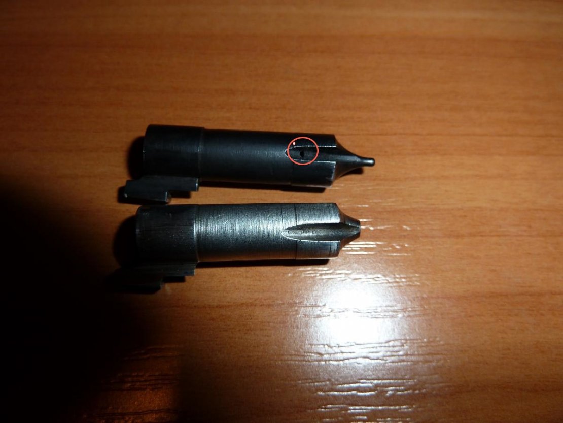

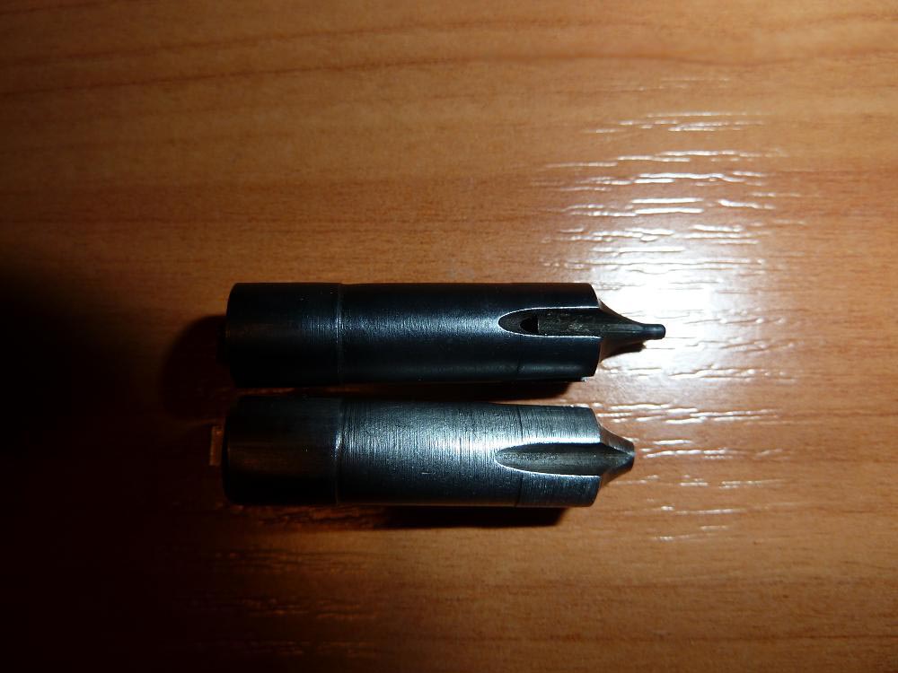

I want show this peen. And i have question about hole. May be some one see another peen with hole ?
Best regards Anton

I'm talking about top peen.

Welcome to the forum, Anton.
You are asking about a hole in the top firing pin? It is unclear to me what you are calling the "hole". If you are asking about the grooves ground into the front shoulder of the firing pin, just behind the tip, then this would be called a "relieved" or "fluted" firing pin. These grooves were added--1914 or thereabouts, not exactly sure--and would allow the ignition gas pressure from a pierced primer to mostly pass by the firing pin instead of forcing the pin violently backward within the breech block--likely causing damage. Some also say that the grooves allow for somewhat of an accumulation of fouling before the firing pin is affected by it.
Also, a qualified technician would be able to weld material onto the one with the broken tip, and re-shape/restore the tip. This might be important to do if the firing pin is matching-numbered.

Thanks for your answer. I mean this hole on red ring. In one ruusian forum people told me about its fake firing pin. And i start this theard for search answer.
Best Regards Anton

This is clearly a manufacturing flaw. The internal cavity was drilled too deep or the flutes are too deep and they managed to meet, creating the hole. Although technically useable, a blown primer will probably end up shearing the firing pin retainer right out of the breach block, damaging either or both.

I also think that this is a defect, resulting in the production. But Deputy original firing pin? or is it a copy? Can you tell from these photos.
Another option I have used is to drill the body and silver solder a new tip into it. If you do it right, this repair is strong and undetectable. Here is one I did just a couple of weeks ago: http://skytteforum.com/default.aspx?g=posts&t=31872
I agree. The hole is actually rectangular, which indicates that it must be the bottom of the hole showing through. My initial thought was that you can turn a small plug and press it into the hole to make it more shallow. On second thought, this may not be strong enough, a blown primer could possibly blow the plug out.

A TIG weld is needed, then re-grinding of the groove, only not so deep. (Compared to the groove in the pin next to it in the pic, the groove is longer, which means it was ground deeper.) Care must be taken to maintain the internal dimensions.
Your pin is numbered with at least a number 5, which appears to be of proper style font. If the number on the pin is the same as the last two digits of the serial number, it is likely original to the gun; the inspectors simply did not catch this flaw.
