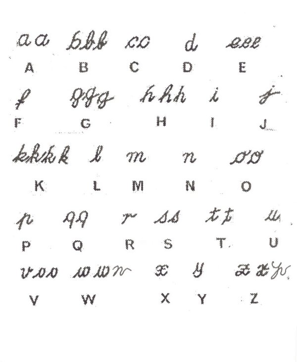

From looking at the thread that discussed suffixes, it looks to me like an "i". The "l" looks like they have a loop at the top which I dont see on yours. Plus yours looks like it has the dot on the top of it. I aint 100% sure but I copied them pics from that thread and added to this so you can compare.

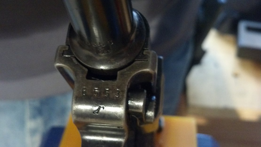

Also for the life of me I cannot identify the suffix letter on the lower receiver. I have looked at numerous lists like the one on this page and there is no clear match. Can anyone help? Pics attached... thanks for reading thru all this!

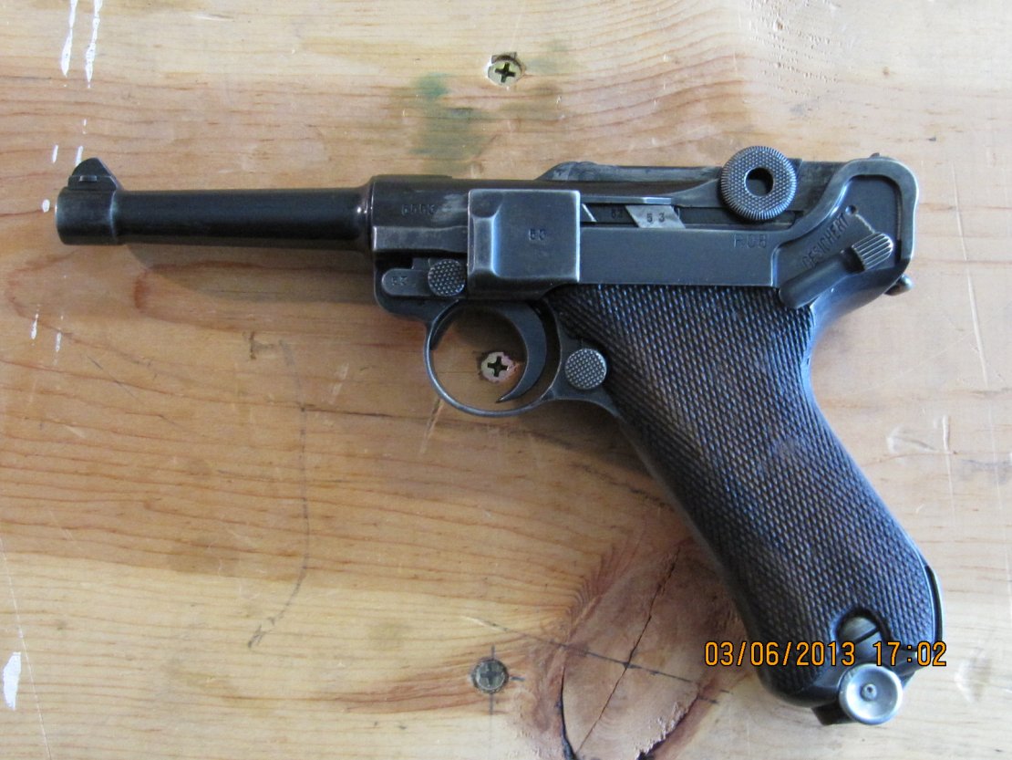

Thanks for the welcome and the info on the sideplate Alanint. I have attached a full side view of my P08 which can be magnified. Would appreciate your (and anyone else's) comment on the finish originality (or not)...
I disassembled this pistol down to the bones and cleaned and lubed it as soon as I got it home, found it to be sound, and fired 2 mags of 'sedate' 9mm thru it and what a joy to fire. Unconsciously started barking commands in Prussian accented English at the range to everyones bewilderment. ...I can't have a weapon that I don't know functions or not. Just my thing ...

The suffix is a "r", making your serial number "6553r". A complete unique description would include it's identification as a 1941 "byf" code Mauser Luger, s/n 6553r. The number and suffix can be duplicated over the years of Luger manufacture.
I'd like to see a closeup of this frame serial number and suffix if possible.

While you can't be absolutely sure from photos, your Luger looks like it's in original finish to me.
It is collectable and a piece of history. Damaging it will lose that.

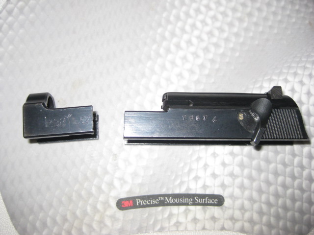

Here's a picture of a collectable P.38 that showed up this week on another forum...
