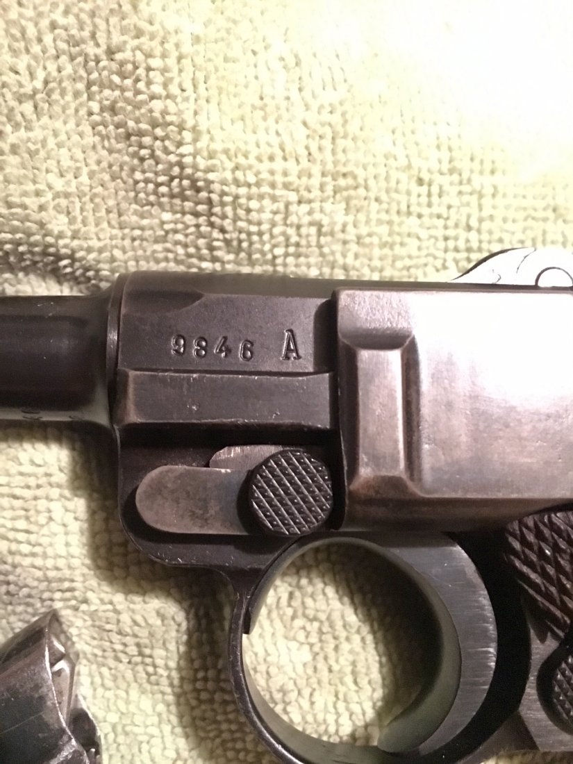

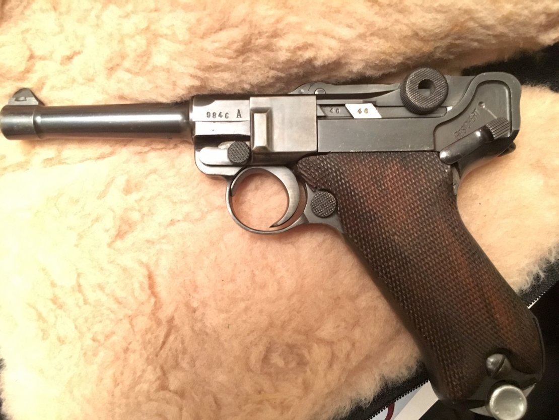

First and foremost... Hello all! Sad to say, I have not logged onto the forum since 2009 Life, Career changes, selling off the collection, etc... Glad to be back! SO all that said, Starting to slowly rebuild the collection and ran across a 1938 Mauser that really has me scratching my head.. First glance I noticed a un numbered side plate and takedown pin and thought.. meh, it's a shooter... But then I noticed a very odd large letter "A" stamped next to the serial number on the left side, and also on the lower part of the gun???? I'm really baffled... Any ideas?
Thanks much!

WG, Is there any suffix number on the front of the frame? If not an A suffix, the A on the receiver was probably added to a second PO8 stamped in error with the same serial as the one made before it. TH PS: I've also seen this on M1914 Mauser pistols.

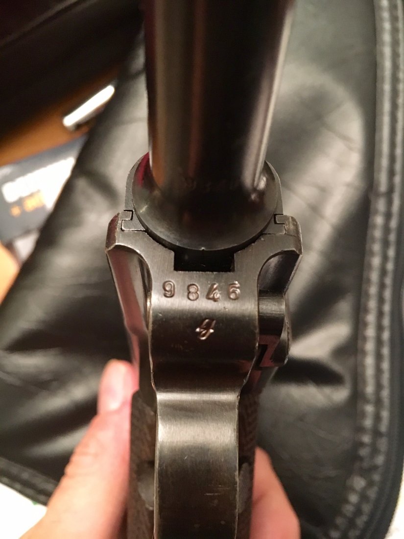

Hi! and Thank you for the quick response!! Indeed it does, see pic below. It wouldn't have any connection to the non-numbered sideplate and takedown pin would it? Very interesting stuff..
A great explanation Tom. I have never personally seen this type of serial number modification before... Your theory is certainly very plausible. It would prevent a finished gun from being destroyed as a result of the mistake... and would allow for accountability using the modified serial number.
Has anyone else seen examples of this type of stamping?

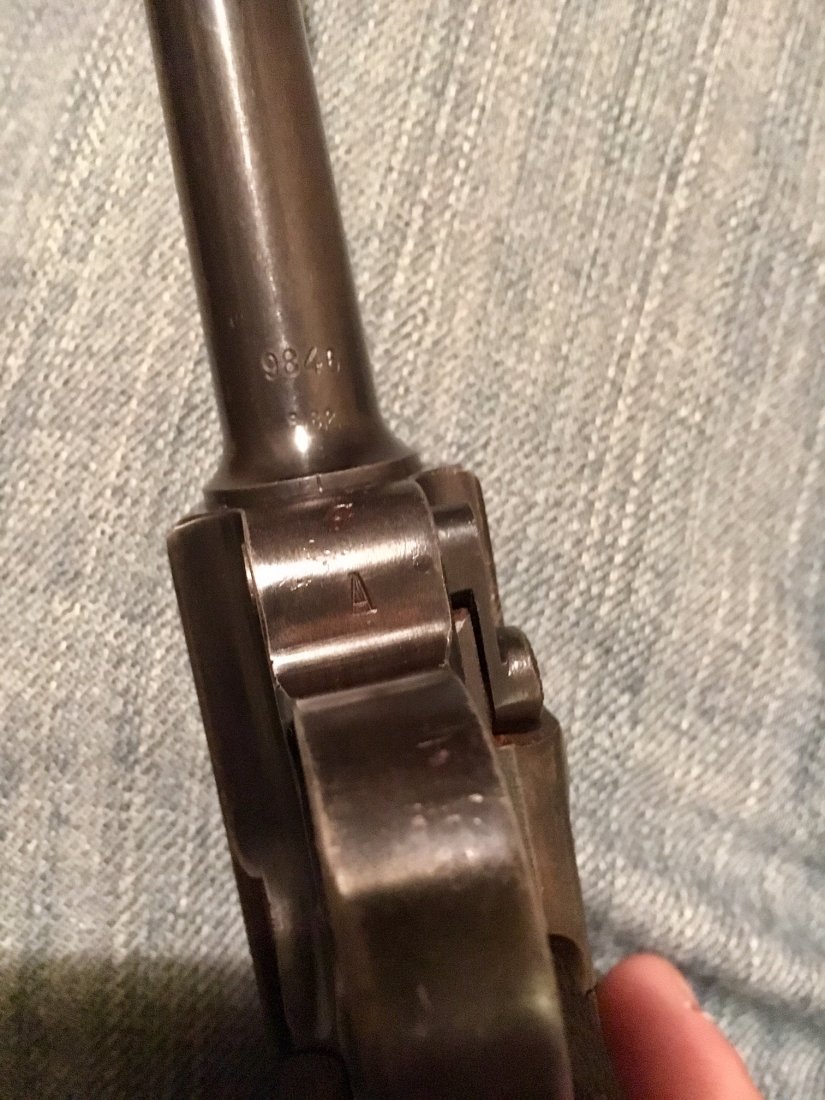

If so, why is the "A" not also on the frame?
Unread 12-07-2016, 03:54 PM   #7
waltherguy
waltherguy's Avatar
Join Date: Jan 2006
Location: FL
Posts: 201
It's there.. sorry a little tough to spot in the pic I took

The capital letter A was used to denote rejected parts.

Eugen,
perhaps easier to say what they were Not used for - military production.
Many parts rejected for the military were used by Mauser for commercial production.
I rather doubt this "A" is for reject; but for the odd occurance of the same serial digits occuring in a unit- so one of them was stamped with "A" for quick differentiation.
This practice is noted in one of the books, one of the Police books maybe, but I can't recall exactly where at the moment! CRS strikes again.
This one is a puzzle with the un-numbered parts: another possibility is a post WWII rebuild by one of the Suhl gun makers, with the A added to identify their work; kind of like a trademark seen applied by others- for example Luneschloss.

See "German Small Arms Markings" p.118, also p.114. The Germans were very clear about the use of the capital-A.

From "German Small Arms Markings" p. 118: "Any parts considered to be rejects are to be marked with the capital letter 'A'..."; "Editorial Note: 'A' was an abbreviation for 'Ausschuss', meaning 'rejected part' or 'scrap'"
Ibid., from p. 114: "Notes: 1.) It is left to the rifle factories to apply 'worker stamps'...[which must] utilize Latin letters from 'B' to 'Z'...The letter 'A', as well as numerals, are to be excluded."
