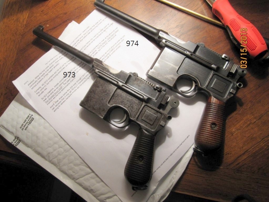

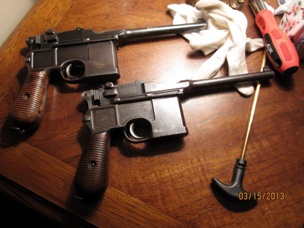

Here are Cone Hammer #973 and #974, made in 1897. Like twin brothers, they finished their serviceable life in different paths and reunited yesterday, after 116 years.
Everything looks good on #973, except it's follower spring was a replacement. Given the overall condition, that's not surprising. Someone put a "four-fold" later style zig-zag spring in it. If you have an original early style "three-fold" spring for sale, or you know where I can find it, please let me know. Thanks.

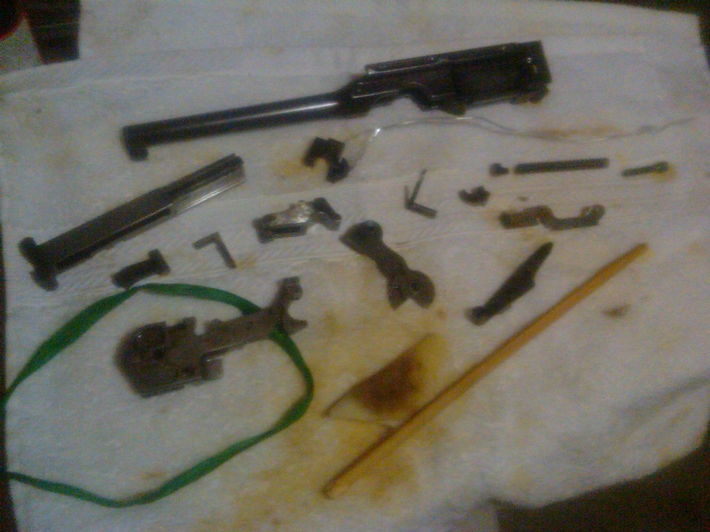

Finally, got time to clean up #973. When I received it last week, the barrel was like welded on the frame, not movable. Holding the grip punching the muzzle again a soft pine board a few times, finally I could draw the bolt open. After field stripping and applying a little gun oil, the bolt could be opened with considerable force, not smoothly though.
This morning, after detail stripping, I did not see any rust inside. What's blocking the action movement? The exterior of the gun does not have 3% blue left, but interior blue is still very good. Old grease formed a layer of solid crust on many small parts, which not only does not help motion, but also block the movement. After soaking the parts into "Break Free" for hours, and cleaning the surface with a old toothbrush, at least, the pistol came back into life again. Now, pushing the barrel backwards and releasing it, "ga ba", the barrel returns to the battery, and the bolt can move smoothly. that's what I expected. Feel better now.

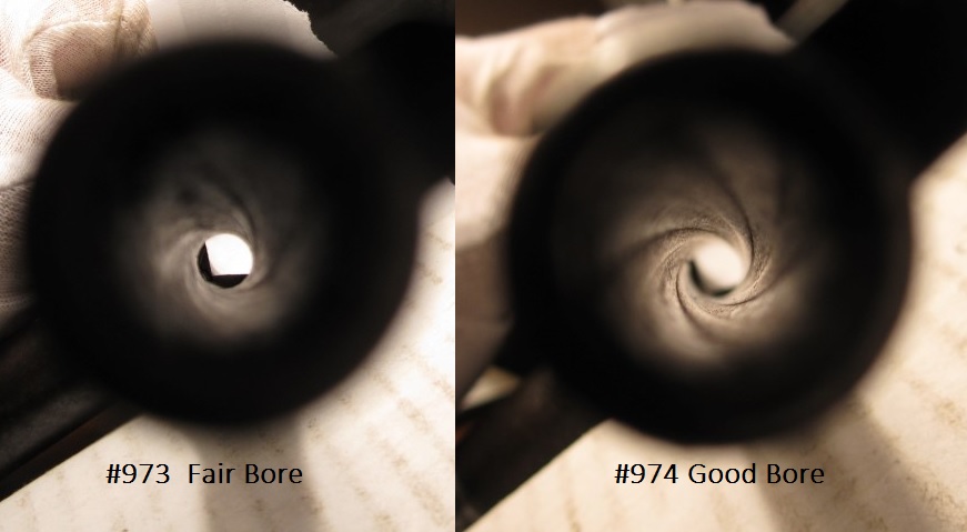

Finally, a few more pictures. Fall into love with these two
