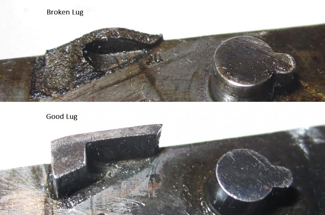

Got a broken safety level. The hammer locking lug on it is broken. Cannot simply throw it away and put another one on, because it's numbered to the gun.
Is this broken lug repairable? A good level at bottom offers a reference shape.

Why does the broken area look like a casting? How did the part fail?

I believe the locking lug was hardened, so it's also brittle. Same is true for bolt head and sear arm. Especially sear arm, it may crack like a piece of glass.
It arrives me in broken mode.

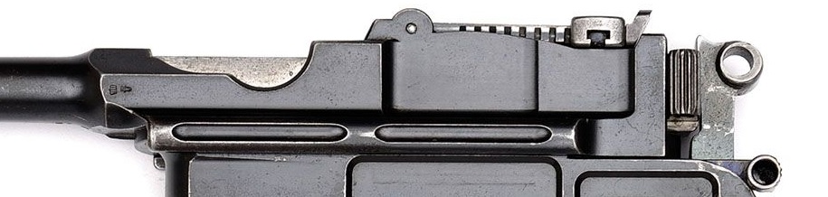

It's too big. The square corner cannot be skipped. It must be there. Otherwise, the safety lever cannot be pushed down (safety on) when the hammer is at the down position. That corner on locking lug leaves space for the hammer.
The top thin layer of steel is not optional either, it covers the underneath empty space to prevent sand or dirt to fall in.

Whether or not a repair is strong enough depends on why it broke the first time. High stress during normal use or abuse, perhaps a dropped gun. Maybe it's just the picture, but the break looks to much like cast metal for me to think the part was strong to begin with. However, looks like an excellent surface for brazing.

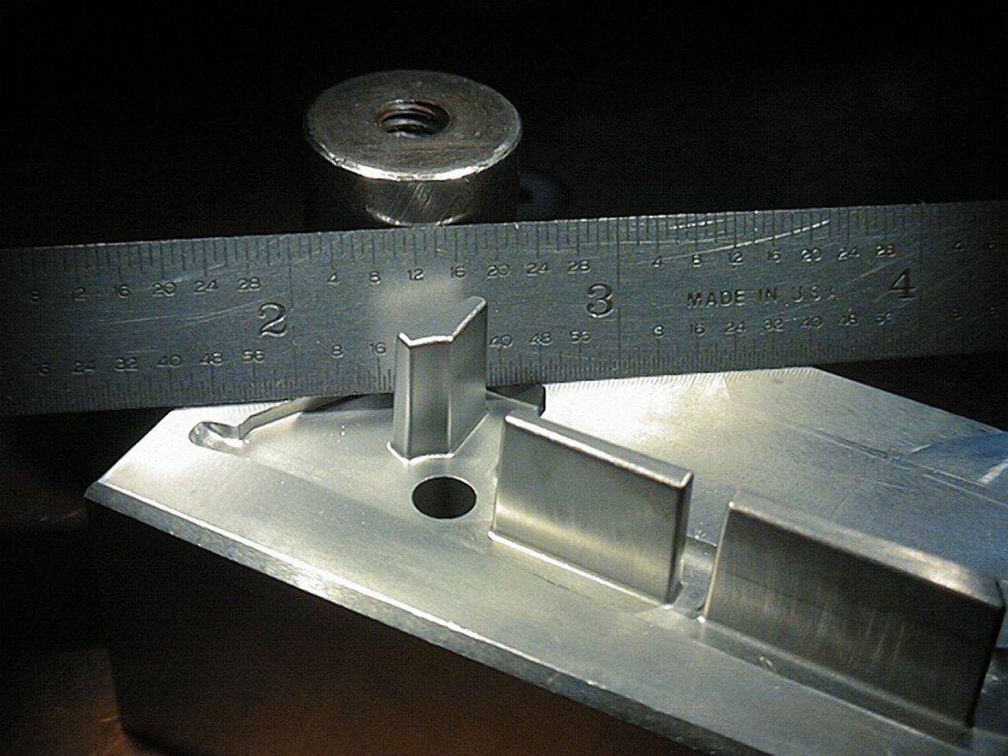

Just watched a few laser welding service provider's web sites. What they can do is amazing!!! Will still put this option into the highest preference, as long as they are willing to do it.
A sample picture:

Done. Fetched it back today. I cannot be more satisfied. Scott did excellent job. Even the curved corner of the "L" was created. After some fitting work, it fits into the pistol and operates perfectly. He told me that his company has been doing micro-welding in other fields for years, now opened new service repairing gun parts.
