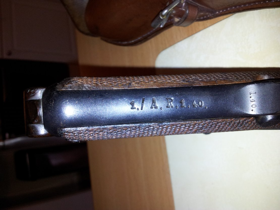

Your Luger is marked to the post WWI Reichswehr 1st Battery / Artillery Regt 1 weapon 40. circa 1921.
It was part of the Reichswehr 1st Infantry Div. It was stationed a Königsberg . One of three Artillery Regiments deployed on the Eastern Frontier against the Polish Army. Equiped with either 77mm field guns , or 105mm light field howitzers.
In the early to mid 1920's Poland, and Czechoslovakia supported by Russia conducted assaults against the Eastern Border of Germany in an attempt to retake territories captured by Germany during the war, which Germany was allowed to retain by the Treaty after WWI.
August 1939 it was reorganized into the 37th Heavy Artillery Regt. and was deployed during the invasion of France. In 1944 it was again reorganized into the 121st Artillery Regt.

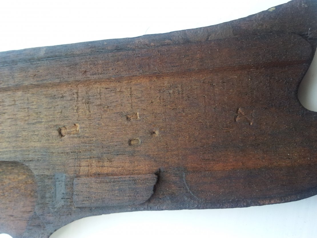

Wow. Realy interesting stuff. Thank you for sharing that. The pistol is dated 1917 and property stamped 1920. Would it have been used in ww2? Markings are purely ww1 across the pistol. There is an x stamped on the inside of the wood grips only visible when you remove the grips. Thats the only marking i cant tie down to ww1

James, Yes it would have been used in WWI and WWII. Your Luger has a rich history. Can't help you with the X on the grip. Inspector's mark possibly?

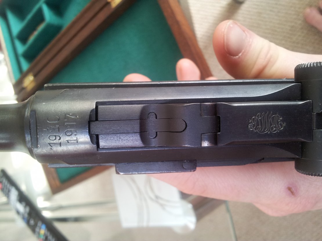

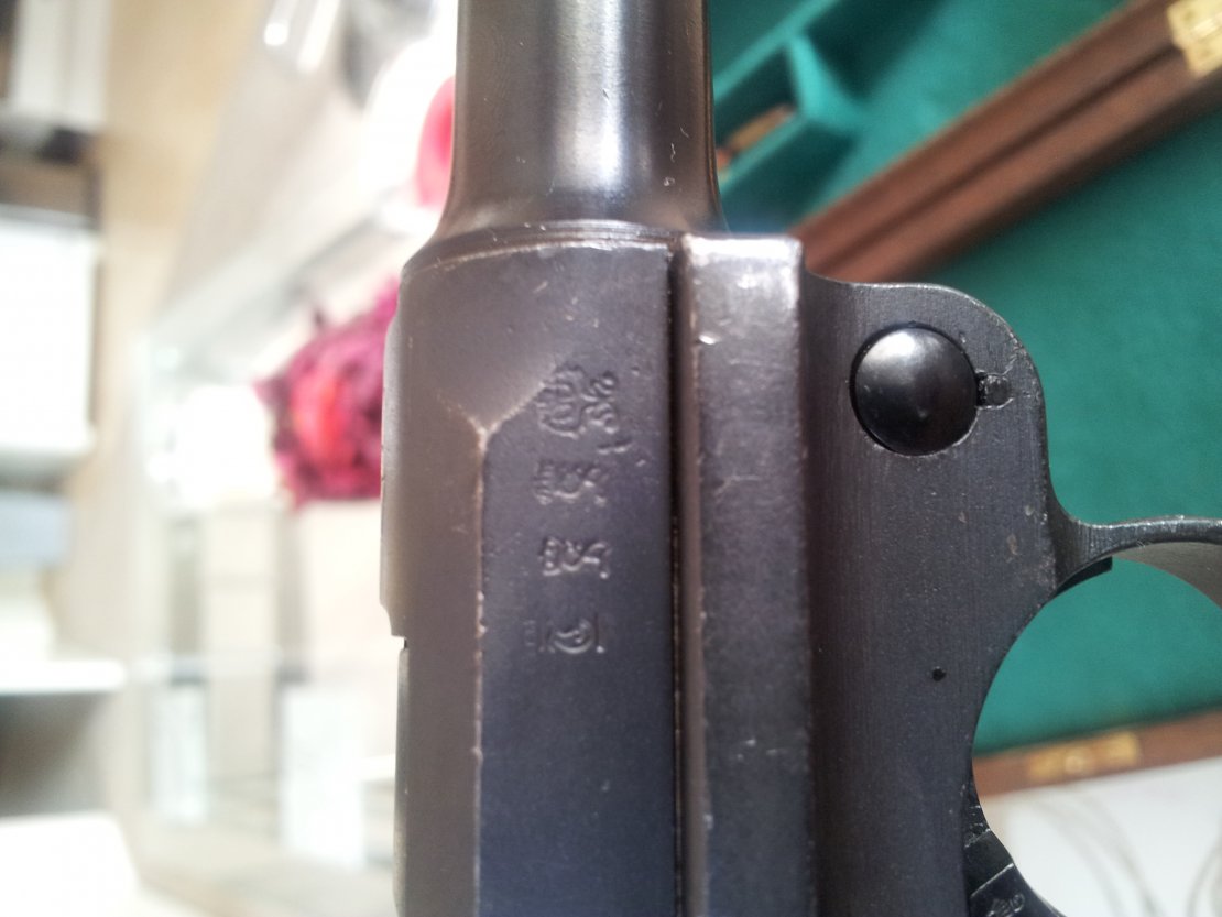

Here are some pics of the pistol,

What is that smaller number/letter up by the trigger guard??? I don't think I've ever seen anything there before...

That's the provisional unit mark applied prior to the final or official unit mark. 1st Regt. weapon 40.
James,
It started out as an Artillery Luger in 1917. Note the Artillery sight notch in the chamber. It was re-barreled, or assembled from parts on hand and reissued after WWI. A very nice example of a Reichswehr Luger. The Russian capture "X" would be a large and crude X stamped into the receiver. On the grip, it would be a routine inspection mark.

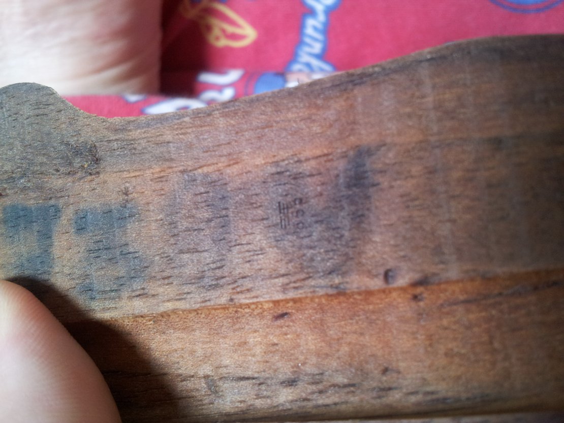

Ive given my grips a refurb and it appiers that ive found a nazi inspection stamp, physicly prooving WW2 issue. About 3CM above this mark is the number "42" stamped into the wood. Let me know what you think. It seems that the 1st pic is the original grip from WW1 and the right hand side (attached) was WW2 issued

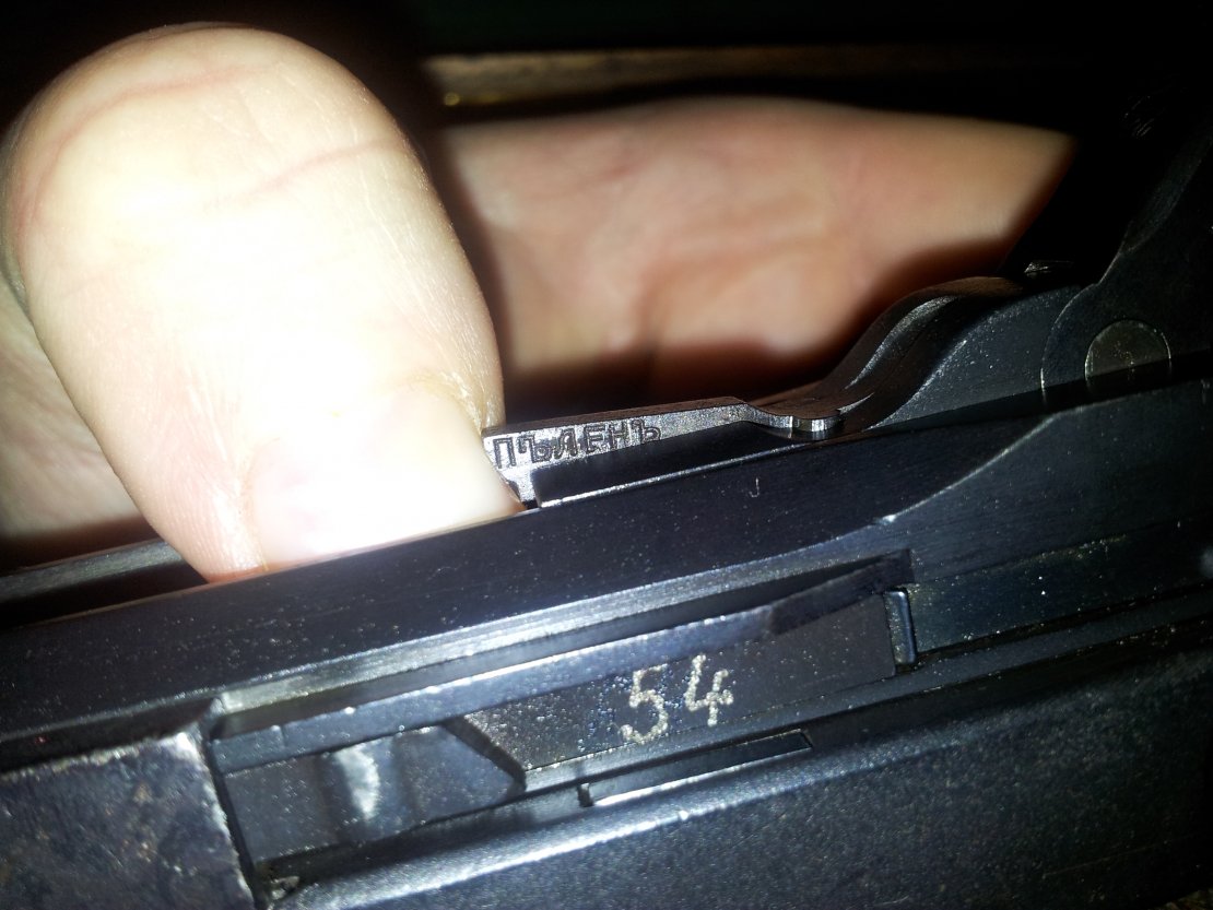

Found a VoPo marking...

Originally Posted by Ron Smith View Post
All VoPos were Russian Captured, and then distrubuted to the East German police, who inturn, mixed and force matched parts.
James -
Do not underestimate the East German 'Police'. In the Cold War years, following WW II, the East Germans were using their 'barrack police' as the nucleus of their new army. The 'Police' had tanks and MiG jet fighters. They were one of the reasons the Cold War was so intense. If the USSR had ever decided to engulf Europe, the East German 'Police' would have been an integral part of their shock army. IIRC, East German pilots even flew & fought in some of the insurrections in Africa in the 50's & 60's as 'advisors'...
I don't have Don Maus' book, but I would be interested in knowing just what East German 'Police' units were armed with Lugers...
