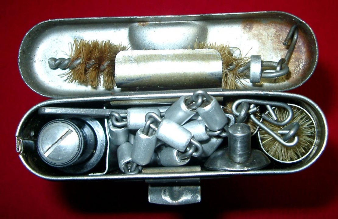

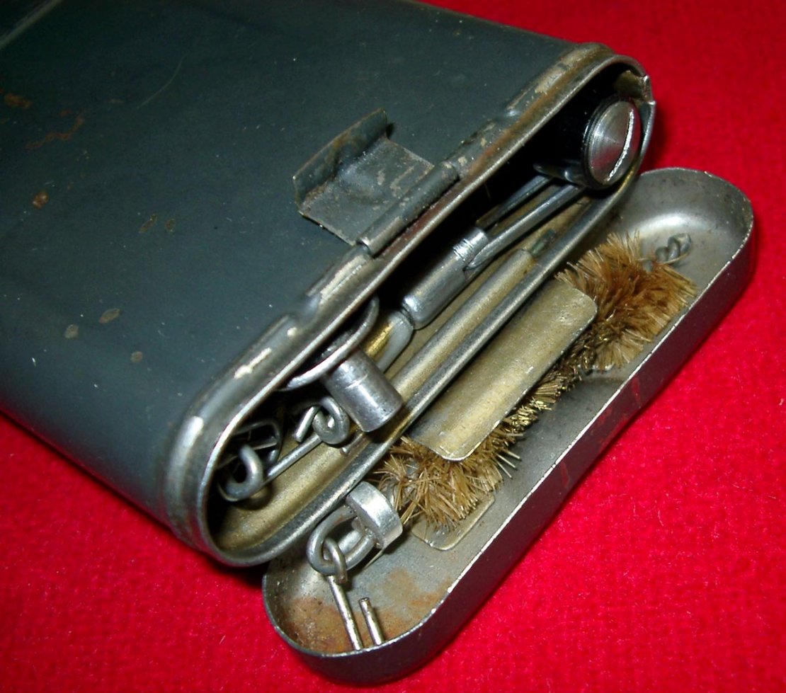

The rods were used in combination with a thick cotton wire called 'Flax'. This wire was wrapped around the threading on the rod.
From 1934 onwards, the cleaning rods were abandoned officially and the RG34 cleaning kit was introduced instead. The RG34 was used for the rifles, pistols and machine guns.
There was also a special version of the RG34 for cleaning the .22lr training sets, the RG34a.

Jack,
Most collectors tend to believe that the RG34 was issued for rifle maintenance only. Period documentation (and the photo above) show that the RG34 was indeed used for pistol maintenance as well. No P08 should be without one

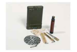

Posts: 48
Vlim's photo seem to show a postwar model RG, probbably for the FAL/G1. The RG34 had a spoon to clean the inside of the K98k's locking lugs. It is very rare to find one these days and they command prices just like the little P.08 screwdriver.

Jack,
There were some Rg34s that were made/issued with a third brush for the 9mm. This brush was held in place by a clip under the lid. The 9mm brush had an aluminum collar on it so that it would only pass through a 9mm barrel and not a 7,92mm rifle barrel.

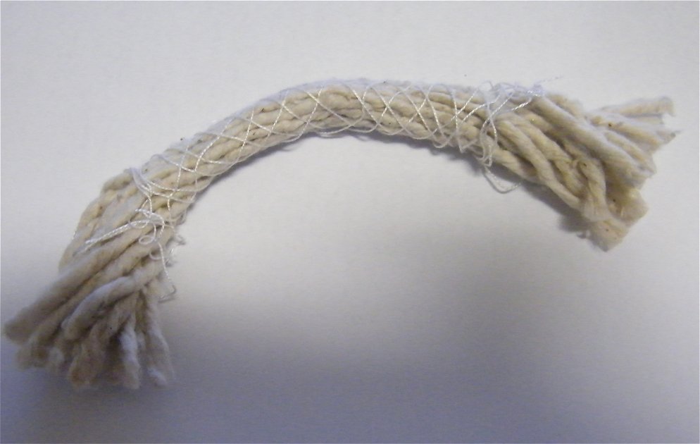

Hi Eric,
The cotton laces in the second photo is genuine; If these are not original for p08 do you know from what gun it is ; I have exactly the same 20 packets

Unread 01-09-2013, 06:11 PM   #17
They are relatively standard, and used for all sorts of guns.
