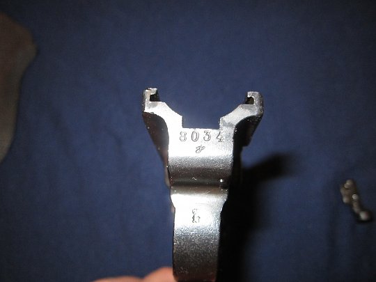

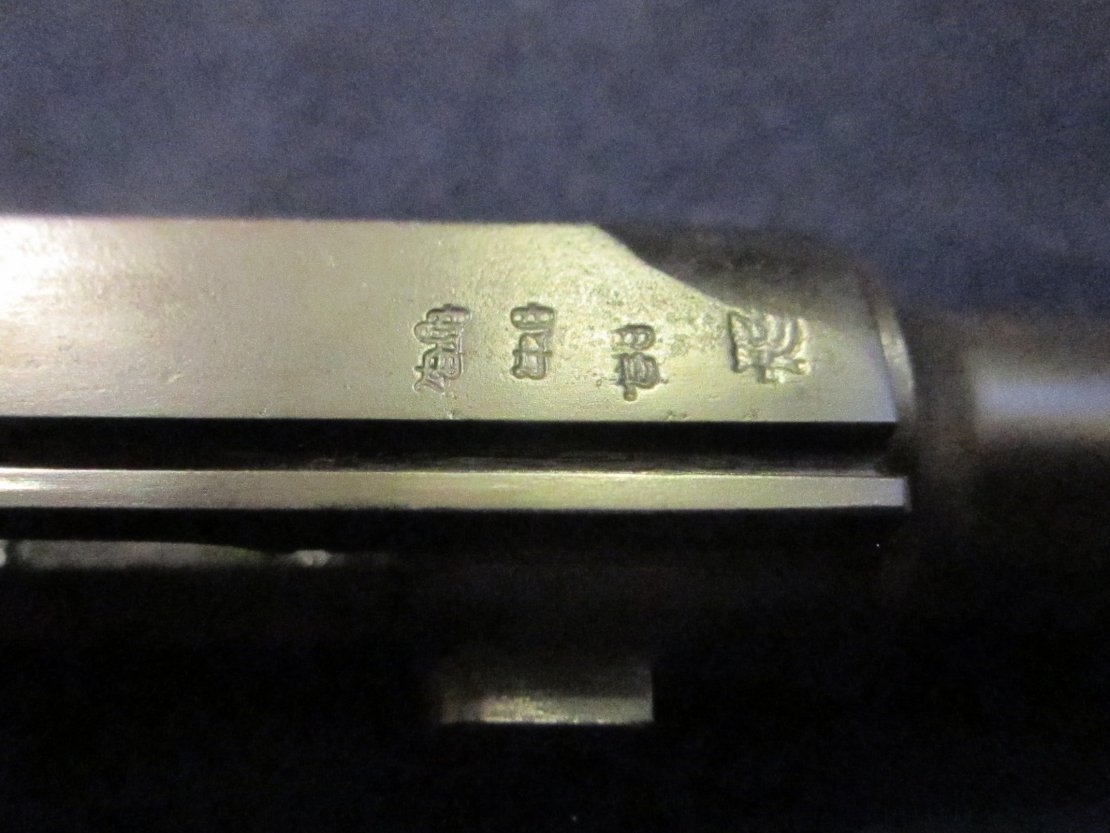

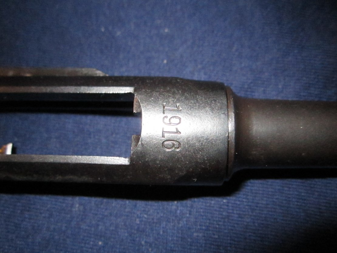

Reading this thread about the 8990i serial number being made around 1921. My question and curiousity now is that I have a luger that has the serial number 8034j. The barrel has the 8034 serial number as does does most of the gun except the toggle and sideplate. The top of the chamber reads "1916". Is that the year this luger was made? The toggle has a S/42 stamp. Im sure this is a russian capture or a pieced together gun. Im thinking RC with the black coating on it, which is horrible.
I was just curious about this serial number with the letter "j" because someone else in another thread commeneted on the letter "j" and the year 1916 as not being many known.
Whats yalls opinions.

Military, contract and commercial S#'s are three different sequences and are not related to each other. The 'j' suffix on your 1917 Erfurt frame is part of a military S# sequence of that year. The 'i' suffix on Joe's Luger, made in 1921, is part of the commercial S# sequence that began in 1900 and ended in 1942.
Mike C.
