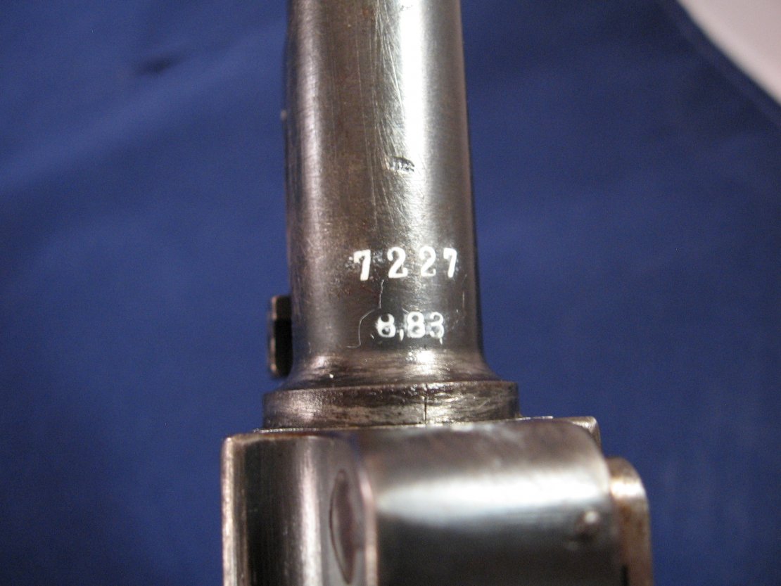

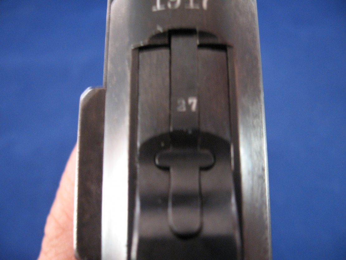

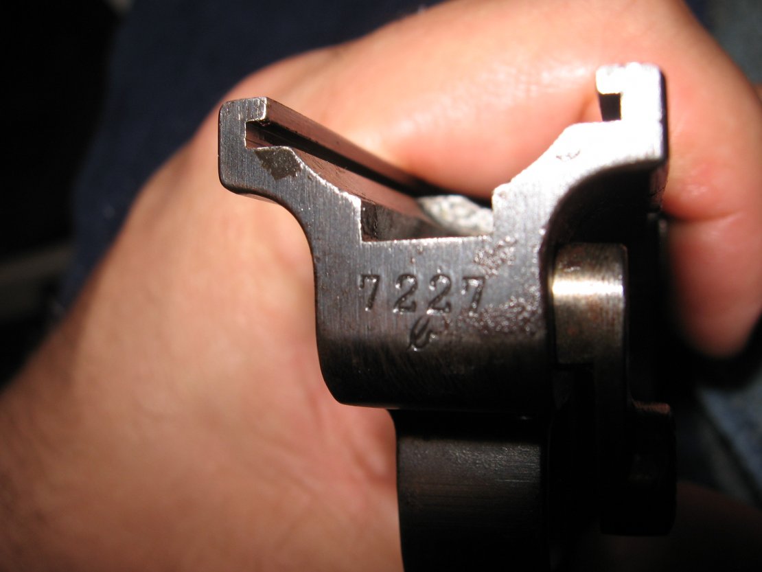

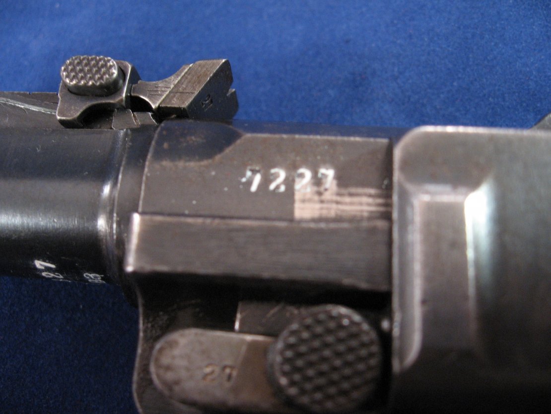

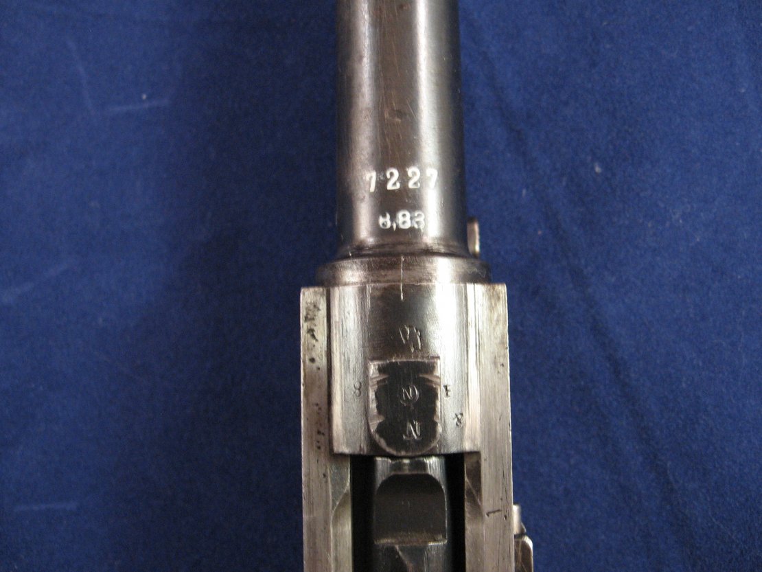

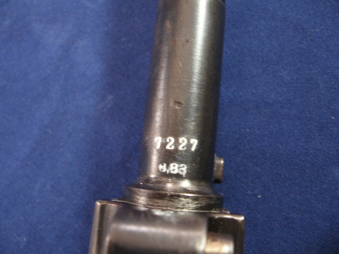

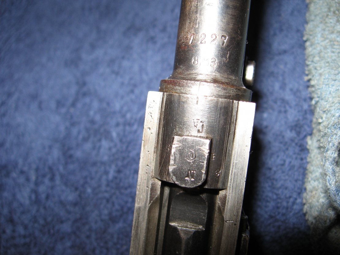

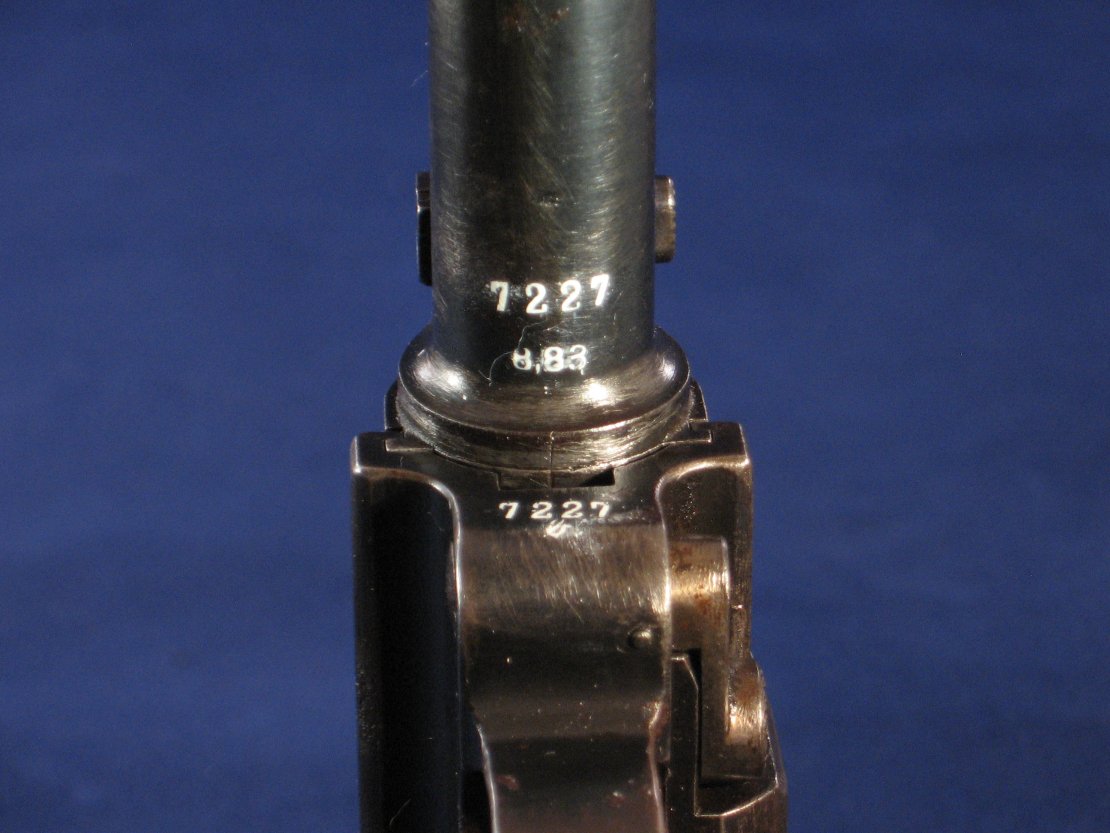

I just acquired a 1917 DWM arty all numbers match except magazine. I was looking at it today and I do have one question.
The frame is serial numbered 7227 b and the barrel is serial numbered 7227 but with no suffix,
Is this something to be alarmed over?

Were there any examples where the barrel wasnt suffixed? The condition of the barell finsish to the gun is consistent. Numbers are of the same font and size.

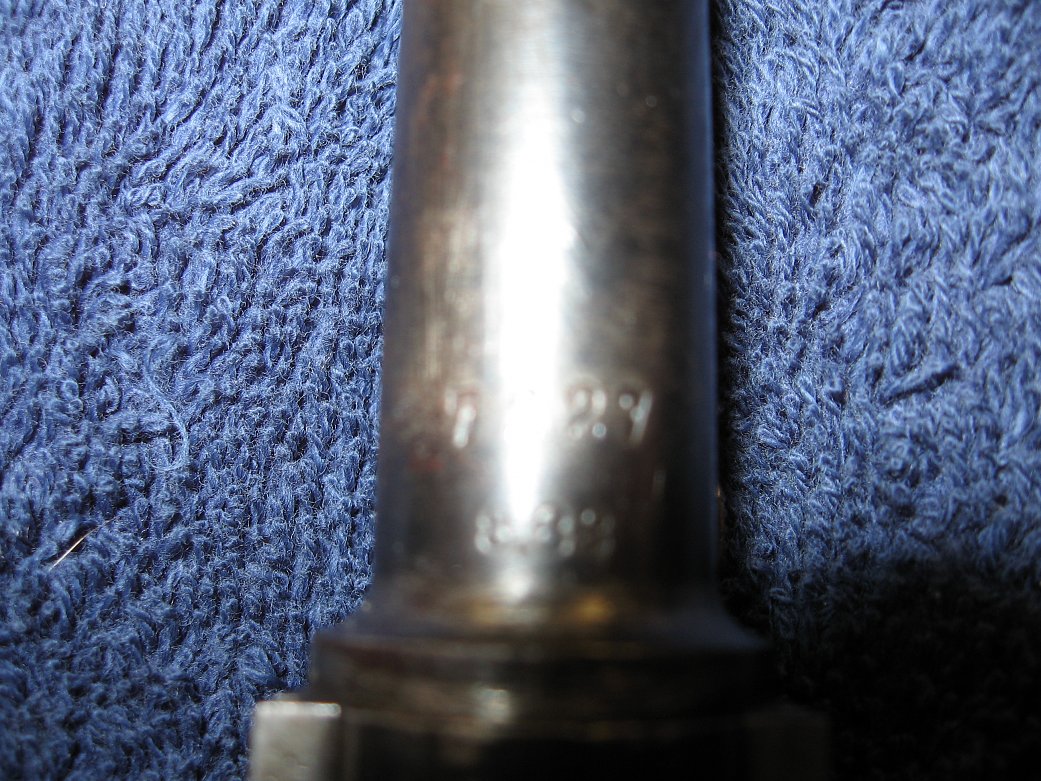

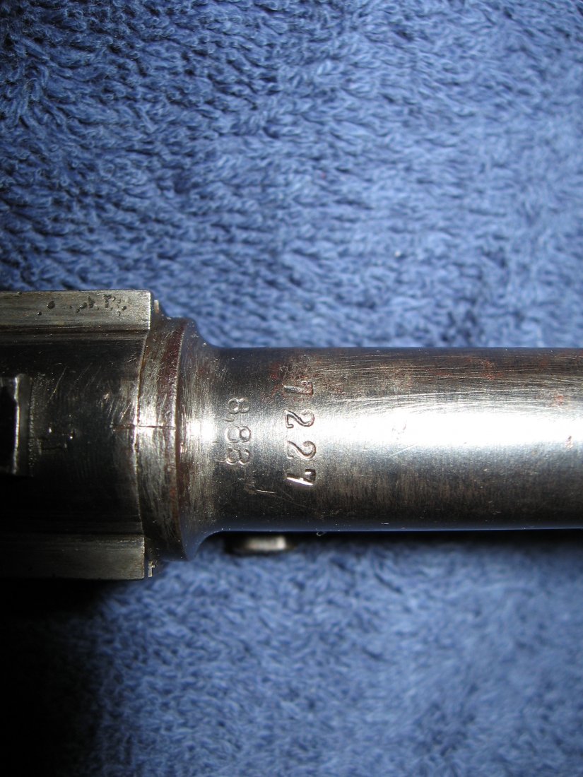

Unread 12-15-2012, 09:59 PM   #8
wayne8661
Posts: 611
Thanks: 15

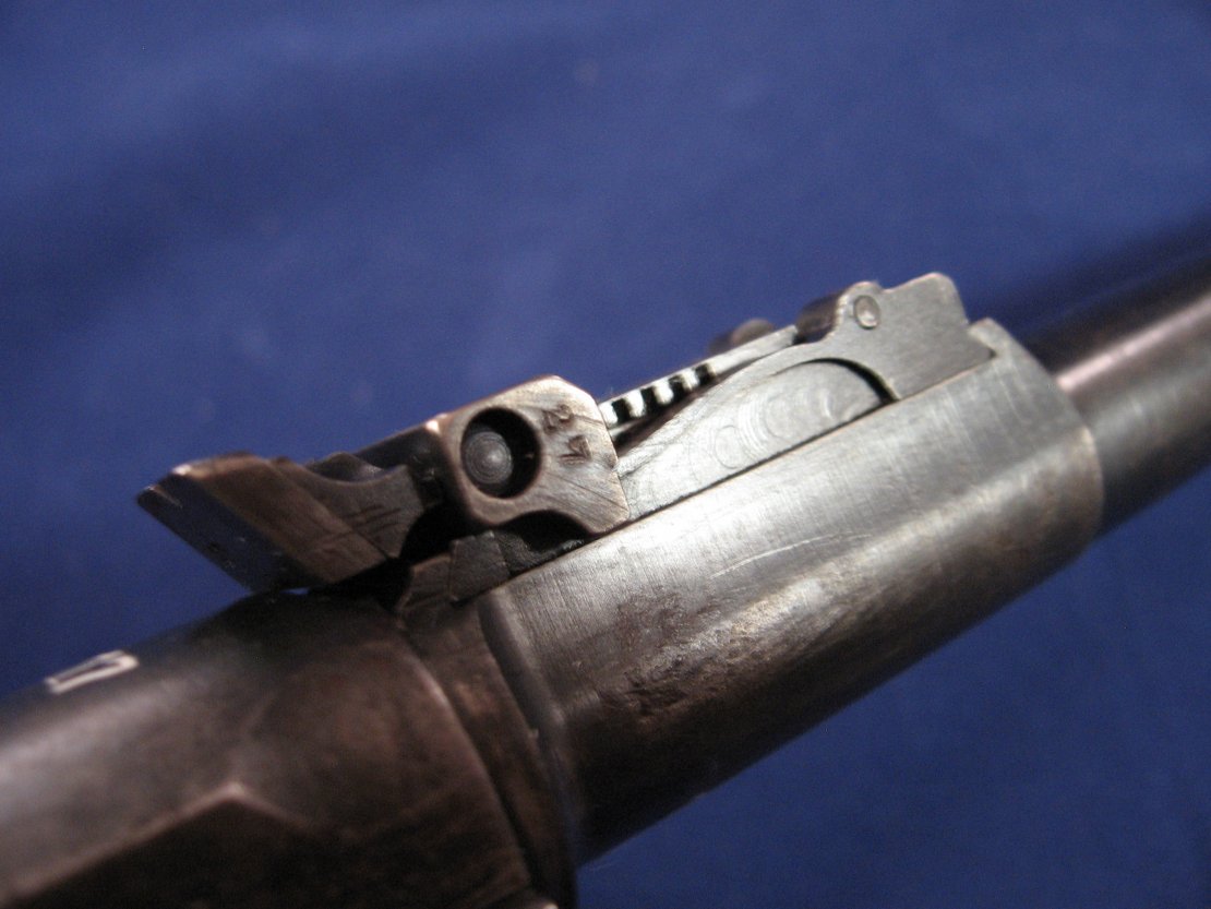

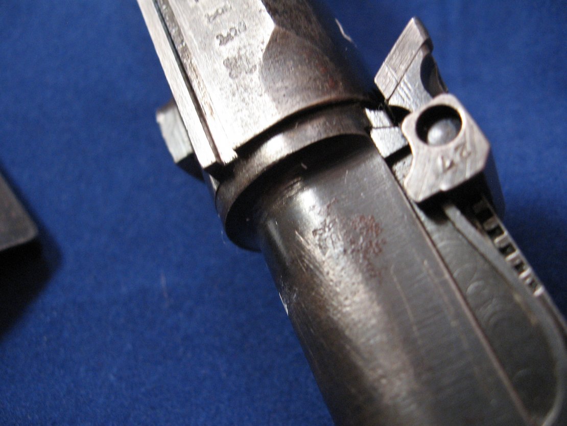

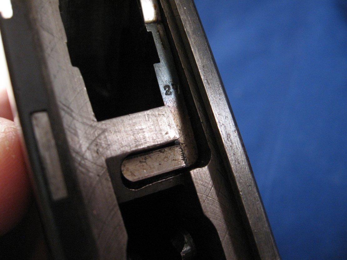

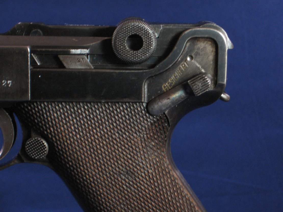

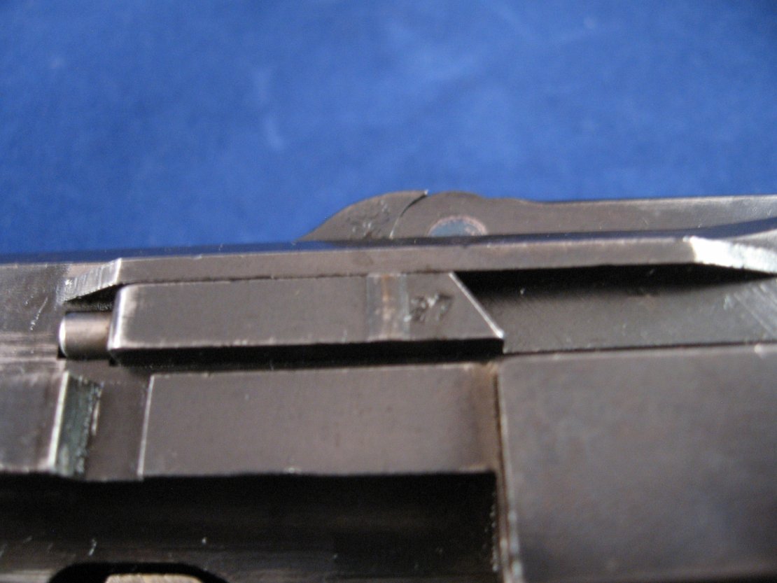

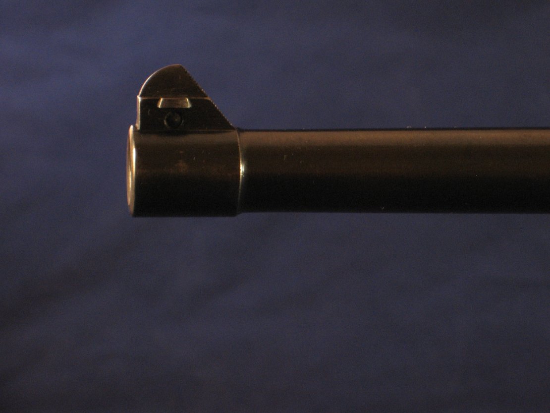

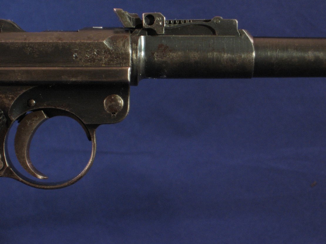

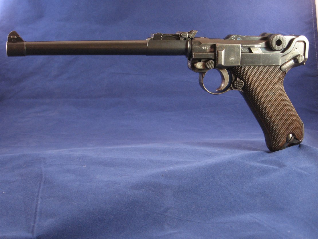

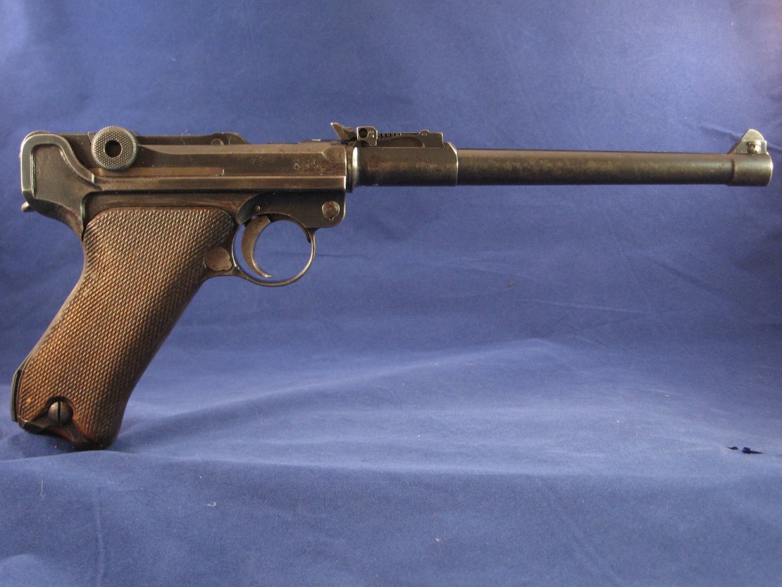

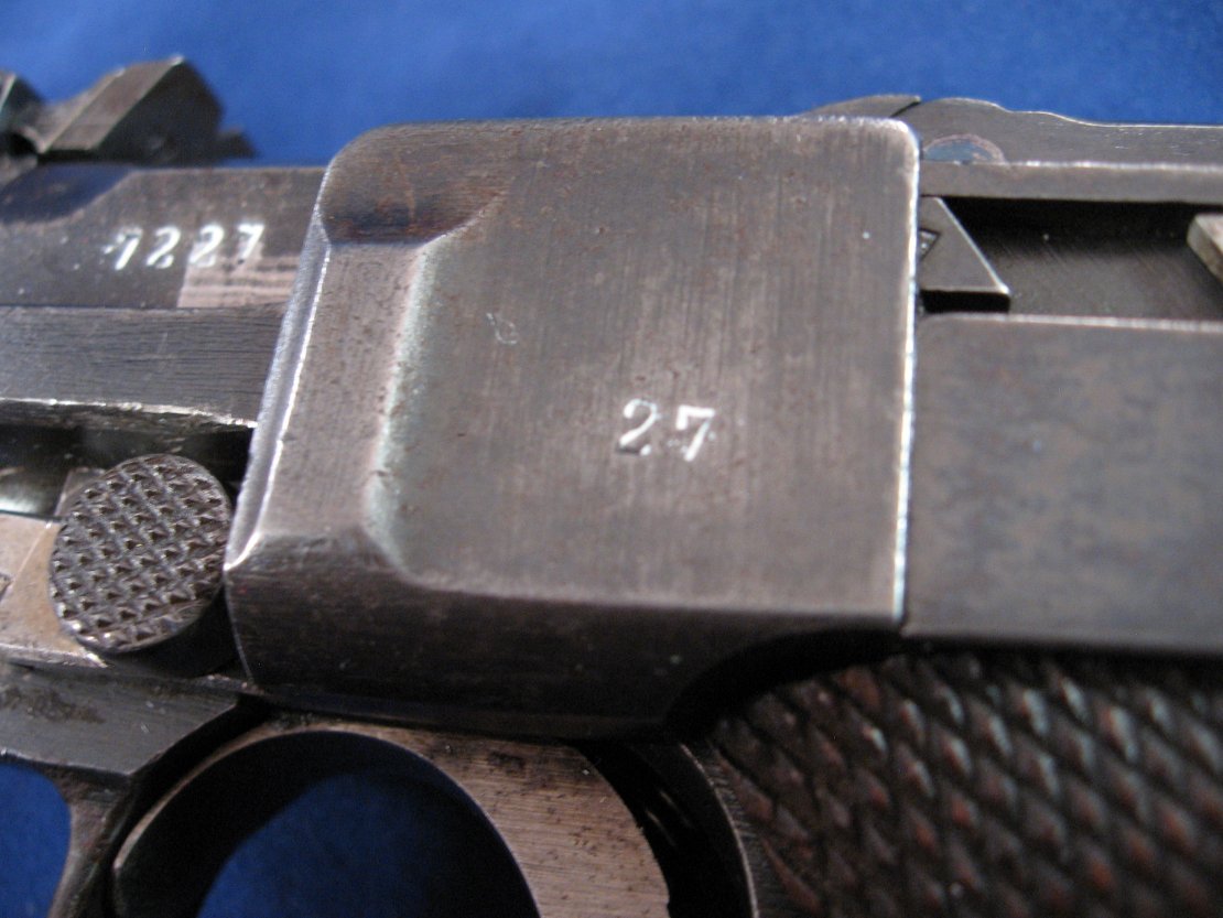

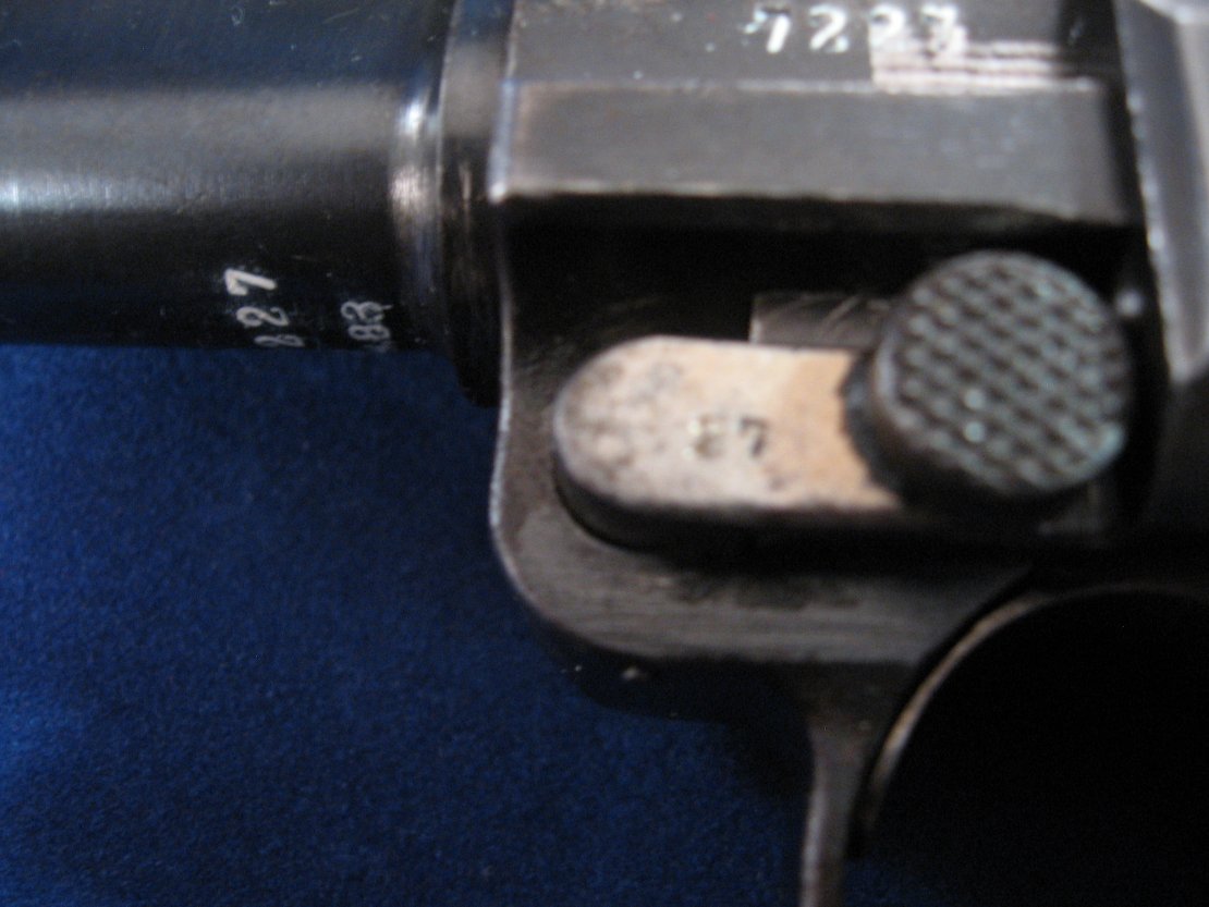

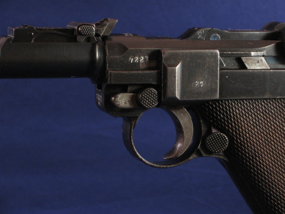

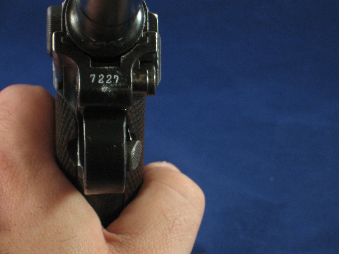

Here are a few pics I love the gun and it looks right to me I just dont get why it doesnt have a suffix on the barrel. More pics to follow

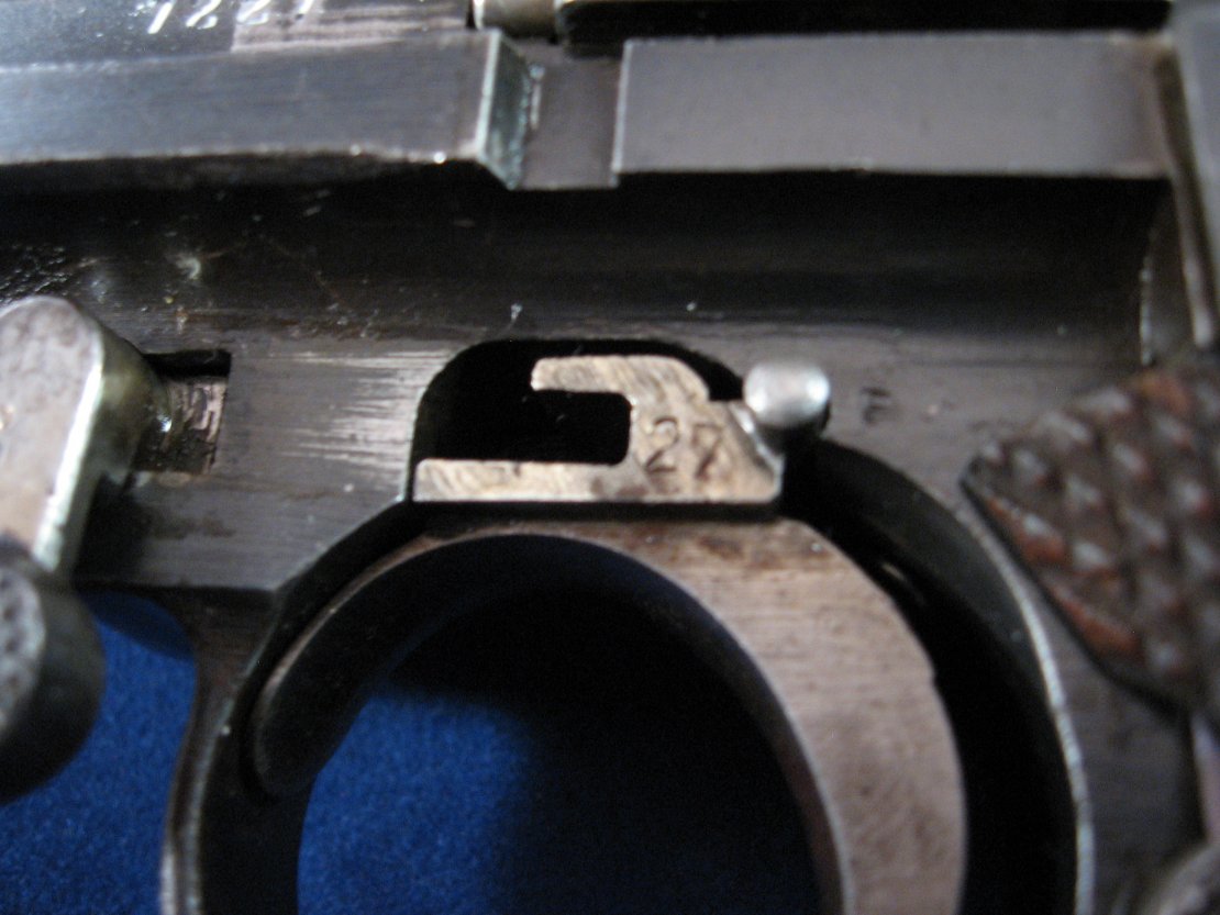

Unread 12-15-2012, 10:04 PM   #10
wayne8661
Posts: 611
Thanks: 15

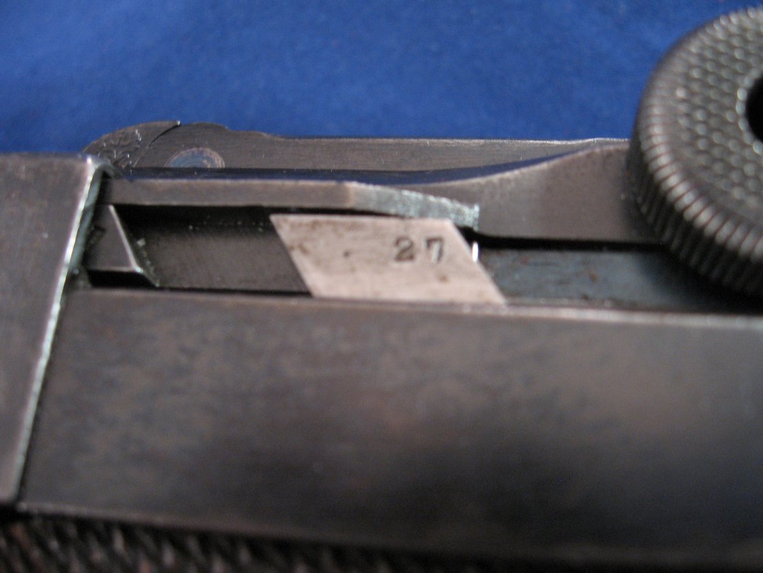

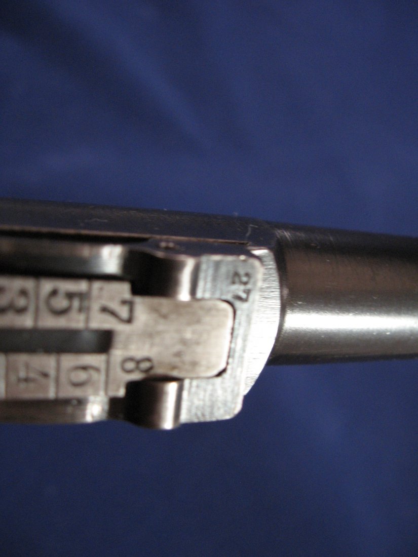

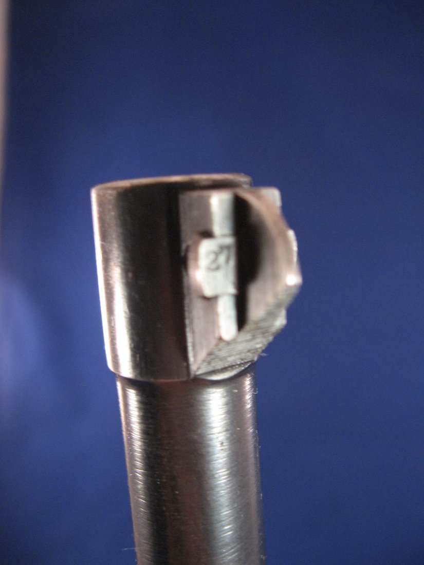

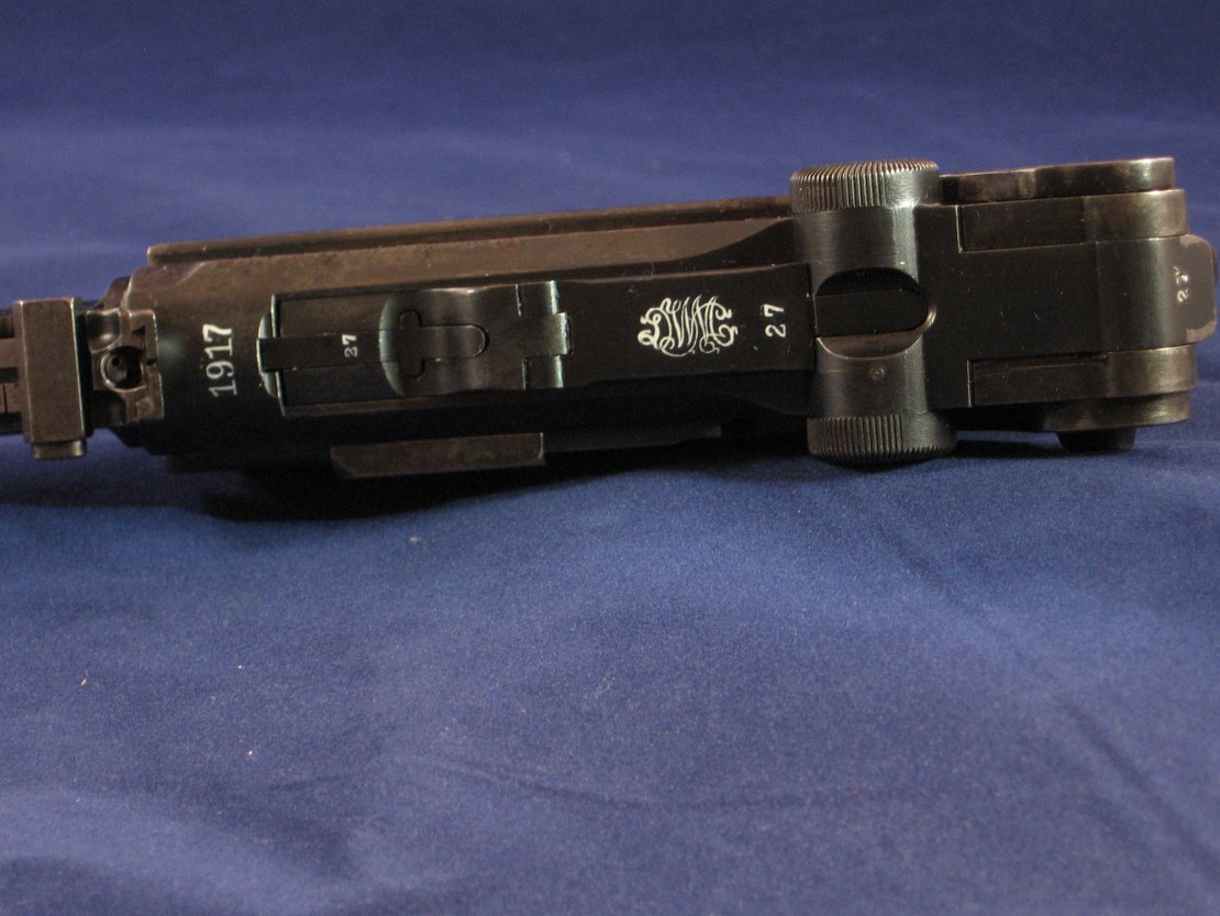

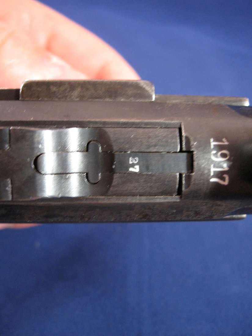

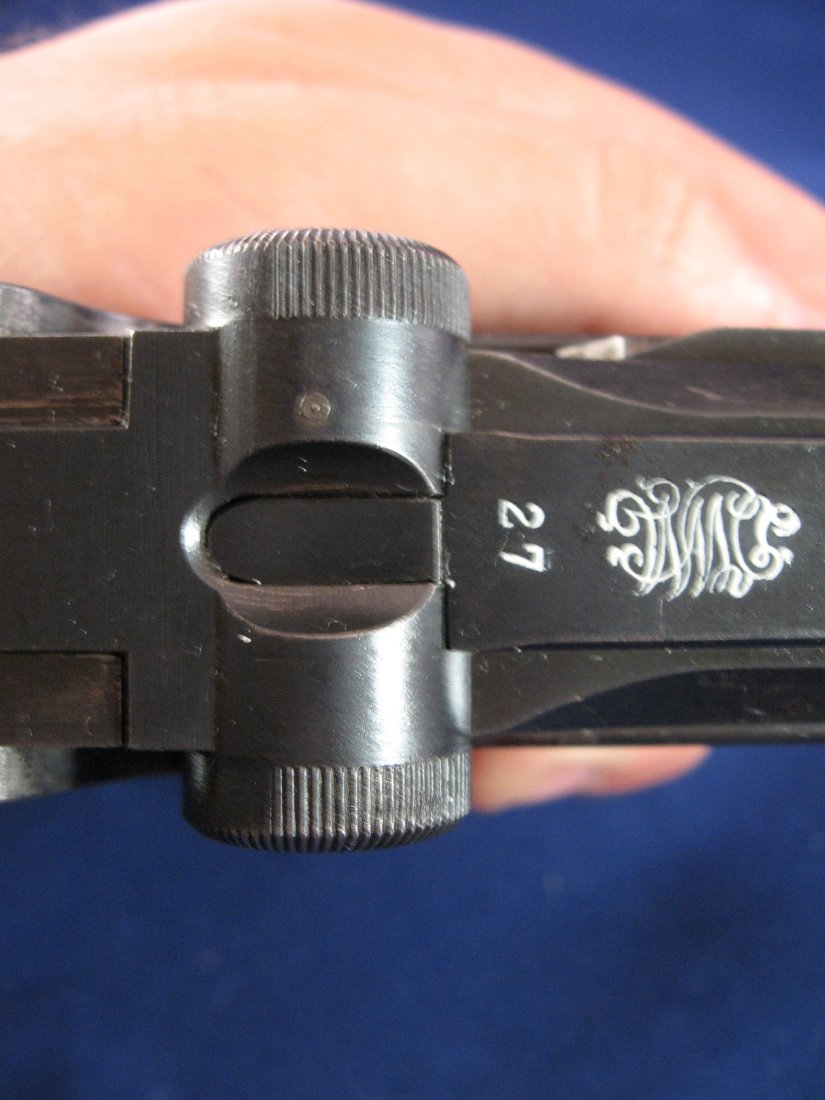

Even More all small parts are numbered 27 Hold open, Firing pin even both of the grips are numbere 27 the gun looks legit to me But why no suffix

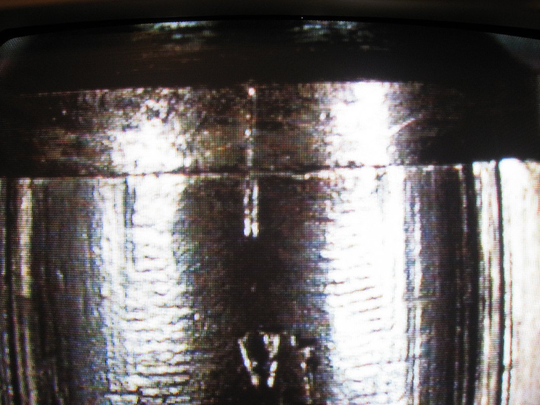

Unread 12-15-2012, 10:44 PM   #12

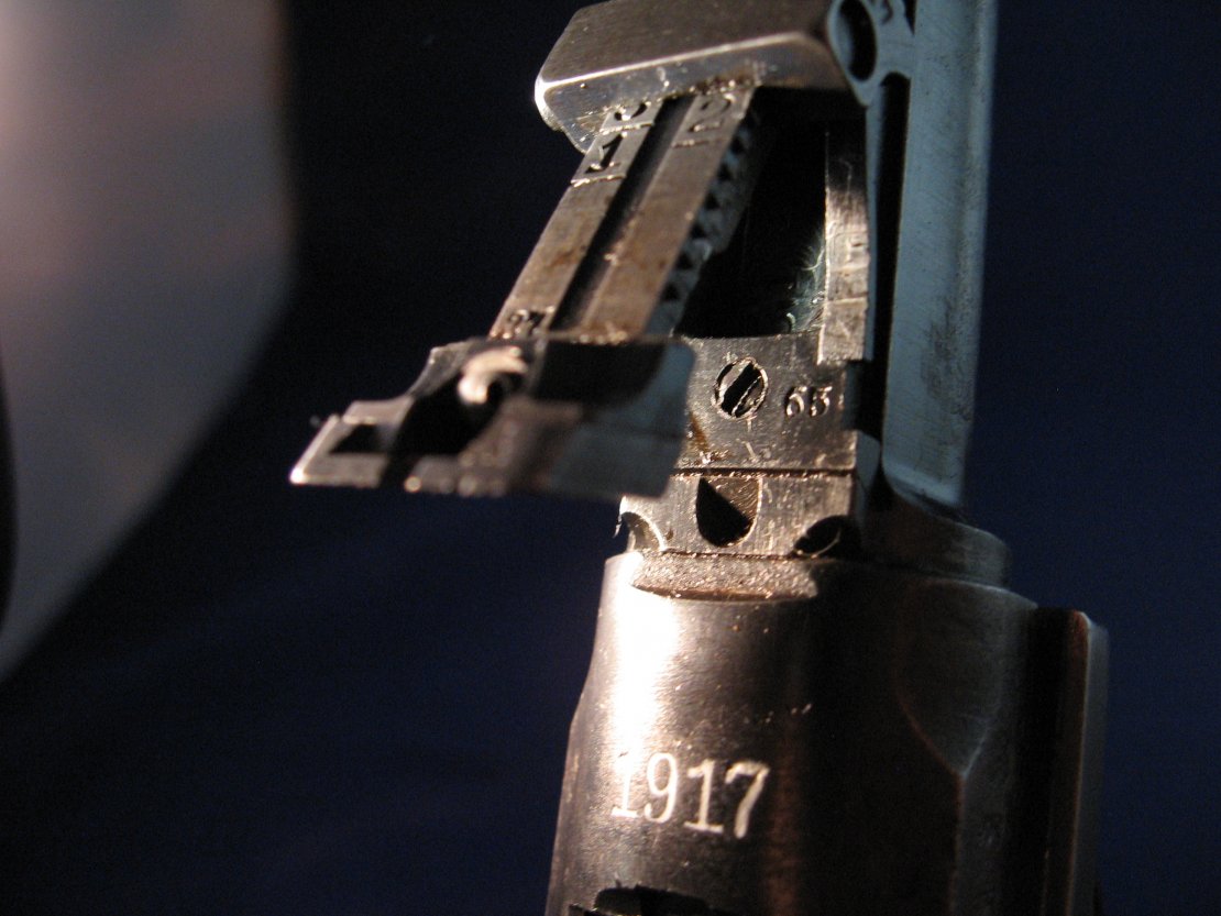

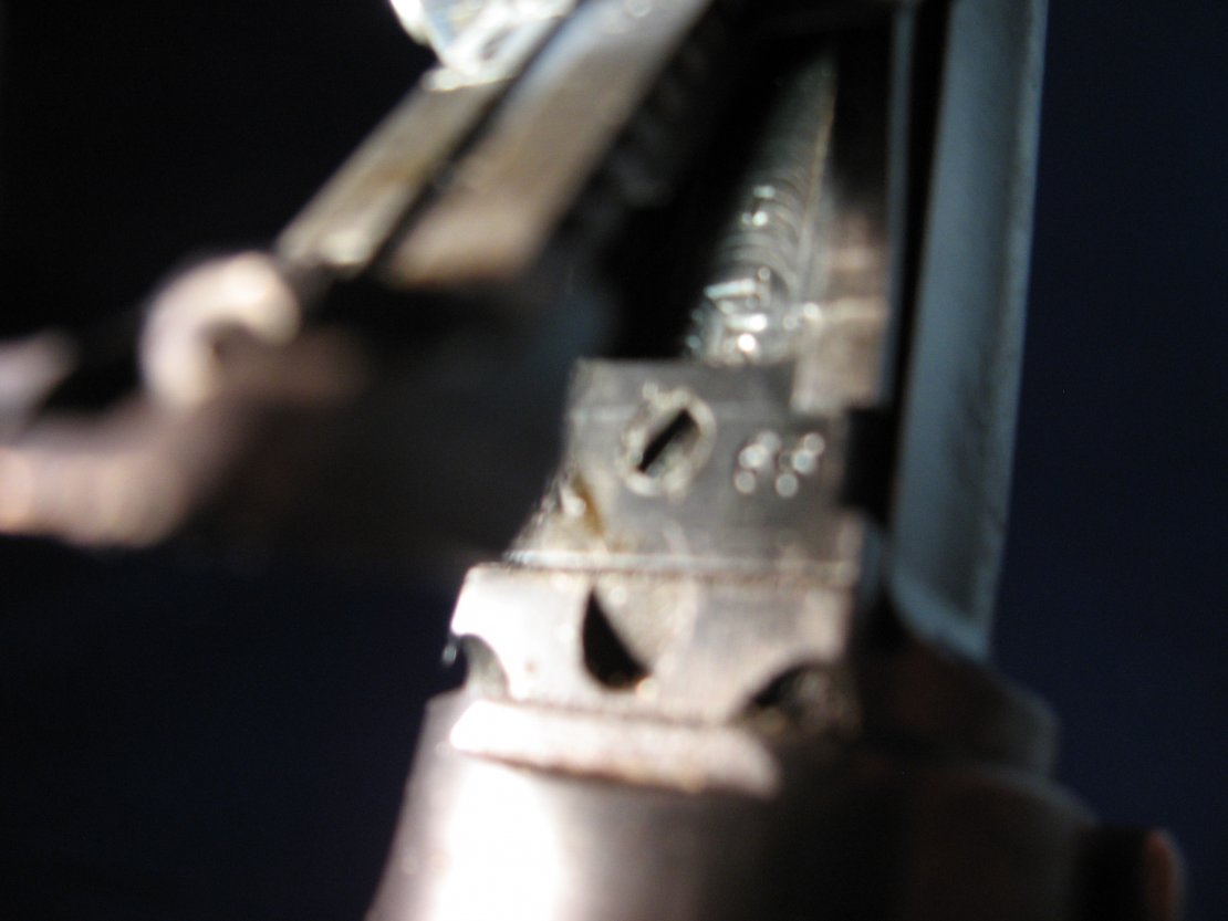

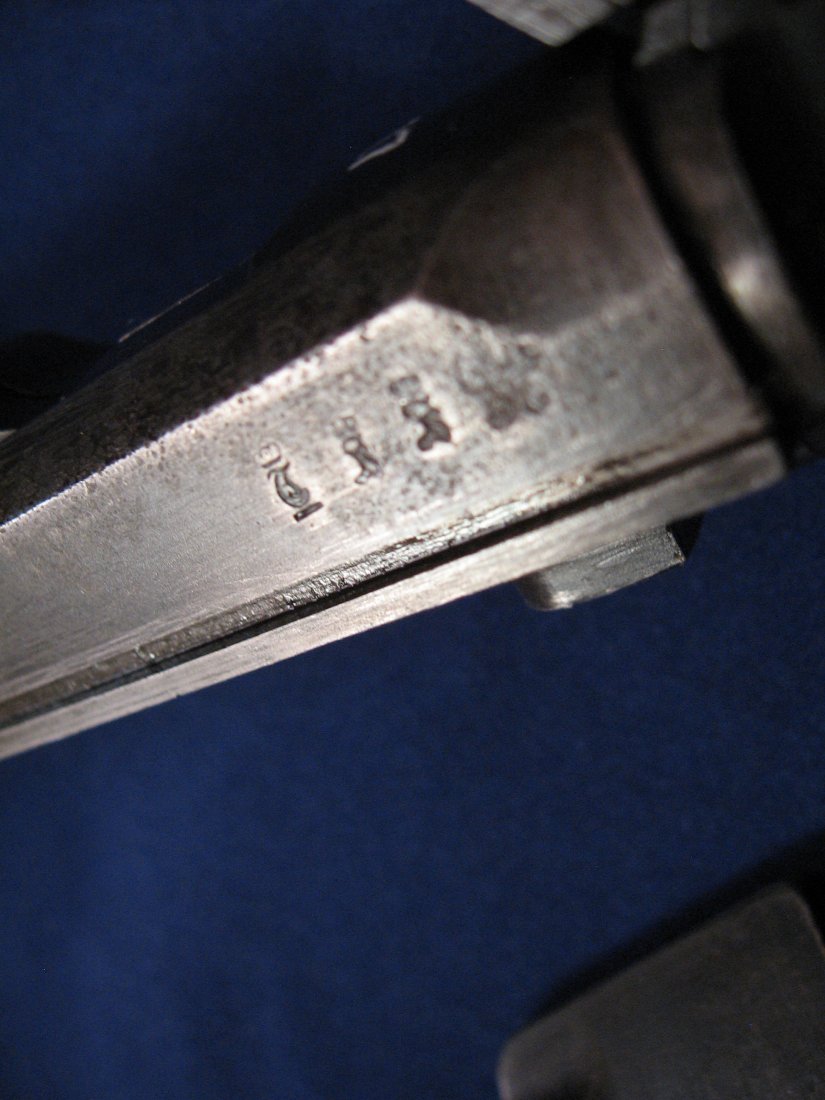

Run the rear sight up as high as you can and, with a strong light, examine the numbers on top of the barrel below the sight mount. Those numbers should include at least two numerals from your serial number. If they are there you are probably alright.
Unread 12-15-2012, 10:48 PM   #13
Odd, but I'm not seeing a fake. An anomaly IMHO.
Unread 12-15-2012, 10:55 PM   #14
wayne8661
Posts: 611
Thanks: 15
Inside the sight it has a 652 on the site frame it says 65
Unread 12-16-2012, 05:07 PM   #15
652 is on the sight base. You need to be looking forward of there into the void at the top of the barrel.
You mean up towards the pin on the tangent sight?

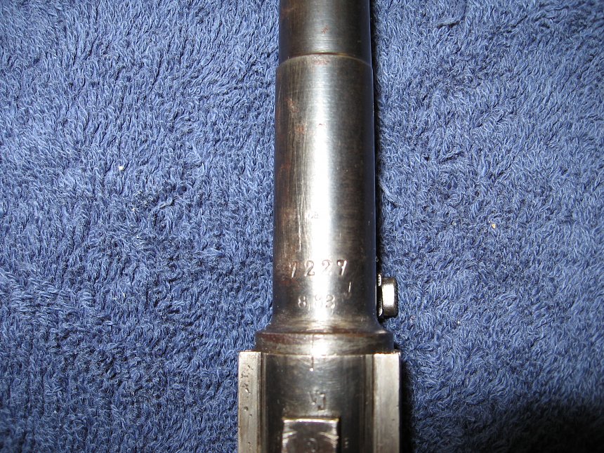

The serial number on the bottom of the barrel has no evidence of being re struck and if someone would go through the trouble to re strike the serial number to the proper size and font why wouldnt they put the suffix on?
Unread 12-16-2012, 11:05 AM   #19
Perhaps because they didn't have the proper 'fractur' font lower case letter stamps...
Harbor Freight/Brownells can't stock everything...'Someone' might have thought it would be better to leave it off rather than strike an obviously false font and have it proved a fake...
...Pure conjecture on my part...
Unread 12-16-2012, 02:10 AM   #20
It would seem like whomever stamped the barrel serial number did not leave enough space for the letter suffix to be added, given that the bore gauge had to be in there as well, so it was omited.
It looks like one of those legitimate anomalies to me.
