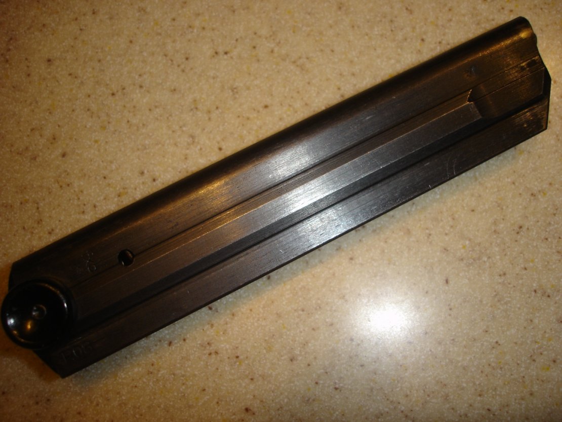

Default I have one 3716 b + 655
Hi Dale
I hva one marked 3716 b + 655, if you want to trade.
Regards Kai
Norway
kpf is offline   Reply With Quote

kpf
Join Date: Oct 2012
Location: Finnøy, Norway
Posts: 75
Thanks: 78
Thanked 36 Times in 10 Posts
Default My mag
Regards Kai
