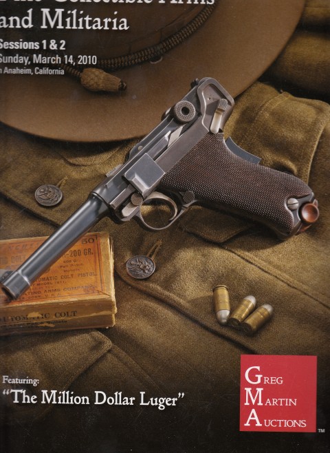

In Central Powers it is discussed at length, and on Jan's forum, there was a huge discussion before the book came out.
Not sure where you felt that the 45 was rebarreled and chambered to 45 / this can easily happen from 7.65mm to 9mm but the 45 requires a bigger gun.
The pictured 45 has a different grip angle than the two surviving 45's.
You can see the Norton at the Shreveport, LA museum. The Aberman I can't remember who has it now, a private collector, but not sure where it went after it was sold and then not sold.
I personally have always believed that if they were making up guns to be used at trial, that 3-5 would have been made; seems logical that 3 would be here in the USA and 1 or 2 left in Germany.
There is much speculation that others exist, but these are generally just wild rumours or modified 9mms.

My knowledge on .45 Luger is limited to the first 3 posts of this topic. Following is wild thinking .
Different angles of the grips could be valid: for test gun, German most likely built and submitted a few samples with minor difference in configuration.... "Each one has plus and minus, and you pick up the one that fits you" type of theory. On GMA catalog, the gun is in super condition and does not look like that it went through a very tough testing process. That could be valid as well.... like a team player in Olympics Games does not have to compete in the actual game as a backup member, he/she could still win a medal by sitting there when the team wins. Even the team loses, he/she still officially joined the Game of year xxxx, as a member of a team. Nothing wrong with that. GMA Luger might be in the similar situation.
