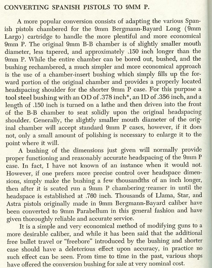

Nonte recommends pressing a .150" long bushing into the chamber to convert to 9mm Parabellum. I have the book & can scan the relevant paragraphs if you desire.

That would be great!! I's absolutely LOVE to make it something I could shoot more often.. I just need to find out which of the gun****hs in ton are any good as the one I used forever is retired.. Anyone know anything about the 'smiths n Spokane?

This is from Nonte's 1974 book 'Pistolsmithing', Stackpole books, publisher.
Footnote -
( * "Or large enough to be a tight press fit in the front of the chamber" )
