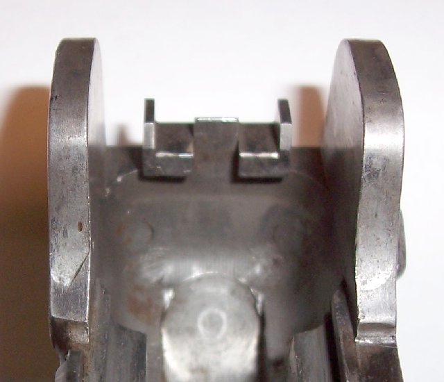

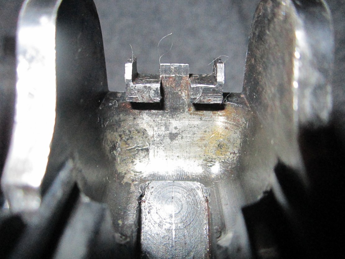

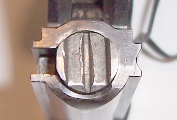

Extracted from the "Broken Parts Survey" thread - My broken firing pin guide and rear of frame where 'duckbill' hits -
Rich,
The head of the firing pin spring guide looks as if it's been hammered. "Fingerprint" by Sasquatch! This pistol is either tested to the max by this, or set up--all ready to break!
I took it down today and took some more pics of any wear areas I could see...Hard to imagine that 7.65 Luger loads could impact the steel this much...But over 100+ years, I suppose it would add up...BTW: The bore is pretty worn...

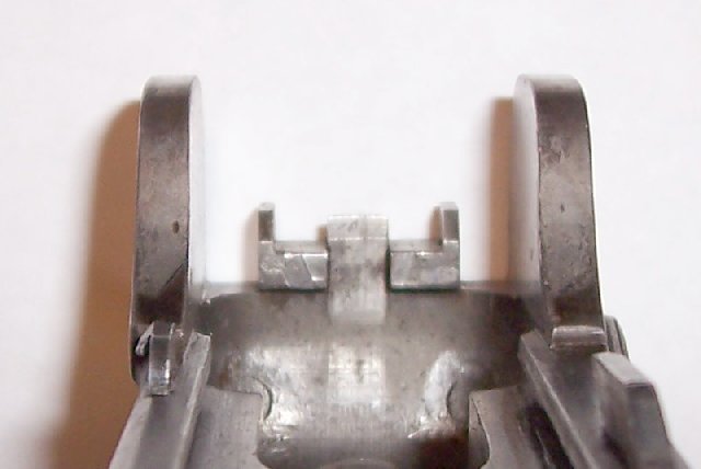

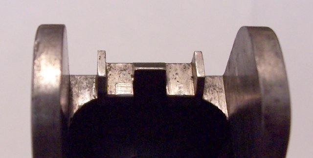

Nice pics Rich, and you've shown the toggle ramps--an area I forgot for my list back at the other thread. What's up with the sharp diagonal edge to the wear at the bottom of ramp on left in last pic? Also, the ramp we see on the right appears to have been struck by a surface that was not square and parallel to it, otherwise, the wear marks' ends would be straight across. Can't quite tell from the pics if the edges of the ramps are mushroomed out, what do parallel jaw calipers or a mic say? Now I'm curious to see the knobs of the toggle, where they encounter the ramps while cycling.
Unread 12-25-2012, 03:38 PM   #3

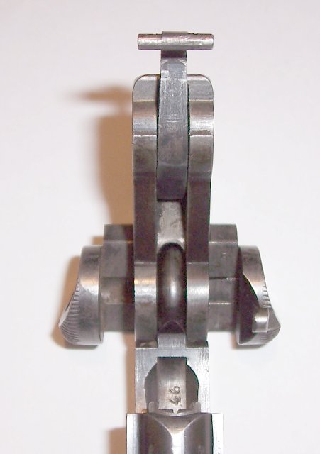

The toggle does not hit the ramp at the bottom; it hits 1/8" up the ramp...The wear mark isn't straight across because the toggle knob edges are not parallel; the knobs are tapered...Like a truncated triangle (as seen from the top)...It tapers .004" over a .045" surface (the part of the toggle that hits the ramp)...There's no visible mushrooming, but my verniers tell me the ramp is .004"/.005" thicker where the impact marks are than below them, where there has been no impact...
Edit: The duckbill of the rear toggle does not show any undue wear or 'spread'...

OK, the taper of the toggles explains the way the marks are. But, looking at the last pic, what is giving the appearance of a triangular area of surface which looks undisturbed, it points up into the area of the ramp (pic left) that would be expected to be worn in a mirror image of the wear on its counterpart (pic right)--as if there is a chunk missing on the toggle knob that has hit it. Or is it a photographic artifact?
Unread 12-25-2012, 05:35 PM   #5
It's different because that knob has the 'toggle lock' in it, and there is a milled bevel on the bottom of the knob where it hits that ramp.

Is it common for the firing pin retainer to hit the back of the frame. Looking at your above pictures it looks like mine and yours has the same looking mark where it hits the frame. Is this a major problem?
Unread 12-25-2012, 08:02 PM   #8
Posts: 3,403
Thanks: 7,572
Yup that's the story, the wear pattern makes sense now. I'm not sure, since I've never seen a 1900 in person, that I've ever seen one's toggle train from this angle, much less noticed this aspect to the wear patterns this design configuration results in.
This leaves us, still, with the caveat to change over to fresh springs. Very graphic, and sometimes heartbreaking, evidence of what happens when the action is forcefully over-extended...
Originally Posted by skeeter4206 View Post
Is it common for the firing pin retainer to hit the back of the frame. Looking at your above pictures it looks like mine and yours has the same looking mark where it hits the frame. Is this a major problem?]
Yes, but likely cumulative. It takes repeated forceful blows to work harden a piece of steel, but the more forceful and frequent the trauma, the faster metal fatigue will develop if it continues--to the point of becoming so hard and brittle that crystallization occurs and one last whack causes it to shatter and fail. Check out the texture of the break on the spring guide above; it's not torn, but shattered/snapped. I'm not knowledgeable of how to assess the damage/progression if it is noticed before failure of a part. I consider a crack a failure, and a break a catastrophic failure, even though both are catastrophic, as far as collectors are concerned. I think up to a certain point, further service will be OK, but after that point, continued use would be dangerous to the part, and perhaps to the user. But I don't know how that could be established. Maybe X-ray?

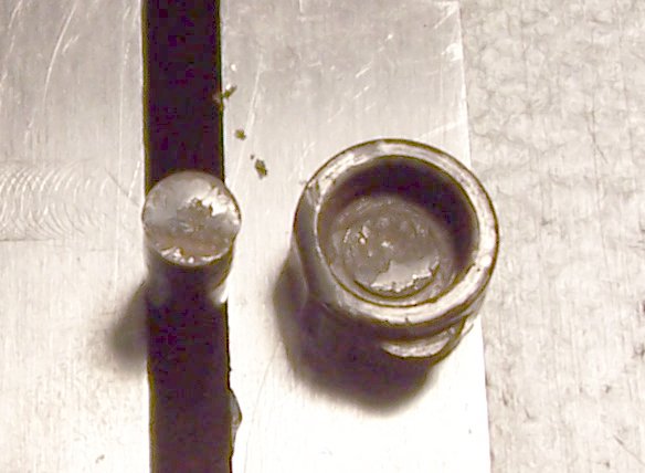

The pieces of my guide are somewhat mystifying...I don't see how it could work-harden...It doesn't flex, or twist, or bend...It travels in a straight line and [theoretically] doesn't even move (in relation to the parts around it)...
My pieces do show some crystallization, but the loose piece was reciprocating back & forth and the end & cavity have been peened by that motion so it's hard to tell what happened...
Hopefully, someone more familiar with these models can add their comments...
Pic attached...

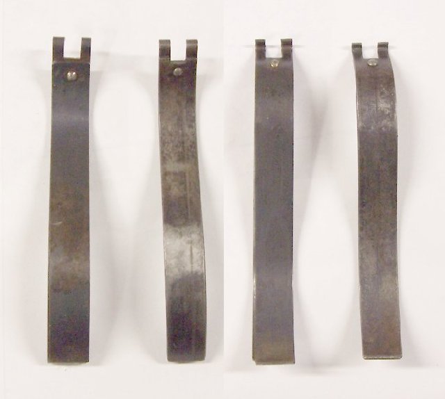

On the mainspring: There is a guy on eBay who advertises NOS flat mainsprings -
http://www.ebay.com/itm/EARLY-GERMAN...-/160944562499
I bought one a couple months back, when I thought mine was broken (it's not), and it looks new, just some very slight rust freckles...Doesn't look home made, and doesn't look like it was made lately either...It looks original...
I was going to keep it as a spare, but maybe I'll put it in...Just in case I decide to shoot it...
He seems to have quite a few of these...They're on eBay almost every month...
I did ask Wolf if they made the flat mainsprings...they don't...
I also ordered some 1095 spring stock to attempt making one myself...For emergencies...But the Luger flat mainspring is a weird gauge; not Metric and not Yankee either...

I just looked it up, and work hardening occurs with the molecular rearrangement of the lattice in the material. These 'Dislocations" add up until the point of crystallization. I included mechanical pounding (intermittent compressive force) in the list of ways work hardening is induced, the others being torsion and tension, as you mentioned, all of which forces cause molecular dislocations. Work hardening is done on other materials such as copper and aluminum, in their transformations into sheets, wire, etc, which are not able to be hardened by heat treat, as steel is.

To me it looks like a fatigue type failure due to the firing pin retainer striking the rear of the frame repeated times.

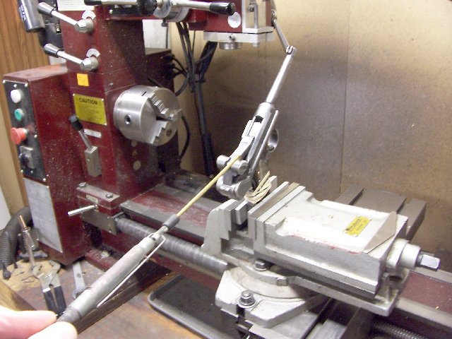

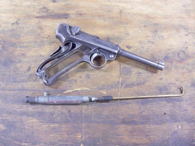

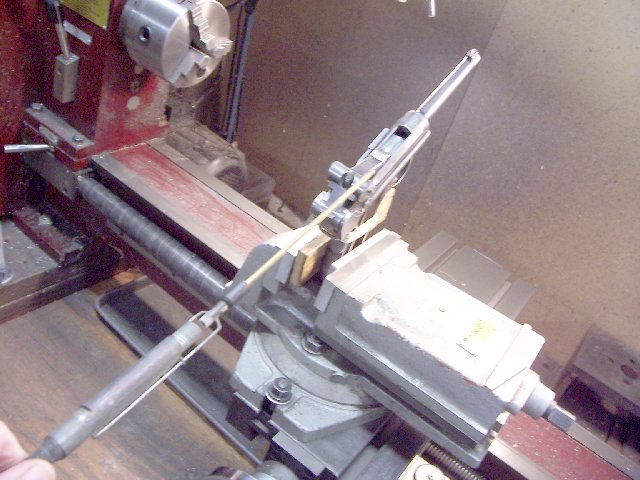

I have a tool for measuring spring tension...If I can figure out how to attach it to the toggle in such a way that it will show an accurate read, I'll try it with the old [present] mainspring vs the NOS mainspring, both installed...
Edit: Hmmmm...Not as difficult as I thought...[pic below]...I can hook it on the toggle and pull to full reach...
I get a repeatable 10 pound reading with the present mainspring...Perhaps not the most accurate way to do it, but for comparative tests, it should show any difference...I realize that there is no way to know if this is the original mainspring or a recent (or an old) replacement...It may have been added after all the pounding was done to the action...
Edit: NOS mainspring installed measures 9 pounds on my spring tension gauge, repeatable...
So either I have a good mainspring already installed, or someone has been firing either hot loads or very many of them...

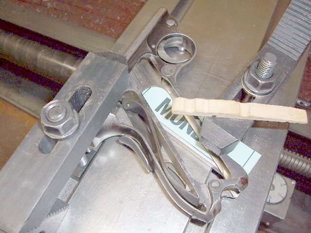

Pic 1 - Luger + spring gauge
Pic 2 - Measuring installed/old mainspring
Pic 3 - Installing new/NOS mainspring
Pic 4 - Mainsprings = new, old front; new, old rear
Pic 5 - Measuring new/NOS mainspring

I would welcome anyone with a 1900/1902 to 'measure' their toggle tension so that I could compare it to mine...
Easy enough to do: Take a 9, 10, or 11 pound weight, tie a piece of string to it, tie the other end around the toggle of an unloaded, cocked, un-magazined 1900 and hold it by the barrel [barrel pointing up] with the weight hanging down and see if it racks the toggle back to the stop...

I'm curious about that contraption you made up. I'm thinking some kind of fish scale would work. I think I would like to know what mine has. When torn apart, the leaf spring in it doesnt seem to have much tension at all. But, I never knew if it was meant to be that way. I know it does not have anything close to the one I have with a coil type mainspring.
Give me a closeup pic of how you have it hooked into the toggle. I would hate to damage it while doing this.

The hook/grabber thingie Rich made is brass, so other than imparting a little bit of its material to the surface of the toggle, it can't do any damage. One can gently remove the smeared on brass with oiled 0000 steel wool.
I think the angle of pulling the measuring device relative to the pistol frame may be important for trading data back and forth. With the same pistol, same angle, but different springs, you'd get a data set which would enable you to compare the different springs. If we standardize the angle at which the pistol is mounted in addition to the angle relative pulling is done, then I think we can swap info. This is a vector force, and although I haven't worked it out specifically, I believe the angularity must be duplicated to bring individual pistols' measurements into line with the rest.

This thing is an electricians tool for measuring spring tension of brushes on motor armatures...I had it from my old job and use it to set trigger 'pull weight' on .45 autos mostly...
I don't know what a fish scale even looks like...
Go back to the first pic; the gauge has a square hook that I hook into the slot/cavity of the toggle knob...The hook is 5/32" brass rod...
