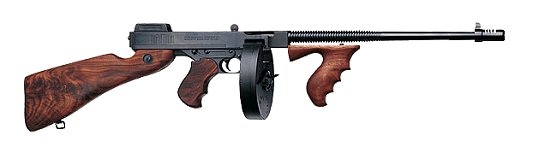

I ordered a factory build Deluxe steel model with a 30 rnd. pre-ban stick mag for NY State, and it arrived day before yesterday. A 10-rnd drum mag should arrive today, according to USPS tracking.
It looks great, weighs a TON, overall nice looking work and finish. However, I have a few issues with it.
First, I noticed that the receiver shucks around in the frame a bit; when the rifle is shaken (not stirred) it is audible. This might be better than one that is so tight it won't come apart (and I believe some motion of the arrangement is expected and acceptable) but I'm going to ask Kahr about it to see if what I have is within parameters of acceptability.
Second, the rear grip refuses to mount any other way than to expose the sharp 90 degree corner of the frame that should fit resulting in both surfaces near flush, in the notch in the top of the grip.
Third, I tried the first round in it yesterday. I succumbed to the temptation to touch off a second before I gave it its first break-in cleaning, and nothing! The second round chambered OK,and the action seemed to return fully to battery, but the trigger did not set--no click.
Forgive the stock photo, please; I'll do a run of glamor pics and post when I have the chance. work just became extremely busy, so won't promise when, just asap.

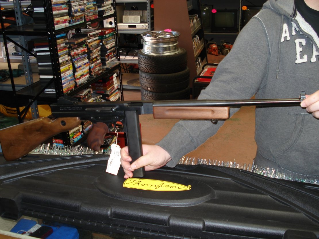

the one pictured is an auto ord/kahr not the same model as the one you have purchased , but i would think trigger frame and upper reciever are. I traded for it whiile working at one of the local pawn shops and it looked to be fired very little. I sold it to someone i knew and he brought it back with some feeding and failure to fire problems . once i test fired it and did some fitting on it and tweaked a few parts he has had no other problems with it, this one had a rather tight upper to lower fit. not sure when it was made ,but at least a year ago. this one seemed to be built rather well, it sure did not rattle.
David, Sounds like you have bigger problems than a rattle...
