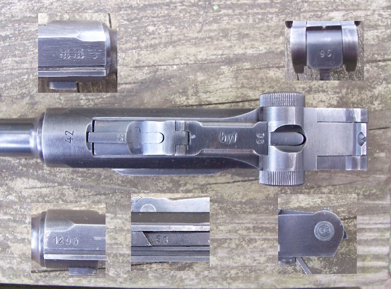

I bought this receiver/toggle train from a respected (and feared) forum member a year or so ago, intending to mount a 4 3/4" 9mm Tikkakoski barrel on it...I finally got around to it Sunday...Barrel is all mounted and timed and headspaced...
...But as I was doing this, I was reminded of some of the discussion surrounding friendlyfred's Spandau Luger toggle...
Look at these chamfers/bevels [whatever] on this byf toggle...Have you ever seen such extended chamfers??? The toggle looks positively skinny...
And the bevels/chamfers are rounded, not a 45º bevel/chamfer...
It doesn't look altered...
...Just...weird...
Comments???

I'm looking at the Blueprint CD, the pic/print of Das Vordergelenk, and while there is a vague curve where this bevel/chamfer is, there are *no* dimensions...
The Infanterie-Konstruktionsbureau does not give a spec for this??? The individual manufacturers were allowed to come up with a method/dimensions by themselves???
And why would Mauser, in the last year of Luger production, put this radical a bevel/chamfer on the middle toggle??? Some toggles shown in this forum (but not byf 42's) have almost flat middle toggles...
We really need that time machine...I need to stop by Ludwig Loewe's and pick up a C93...

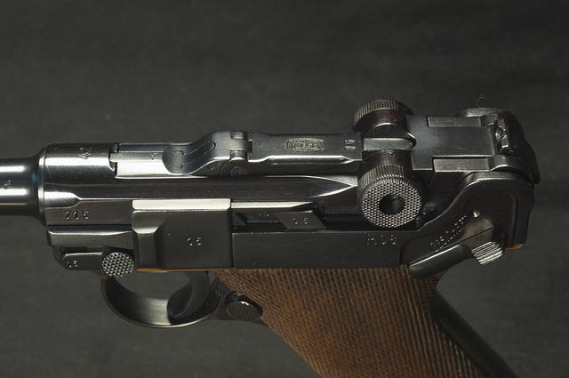

Rich, my "42" date military proofed Banner Mauser has a similar toggle bevel:
Unread 09-25-2012, 08:27 PM   #6
G.T.
Location: Chandler Arizona
Posts: 3,541
Thanks: 1,342
Default banner...
WoW!!!! That's a beautiful unit!!.... It really has a beauty all it's own... my cut of meat, so to speak...I'd have to eat a lot of canned spam to afford/get to that point... .... But, I love the late Mausers all the same... best to all, til...lat'r...GT
Unread 09-25-2012, 08:38 PM   #7
Marc, both your banner Mauser 42 and my byf Mauser 42 have the same bevel/chamfer...Why do they have different toggle markings??? By 1942, there wasn't much sense in trying to disguise manufacturers...Why bother putting byf on toggles???
For that matter, why bother with a banner???

Seeing the deep rounded bevel on your "42" byf tends to confirm the timeframe my Mauser banner toggle was made. Thank you!!!
