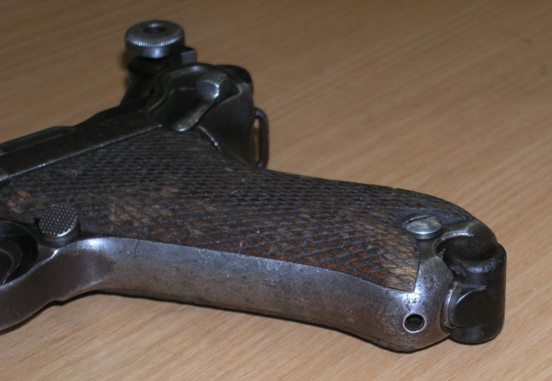

Was looking to pick up a 1906 with safety grip, etc - I knew the luger was worn. The seller just sent me this pic. Is there anyone that can fill this in so rust blue will cover just right? I plan on refinishing the luger.

what interest me is the hole in the front grip at the bottom.
Unread 11-05-2012, 08:08 PM   #3
I would guess some kind of home made 'shoulder stock' / with the hole being a base?
Unread 11-05-2012, 09:02 PM   #4
The hole appears to have a set screw threaded inside, so its anybody's guess what it was for.

The grips have a Dutch Vickers type checkering. May we see pictures of the top? The hole is beyond me. What does the bore look like? If the rest of the gun looks as bad as it appears in the picture why restore it? Bill

It looks like a job for our own Thor. Shoot it past him for an opinion on filling and re-bluing. And that hole certainly has me stumped. I thought of a loop lanyard ring, but the filler set screw sort of shoots that idea. Unless it was added just to fill the hole.
Unread 11-05-2012, 10:00 PM   #7
Could it be so worn inside that the magazine catch isn't working, so someone tapped in a set screw to hold the magazine in place?

I agree with Bill about the grips. If this is a Dutch Luger, you may be best served to leave it alone. Most of these are found in pretty rough shape. We need more information on the gun before we can give you sound advice. Additional photos from all angles would ge helpful.

Seriously, anyone skilled at TIG welding can fill that hole, just make sure they use carbon steel wire and leave a raised bead over the area ...you can file close to flush, then finish with emery cloth...after rust bluing, it should be unnoticeable
Unread 11-06-2012, 10:56 AM   #10
Take the grips off carefully and see what that hole looks like from the other side. Does it go all the way through?

Just kidding! ...though I wondered if it might explain the tapped hole in the grip strap of MY 1906 AE! Well, really, I don't see any purpose for your hole, beyond its being the evidence of a retro-fitted stock of some sort. I plan to TIG up the hole in mine, though I'll document the existing situation with pics, and save the knurled thumbscrew doo-hickey that was screwed into it, then spot-refinish. Mine has already been refinished, so doing this won't affect its collectability.

Mark..Sorry I just couldn't resist. God and the guy who drilled the hole are the only ones who know what it might be for. It's certainly not kosher in any way. Like a ground off stock lug..it just has to be restored to what it's supposed to be. Yes..keep us posted on it's restoration. Good Luck!
